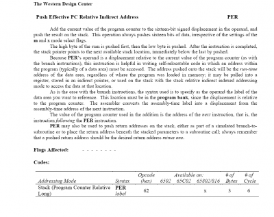

"Jamaica Mon" -- is that something for the 65816? The '816 has an instruction called PER. Maybe the author of the code is trying to do something similar...? I admit I'm guessing, but maybe the suggestion will be helpful. I don't understand what the >>> is supposed to do. It's not a comment delimiter, is it??
>>> per,HEXEVAL
