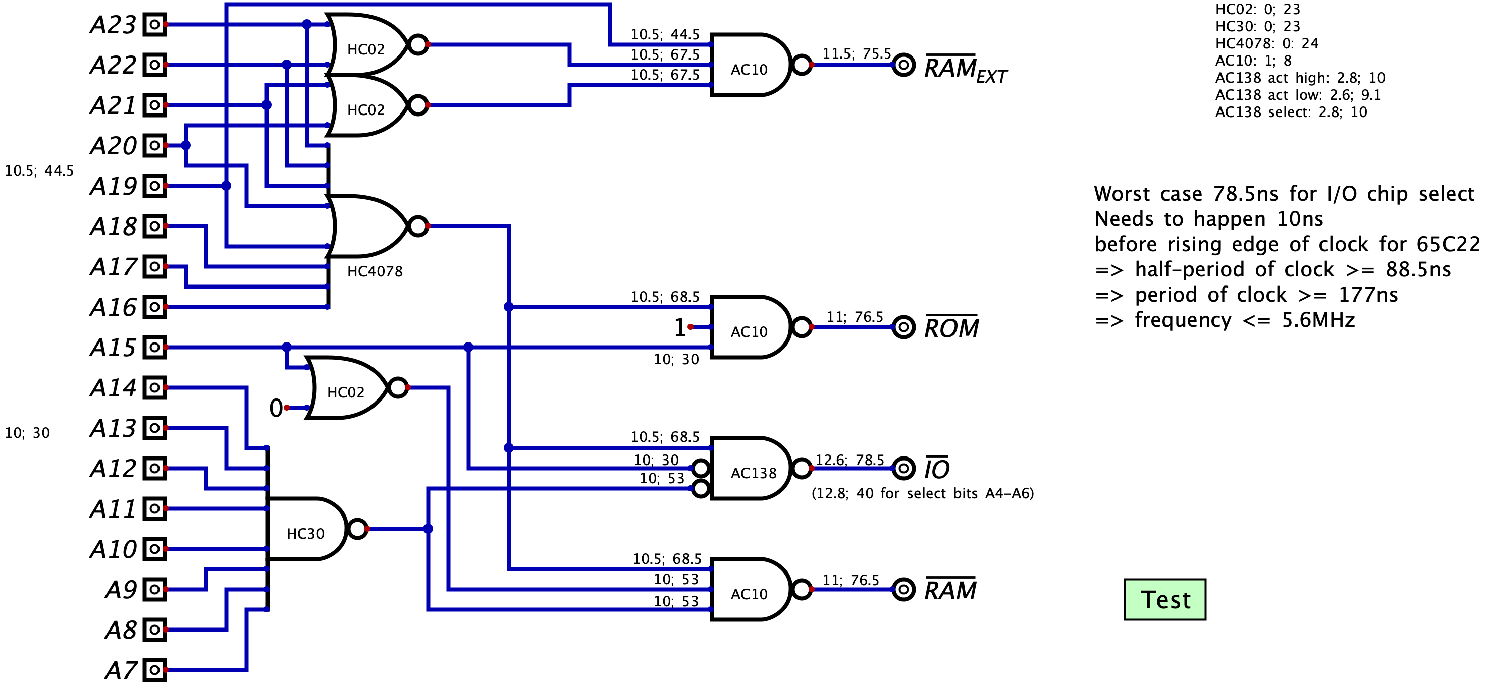

Episode 13 is out!
In this episode, I design the memory map of the CPU, and I simulate a first version of address decoding circuit in Digital. Based on the propagation delays in this circuit, I now have a max frequency! In the next episode, coming end of the week, I'll be adding some ROM.
Right now the address decoding uses an obsolete 74HC4078. I'm working on a design without this chip that will come in a later episode.
As always, let me know if you have any questions :-)
Why the big gap in the extended memory map? Glue logic would be less complex (and faster) if extended memory starts right at $010000.
Also, I'd make the I/O window larger. A small I/O window will cost you in cascaded logic and long prop delays.
Take a look at a 74ACT11030, which is much faster. You can use it place of that 74HC30 as well, which is also a slow device. See attached data sheet.
74act11030_nand_8input.pdf
74ACT11030 8-Input NAND
(387.73 KiB) Downloaded 82 times
Designed it this way so I can just look for 00001 as a prefix. Curious how would you do it with $010000? Match 00000 and ignore the first bank?
At this point, the limiting factor in prop delays is the latching and bank0 detection so I have some margin in the lower address bits handling to implement a smaller I/O range.
Thanks for the tip, I did mention this chip in the video, and would probably use it if I needed the speed (though it is expensive at 3€ a pop :( ), but my goal right now is to run at 4MHz so I have some leeway! :mrgreen:
