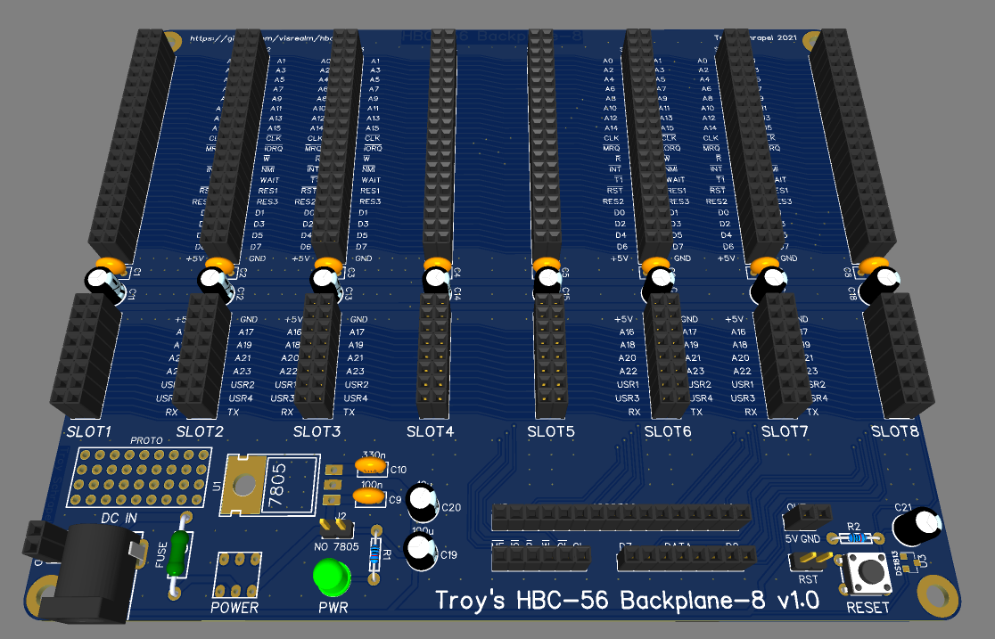

I've previously built a Ben Eater inspired breadboard CPU and got it to the point I could run Snake on a 16x2 character LCD, but was still very limited. I decided to tackle my first PCB-based hardware project and have always wanted to do a backplane, so I did (both).

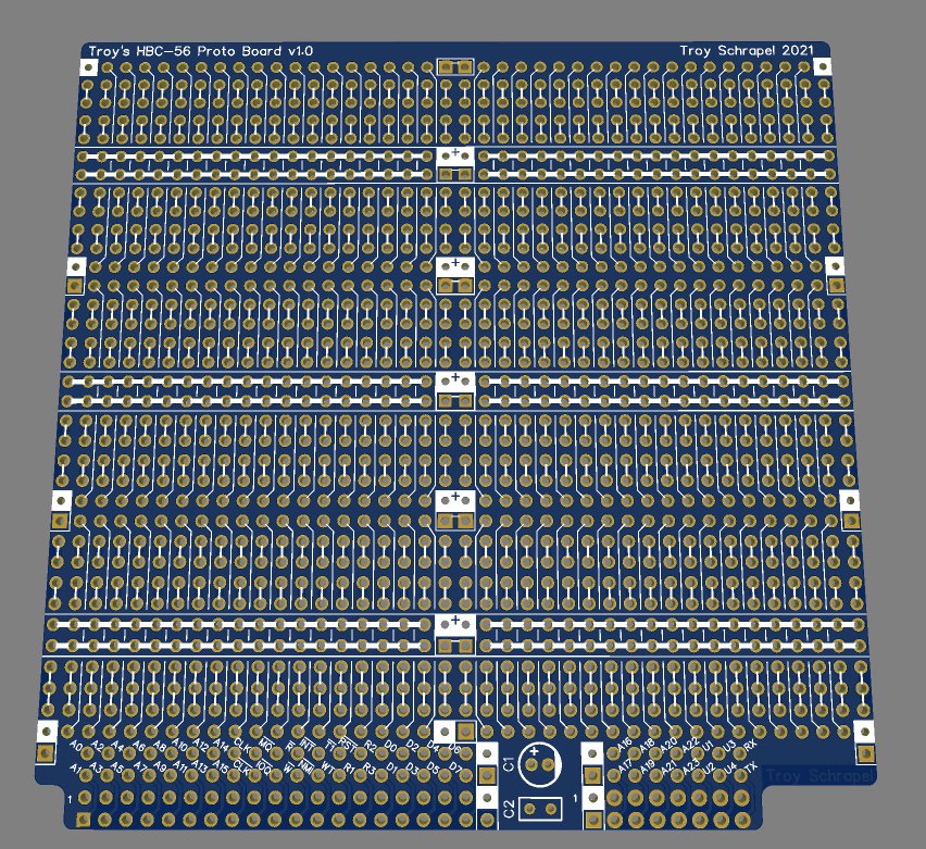

Designed and ordered a custom backplane and a bunch of custom proto-cards for it, then got to work building out the cards.
So far, I've built 6 cards:

Here's what the backplane and custom cards look like:
Troy

Very cool, nice work! I've noticed that for every person who says "don't run the busses off the board!" there is a working project like this :)
PostPosted: Sat Jan 15, 2022 12:27 am
Posts: 8505
Running the buses off the board is okay as long as you understand the potential booby-traps that may be encountered. Depending on clock speed and other factors, signal slew and/or transmission line effects can sabotage timing and render the unit DOA. For a first build, it's better to keep the buses on the board. If the buses are to be extended off-board use of transceivers to drive to peripherals may be necessary to maintain stability.
PostPosted: Sat Jan 15, 2022 8:23 am
Quite so! Actions speaking louder than words.
There's room, of course, for good advice, when a project is struggling, and in those conversations we can learn about debugging techniques and about specific electrical or timing problems.
