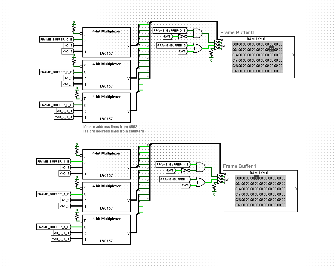

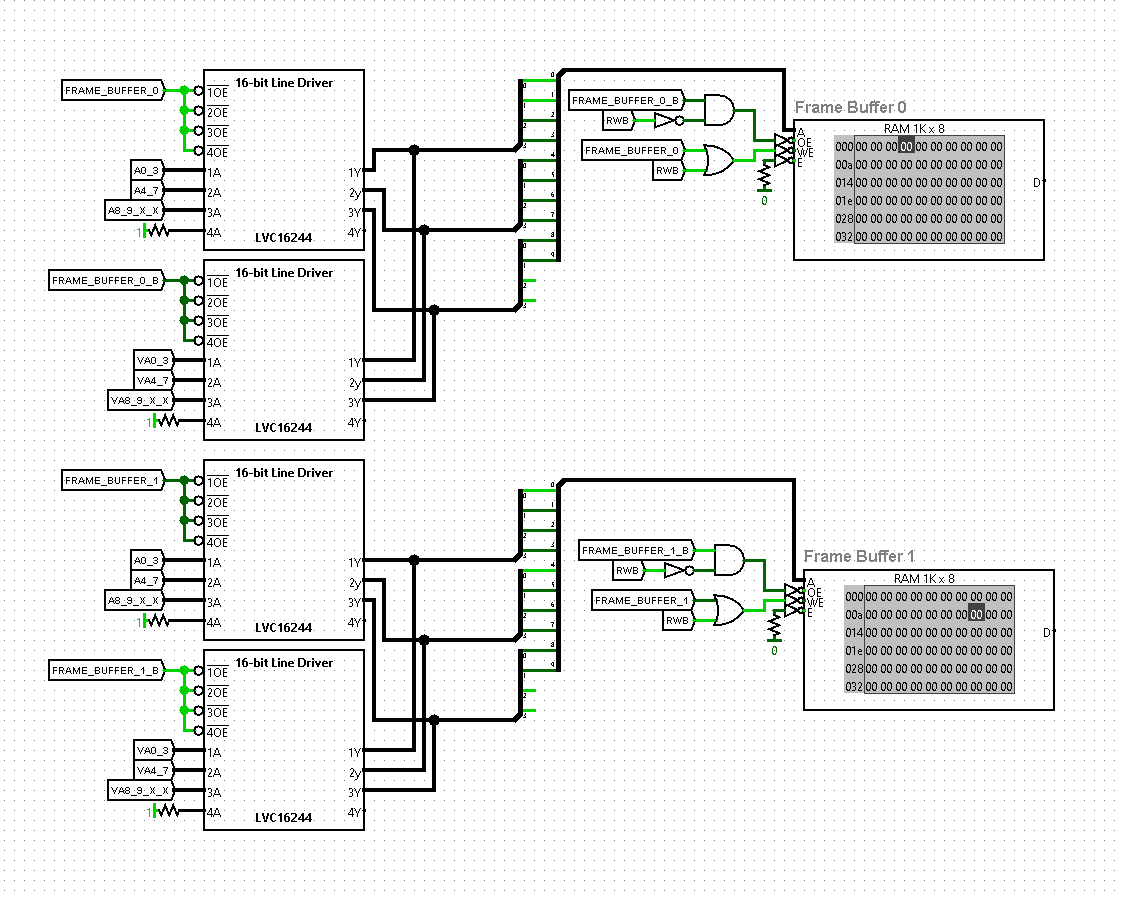

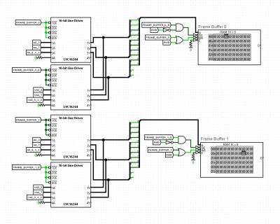

PostPosted: Sat Jan 08, 2022 7:06 am
Posts: 274
Location: South Africa
gfoot wrote:
Proxy wrote:
on a different note, would there be any differences between using Multiplexers or Tri-state buffers for this?
I personally use 74HC590 counters with tristate outputs for video addresses, and 74AHCT245 transceivers for the CPU addresss and data bus connections, rather than multiplexers, and it works very well. I think I found that the multiplexers I have are rather slow - of course you can get faster ones, I just didn't have any to hand. 8-bit ICs also feel a bit more space-efficient on a breadboard.
Exactly! 10bit address lines are a bit tricky. It's too much for an 8bit driver (or '590) and requires 2 ICs each (for a total of 8 ) but it's too few for a 16bit driver and leaves 6bits wasted in each. I've drawn it up below:
The real problem here is that sometimes you want the CPU to talk to talk to one chip and sometimes you want the CPU to talk to the other chip. And sometimes you want the video to to talk to one chip and sometimes ... well, you get the picture. That's a total of 4 signals that need to be routed :(
In the multiplexed version the LVC157s are less than half the size of the LVC16244s and are also less than half the price (these considerations really depend on what you're doing). The LVC157 chips have a propagation time of about 3ns and that is amazing(!) to me but not useful if you're not using LVC ICs or TTL levels. I also fully realise I'm a bit of an outlier on this forum by using LVC.

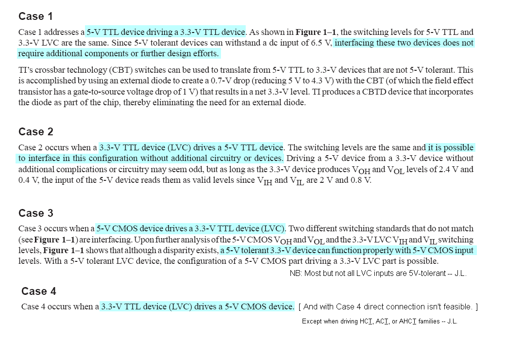

PostPosted: Sat Jan 08, 2022 2:30 pm
Posts: 3366
AndrewP wrote:
I mostly use LVC chips and they won't play nicely with HC chips [...]
You're being a little too hasty. This conclusion is incorrect for certain chips and certain circumstances.
For starters, some LVC chips are rated for 5 Volt Vcc, and thus can input directly from and output directly to HC logic running on 5V. This is true for many/most/all? members of the LVC1G family; see my anycpu.org post, Tiny, superfast gates rival programmable logic.
And even LVC chips running on 3.3V Vcc frequently don't present a problem. See the attached document from TI (excerpt included).
scba010.pdf [1.45 MiB]
Downloaded 29 times
PostPosted: Sat Jan 08, 2022 4:06 pm
Posts: 274
Yup, sorry that's true - and a misleading statement on my part. I should have phrased it as: HC chips might not play nicely with LVC chips especially when 3.3 LVC is driving 5V CMOS.
I know this: I have an LVC74 flip-flop driving an HC4040 (and it's is fine because the flip-flops output is almost exactly 3.00V once it's stabilised). Please do call me out when I make blanket statements; even if I'm not confusing anyone else it still helps me.
PostPosted: Sat Jan 08, 2022 5:04 pm
Posts: 3366
Huh? Now it's my responsibility?? :shock:
Okay, I'm making a joke. And we're all human; slipups can happen. But there's a saying that recommends putting your mind in gear before you put your mouth in motion...
Glad you've gotten this working, but you're clearly operating on the fuzzy edge. In contrast, HCT4040 would be a choice you can rely on.
