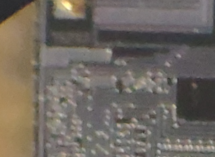

Quick addendum: oddly, the chip in the delidded package doesn't look much at all like a 6502 to me, even a revision A 6502. This has me very confused! A microscope photo would be a big help here.
I've taken the liberty of attaching a thumbnail of your photo.
File comment: delidded chip found in a collection of 6501 chips
That said, it does have the general layout of this kind of microprocessor design. But to me it doesn't look like a 6502, 6800 or even 6809.
(The history as I understand it is that MOS set out to produce both the 6501 and 6502, but they have very minor differences on the inside and are essentially the same design with different options. I would very much have expected a 6501 to look very like a 6502 in broad terms.)

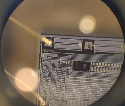

Oh hang on, at top left is that a part number?

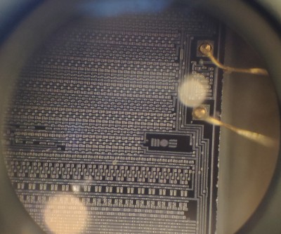

Cranked up the zoom to check and yep, it does appear to be a part number, or batch number. Both delidded chips have the same number (75298). Also present is an MOS logo. Not sure what the "2 34" below and to the right of the P/N is. Maybe batch/panel?
File comment: MOS logo
File comment: part number

Oh, great - it is indeed a calculator chip, the 7529, in this case revision B. Only thing is, usually seen in a 28 pin package.
COMMODORE: SR7919 (version-2)
Main Components: MOS TECHNOLOGY: MCS7529,
https://www.richis-lab.de/MCS7529.htm
https://www.petervis.com/Calculators/Pr ... ipset.html
https://www.thecommodorecollector.com/c ... i-computer
(The 234 you see are the mask IDs - there are 6 or 7 masks, and each has its own number. But on the silicon only some of the layers will be visible to the eye.)
