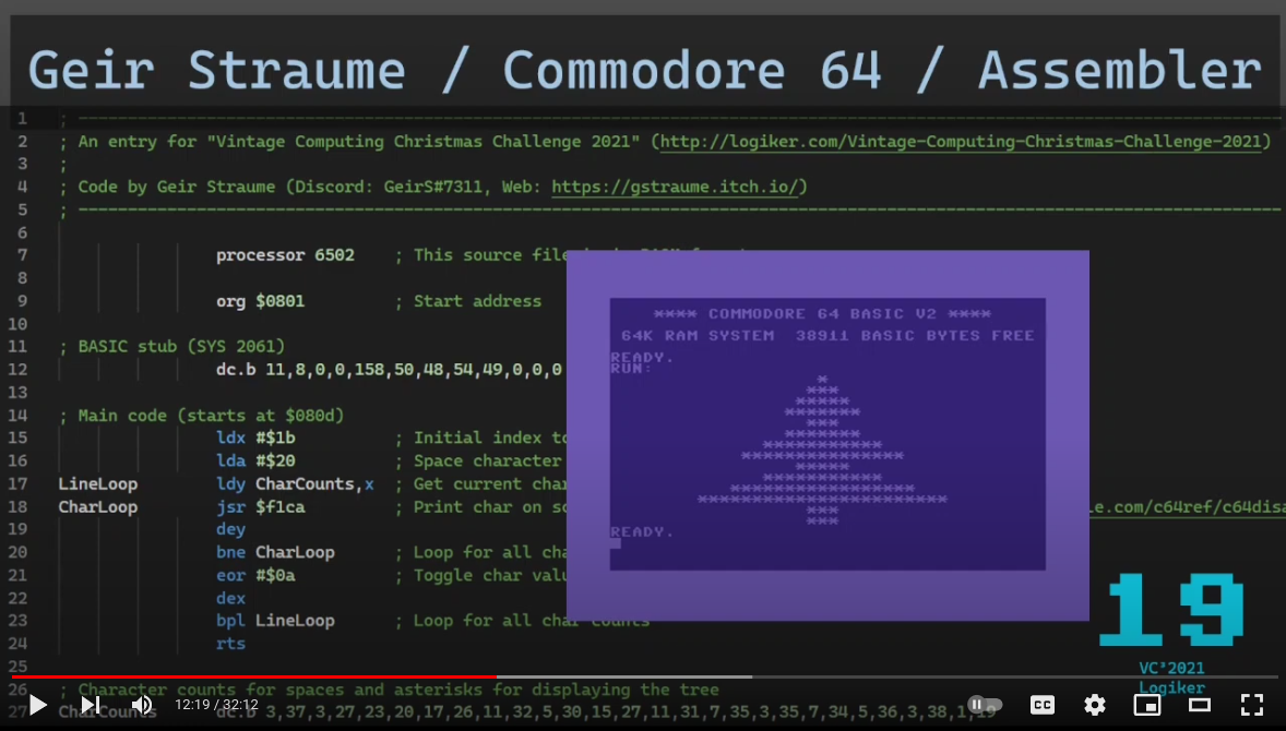

Here's a notably short entry, from Geir Straume. (I think the shorter 6502 entries use the LAX undocumented opcode. Which is of course standard on a C64's 6510.)

This is the 44 byte C64 entry that assembles to 46 byte executable:
line = 2
        * = $304 - (end - next_line)
next_line:
        lda #'*'
        ldx line
        ldy tab_c,x
finish: bmi finish
        ldx #12
next_char:
        sta $400+24*40+19,y
        sta $400+24*40+19-12,x
        dex
        dey
        bpl next_char
        jsr $e8ec
        inc line
        jmp next_line
end:
tab_c:  .byte 0,1,2,3,1,3,5,7,2,5,8,11,1,1,$ff
