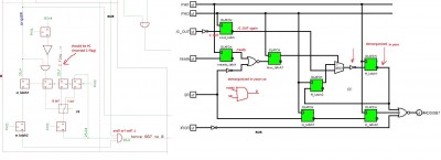

Since circuits can be compared until retirement, I'll post here as I go and mark each case study so we can refer to it.
Case_ADDSB7:
It looks like the input value of flag C must be in inverse logic.

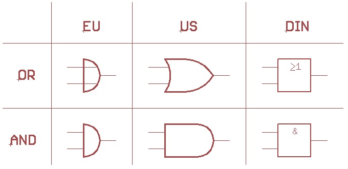

org wrote:
I absolutely do not understand where NOR, NAND, OR and AND are on the schematics. They all look the same to me :)
I'm using logic symbols in EU notation, you are using logic symbols in US notation.
//In the CAD software I'm using, EU notation is default.
I'm aware that de_morganized logic is less easy to verify against the original,
but I think it's helpful for spotting/identifying function blocks and flipflops in the original. :)

Case_ADDSB7:
There is a three_input NOR gate at the output of your circuitry (and in the silicon), generating what I called signal '25.G'.
Output of said NOR gate goes 1 if the three inputs are 0,
means in your circuitry the temporary C flag feeding said NOR gate has to store the C Flag in inverted form.
There is a three_input AND gate at the output of my circuitry, generating signal '25.G'.
Output of said AND gate goes 1 if the three inputs are 1,
means in my circuitry the temporary C flag feeding said AND gate has to store the C Flag in non_inverted form.
Case_ADDSB7: to me, my circuitry looks correct.
//To be fair, I have to warn you that my "demorganizing level" was configurated to "ruthless" during that 6509 dissection. :)

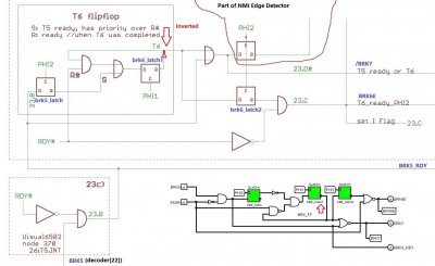

Case BRK_T6:
It looks like the inverter for brk6_latch1 is missing.
EDIT: "BRK7" is simply the name of the signal, which was obtained historically in the process of reversing, without any meaningful designations. That is, it does not mean that BRK-sequence in the T7 :)
