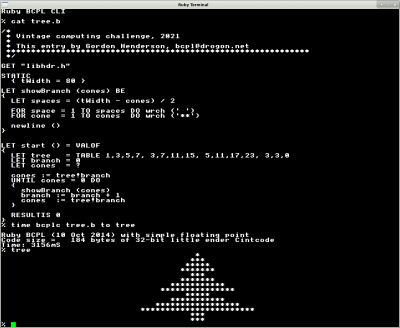

A good simple challenge - I've entered ... in BCPL on my Ruby '816, of-course ;-)

I did it in a high level language; BCPL. Runs on my Ruby '816 board - 65c816 + 512KB of RAM at 16Mhz. Images of Ruby '816 and a screenshot of the code and output below. I wish I'd thought more about seeing if I could do it algorithmically. I also note that my submission was incorrect as I mis-counted one row, however this is correct - not that it matters now!
(edited because I originally uploaded the one with the error in it!)
