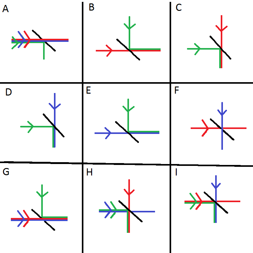

I have other schematics. But won't bore you / clog this space. 5 more diagrams. G pass ( RB ref), B pass (GR ref)... ( like above but not)
RG pass (B ref), RB pass ( G ref), GB pass ( R ref). I will post one of these three and you can do the other two "in your head"
You get the idea.

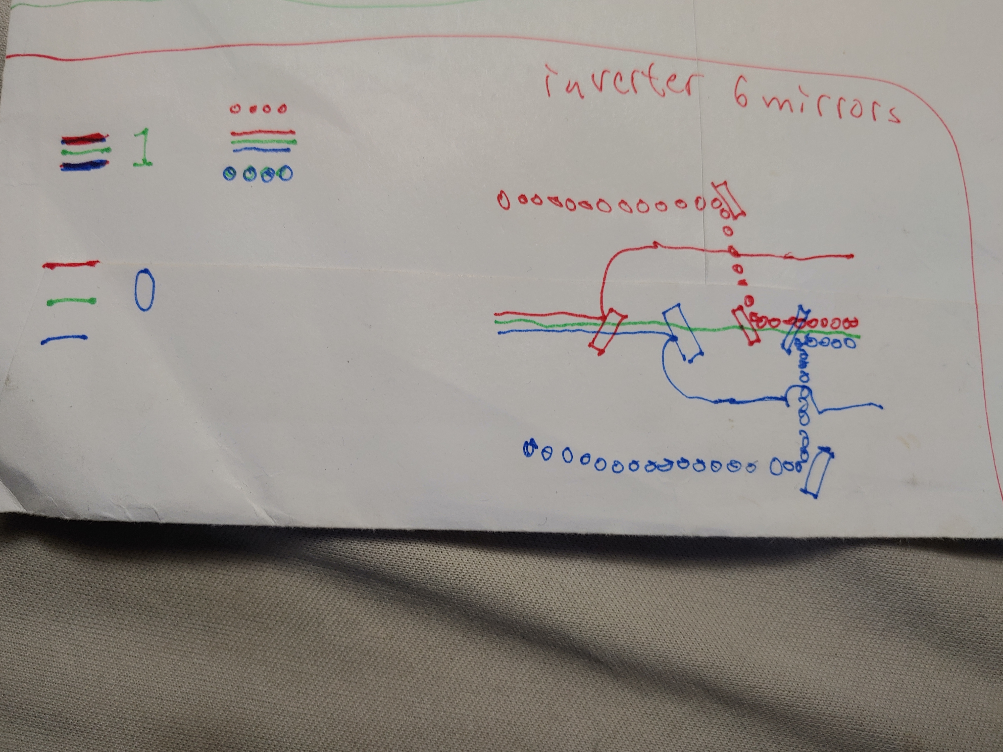

Here is a diagram I made six months ago.
Probably incomprehensible? But I remember proving it and setting it aside?
Functional completeness needs just one more logic block? Is it NAND and NOT? I forget?
That would be all combinational logic. But sequential logic is another story.
I don't get your point? About top and bottom or offset beams? Mirror/filter must "discriminate", I.e. choose the path of the incoming beams? Right?
randallmeyer2000
- Posts: 255
- Joined: 12 Oct 2015
Re: 6502 svg schematic
That should be self-explanatory?
0 is 3 separate beams. 1 is 3 combined beams.
1 in, 0 out.
0 in, 1 out.
Too many mirrors? Maybe? Somebody good with puzzles want to break it down simpler?
Could probably just use 2 beams. RG or GB or RB ... And appropriate mirror filters.
Spatial separation or combination ; path separation, is the 1 or 0.
For a two beam; say, just RG , from my diagram, you can get a 3 mirror inverter.
But I'm thinking I might try BG or BR.

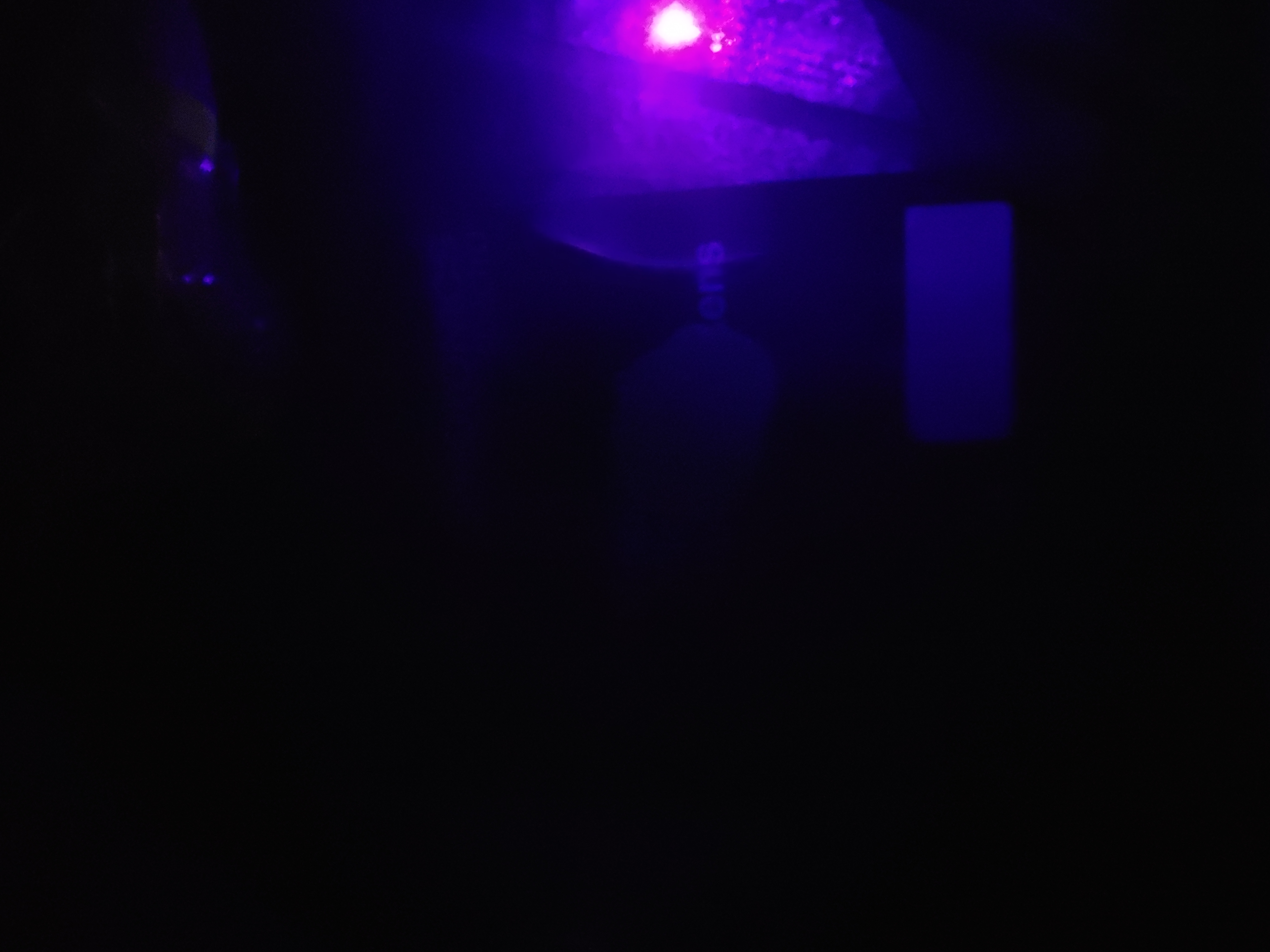

randallmeyer2000
- Posts: 255
So at the risk of clogging this, superfluous, I have, a few pictures of me "catching light in a bottle". The old delay lube technique. For 1.25$ at the ineptly named dollar store.
randallmeyer2000
- Posts: 255
This is supposed to be a picture of 3 4-bit, nibble codes ; 1010 and 1110 and 1111.
But my hand is a bit shaky.
And a photo next to an old but trusty tech. For comparison .
P.s. sorry upside down photos. My phone is smarter than me?
1111 , 0111, and 0101 ... Top to bottom. Left to right.
- GARTHWILSON
- Forum Moderator
- Posts: 8773
- Joined: 30 Aug 2002
There will need to be a way of controlling energy sources, not just directing directing signals' paths. For example, you can make a AND gate with two diodes, their cathodes being the inputs, and their anodes connected together being the output with a resistor to ground; but you cannot get very far with such logic. If you string a few of these "gates" together and do the math on the currents and voltage drops, you'll see that you running out of power really quickly, and also that there's no way to do certain functions. There has to be the relay kind of idea. In a relay, a high-impedance coil taking a small coil current can control a large contact current with low impedance. If you find a way to use a control beam to change the angle of microscopic mirrors, perhaps they could direct light from an overall light source above which would be like the VDD of the circuit. Instead of involving color or controlling the angle of mirrors, I think the better approach would be to control whether light is blocked or allowed to get through, similar to the liquid-crystal kind of idea except that the response times will have to be much, much faster than liquid-crystal. I don't know much about optics but I'm sure you'll need to solve this before starting a schematic for an optical 6502 (or other) processor. BTW, the smallest silicon geometries today have die feature sizes that are less than 2% of a wavelength of visible (blue/indigo) light, at about 6 nanometers, and they're working on 4nm.
