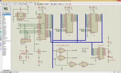

A time ago I have found such a post at https://electronics.stackexchange.com/:
Problem with glue logic/memory decoding on a 6502 project
And I have seen there 65C02-based Proteus ISIS schematic project:
Everybody can see here 65C02 in the projects window and also 65C22, 6532 & 6551 ACIA in the left menu.
May be Labcenter Electronics add an 65CXX active models in their newest versions of Proteus?
I've googled this variant but have found nothing except this topic... :?
PostPosted: Thu Jul 05, 2018 12:43 am
Posts: 8546
Note that there can be trouble with this. Writes must be qualified, one way or another, by phase 2. The address is not guaranteed to be valid and stable before R/W\ goes down, let alone with a safe setup time, meaning you can write to unintended addresses.
