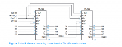

Alright, I got a question. Not sure if I should put this on a separate topic or not, though it is a small question:
https://assets.nexperia.com/documents/d ... HCT163.pdf
I'm looking to chain/ripple multiple 74HC163's together. If figured just connect chip #1 TC to chip #2 CP, while keeping CET high. Is this wrong?
This datasheet (and all others I've found) is saying that TC goes high when we are at a count of 15. That is, TC upticks on 15.
Here is what I'm wondering:
So I have chip #1 CP is connected to the oscillator. Tick tick tick, and then chip #1 count is 15. At that very same moment TC goes high.
If I had chip #1 TC connected to chip #2 CP, that would mean that chip #1 is sitting at 15, and chip #2 is sitting at 1, when I really want it at 0. Once chip #1 goes back to 0, THEN I want chip #2 to be at 1.
Thus if I were chaining/rippling these two chips, I would have a count that looks like:
0/0
1/0
2/0
14/0
15/1
0/1
1/1
2/1
If I were using these a single hex value, it would read like:
00
01
02
0E
1F
10
11
12
Am I correct in what's going on here? The bigger question: How do I chain these '163 chips together? Do I have to use CET in a way I'm misunderstanding?
Arg, I should have went with the '193 counters, I've used those before. Anyways, thanks everyone.
Chad

I think I found something useful while searching the internet for '163 examples. Attached is a picture. Weird setup in my opinion. I guess I'm just used to '193.
