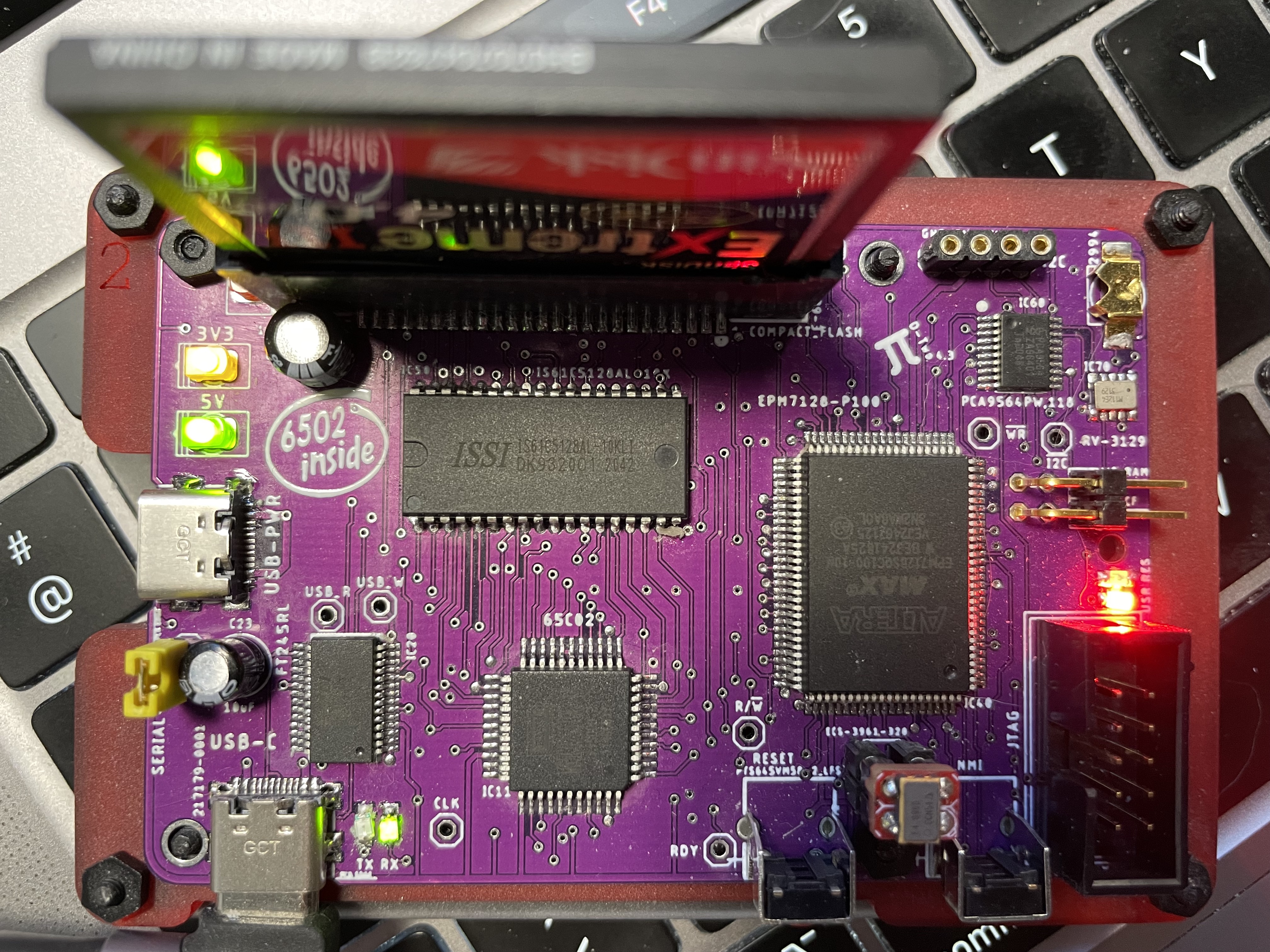

Hello,
My goal was to have a compact 65C02 SBC (PI form factor) I can use from my sofa. So this is a tty only setup. I was inspired by plasmo designs with CompactFlash. I started with the 6502 utilities he did for its frugal 6502 board.
Without CompactFlash and MMU, the board was tested at 30-35Mhz without any problems. But compact flash and CPLD design forced me to slow down my expectations. But I think I should clock the board at 20+Mhz
Briefly :
65c02@14Mhz
512K RAM
FT245 chip for USB
PCA9564 chip for I2C
RV3129 chip for RTC
EPM7128 (softswitches, address decoding, wait states, MMU, leds, headers)

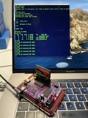

Fuzix is currently working fine (I still have some troubles with RTC stability). The 64 bytes bootstrap load a full 512 bytes sector containing the Fuzix Bootloader.

Welcome! A fast clock, lots of RAM, solid state storage, and Fuzix - very impressive indeed!

Beautifully done!
Welcome. I assume the 4-pin header next to CF disk is the I2C connector? Do you plan to drive graphic display with I2C? The 128x64 OLED display works well with I2C. The larger 128x128 grey level or color OLED display are do-able, but slow. I've also found 30MHz as the upper limit of CF interface.
Yes absolutely, I have a got a 128x64 OLED display, but not yet played with it.
Yes when I tried 35Mhz with a previous 7064, I had to insert wait states on CF. And even on my 10ns SRAM ! Now with MMU, the whole design is slowed down.

Is the FT245 acting as virtual com port or native USB connection?
PostPosted: Tue Nov 30, 2021 11:42 pm
Joined: Sat Sep 25, 2021 3:44 pm
Posts: 5
This is a true 8bits usb interface. This chip is rarely used. This is strange since it is very to interface, and I do not have to add or synthesize an ACIA.

I read the datasheet, and found four control pins besides the data bus.
And that's where I stopped because I can't tell where to connect that control pins in the 6502. In your design I see the FT240 connected to a CPLD.
Yes cpld is the way to go to achieve a compact design.
