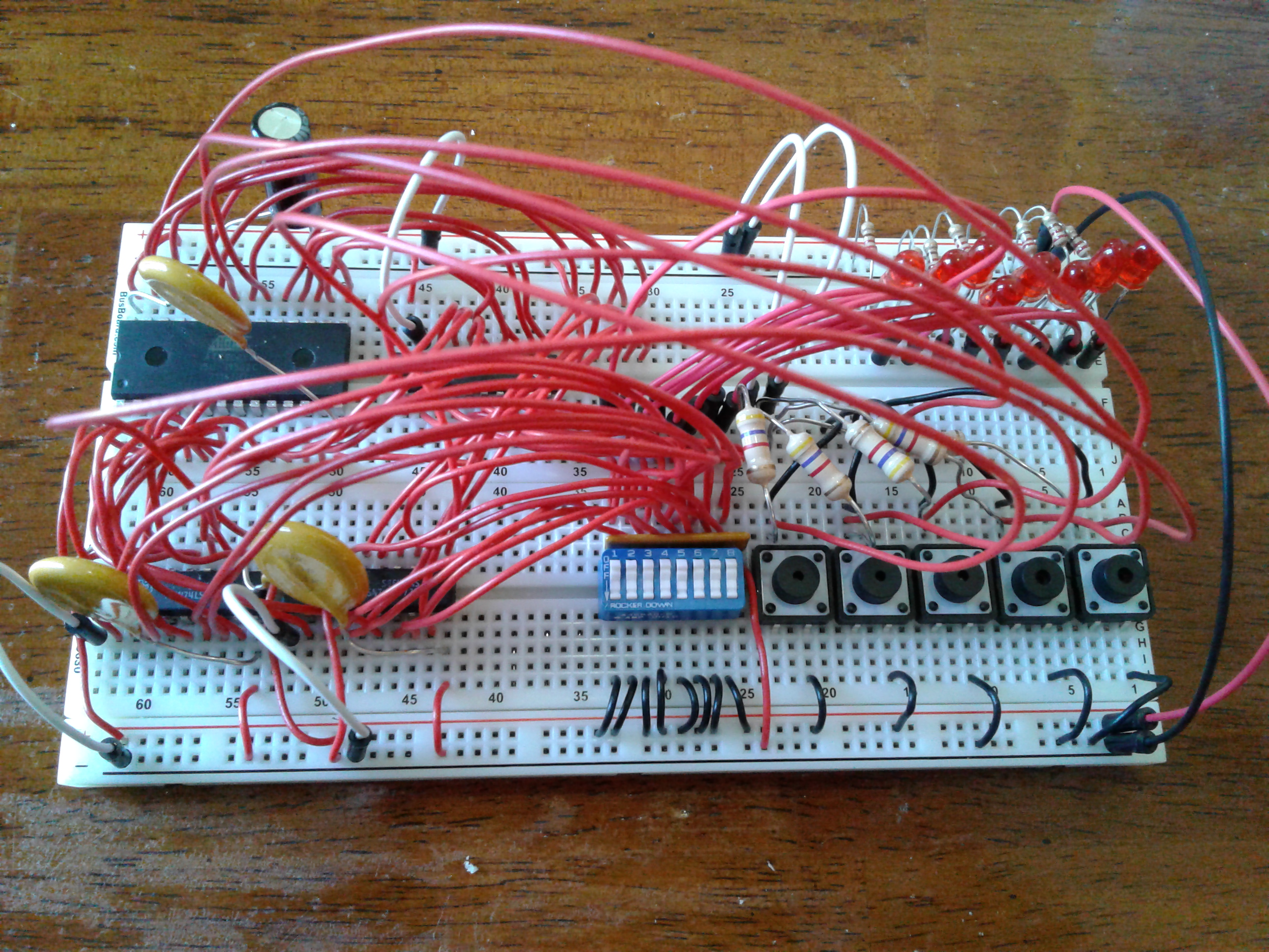

Attached is a picture of my home-brew EEPROM programmer. I had done one variation a couple of weeks ago, but I found that I need something automated in order to unlock it (speed requirements), and of course to program it at any reasonable speed once unlocked. This will eventually attach directly to a Raspberry Pi's GPIO pins, but I wanted the manual controls as an option.
It has a 28C256 in the top-left corner, 2x 74LS373 Octal Latches, 1x 74LS245 Trans Bus, some LED's, a DIP switch, and buttons. The buttons and switches are pulled up or down to whatever is needed. Anything going in or out of that EEPROM is running through a 74LS' chip, so I'm not (very) worried about frying my Pi.
And guess what. It works... sometimes. [ AH not that again! ] I checked, I didn't cross any wires, haha.
I've been looking at it, and checking different things. It seems that BOTH latches enable whenever I push one of the buttons. I put the scope to it, and I see that sometimes I get a different voltage level on the oppose latch's enable line. As in, when I push one button both activate for some reason. The scope shows interference sometimes, but others it's clean and smooth.
And when I mean "activate" it must be a fluke because when I push one button it goes from 0V to 5V, easy, but the other does not nearly reach 5V. Idk.
I did a lot of different things with capacitors and other kinds of switches, but it seems to always be this way. Both latches want to enable at once.
Obviously this is on a breadboard, and probably a cheap one. I suspect major ground bounce stuff.
What options do I have (with a breadboard) to stop ground bounce and inconsistency? You can reply, "Print a board" or "Solder a board" or something. I could do that, I got some perf board left over from the last project. But I want to explore breadboard options first. Ideas? Thoughts?
[ You can make jokes about crossing wires if you like, I deserve it from the last project. ]
Thank you all!
Chad
EDIT:
So I put in two tiny push buttons that can make one or the other latch's enable go to ground (disabling it). That has helped some. It is not perfect, but has worked more often.

It would be best if you posted a schematic along with your questions, because it's not clear what's attached to what from your description.
There's no reason why you shouldn't be able to get a circuit built with 74LS series logic to work on a breadboard.
Last time I checked, raspberry pi's have 3.3V I/O pins and I don't think they will take kindly to being driven with 5V signals.
PostPosted: Sat Nov 20, 2021 9:33 pm
Posts: 325
What are those giant yellow things? They're connected where I'd expect decoupling capacitors, but they look more like MOVs to me.
I don't see any debouncing on the buttons, and I don't see anything to control the length of the programming pulses. The second might not be an issue, but the first probably will be.
(edit): it looks like you're pulling up the DIP switches through LEDs. That might cause problems too. There's a considerable voltage drop across the LED, so your 'high' signal will be a fair bit below 5V. Whether that's a problem depends on the thresholds of the chips taking it as an input.

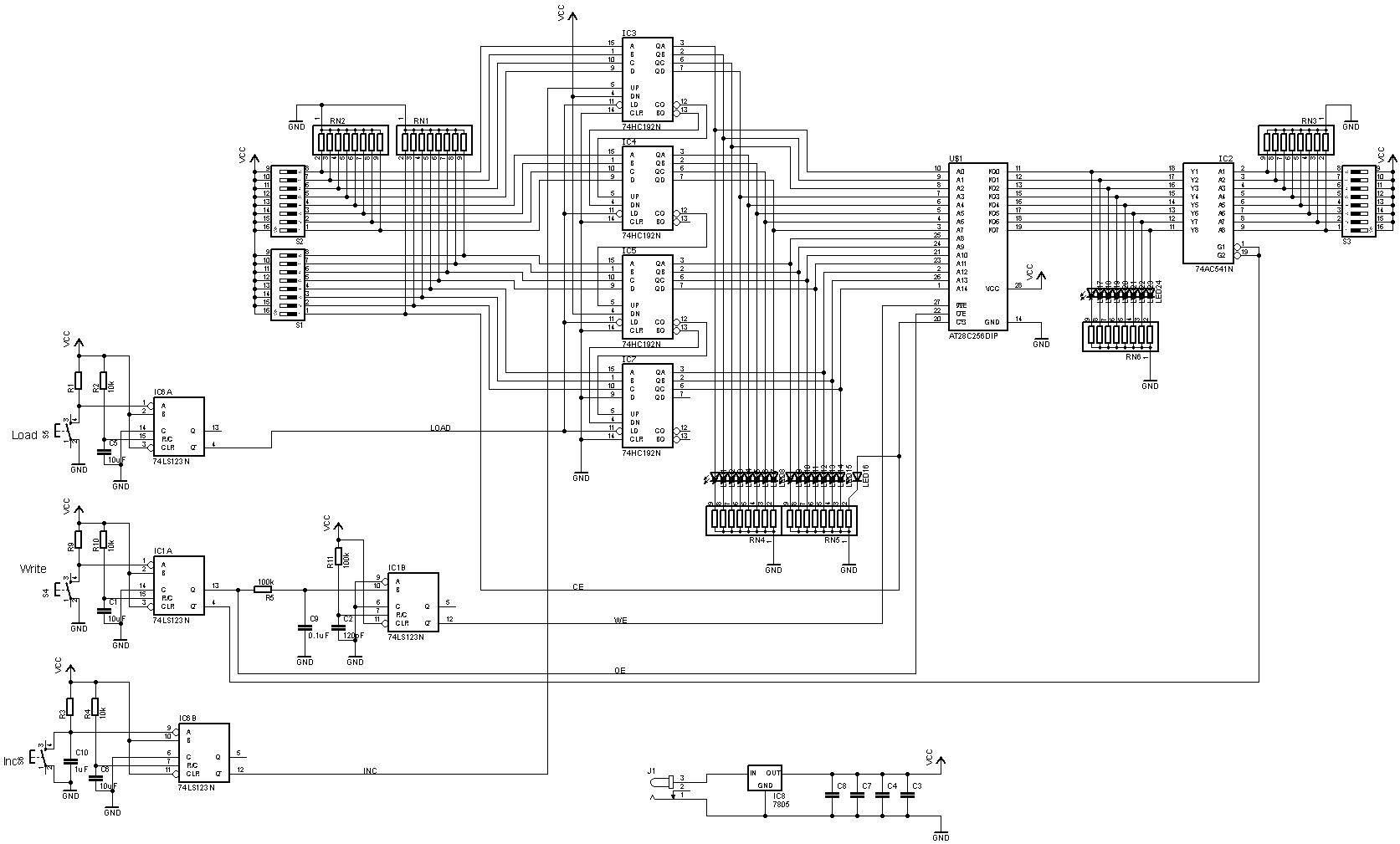

Here's the schematic for mine. I think it has the corrections I made to the board. Either this, or something very similar to it, is working fine. Put the starting address in the address DIP switches, then press "Load". The data LEDs will show the current contents of that location. Put new data in the data DIP switches, then press "Write". That will program one byte. Then press "Inc" to move to the next location.

Thank you for the reply, I did not create a schematic for it yet, but I will consider doing that soon.
Yes I have been considering the Pi's 3.3V. I haven't attached it yet. The idea was that the 28C256 will accept 3.3V TTL logic levels, but will output 5V. Because the data lines on the 28C256 are going through a 74LS245, which *will* accept the 5V and convert it to 3.3V, I was thinking that would make it safe for the Pi. Will test additionally before doing that of course.
@John West
Thank you for the schematic! I had been thinking of doing something like that for a while. I like the use of the counters.
Those giant yellow things are the decoupling capacitors, but apparently when I purchased them I didn't notice the size.
I am not debouncing the buttons, I am not controlling length of pulses. The debouncing part certainly would be an issue if I were using counters, but I'm just putting in DIP switch value directly into '373 latches and the '245 bus.
The LED's are directly on the data line and all that, but they are not on the enable lines at all. I was changing the pull-up and pull-down resistor values to make it work. 10k for the DIP switch was too much, so right now it's 3.3K seems to work for that. I think I will change the values of of the control line pull-up and pull-down resistors, and see if that helps.
Thank you both!
EDIT:
I adjusted the pull-down resistor values for the latch enables, and that also helps a lot. Using both the "ground the other guy" method, AND this new resistor value, it seems to work most of the time now, if not always.
Hm! I'll be thinking this over, why it's happening, etc. And next, to see if it's safe for the Pi! Thanks!

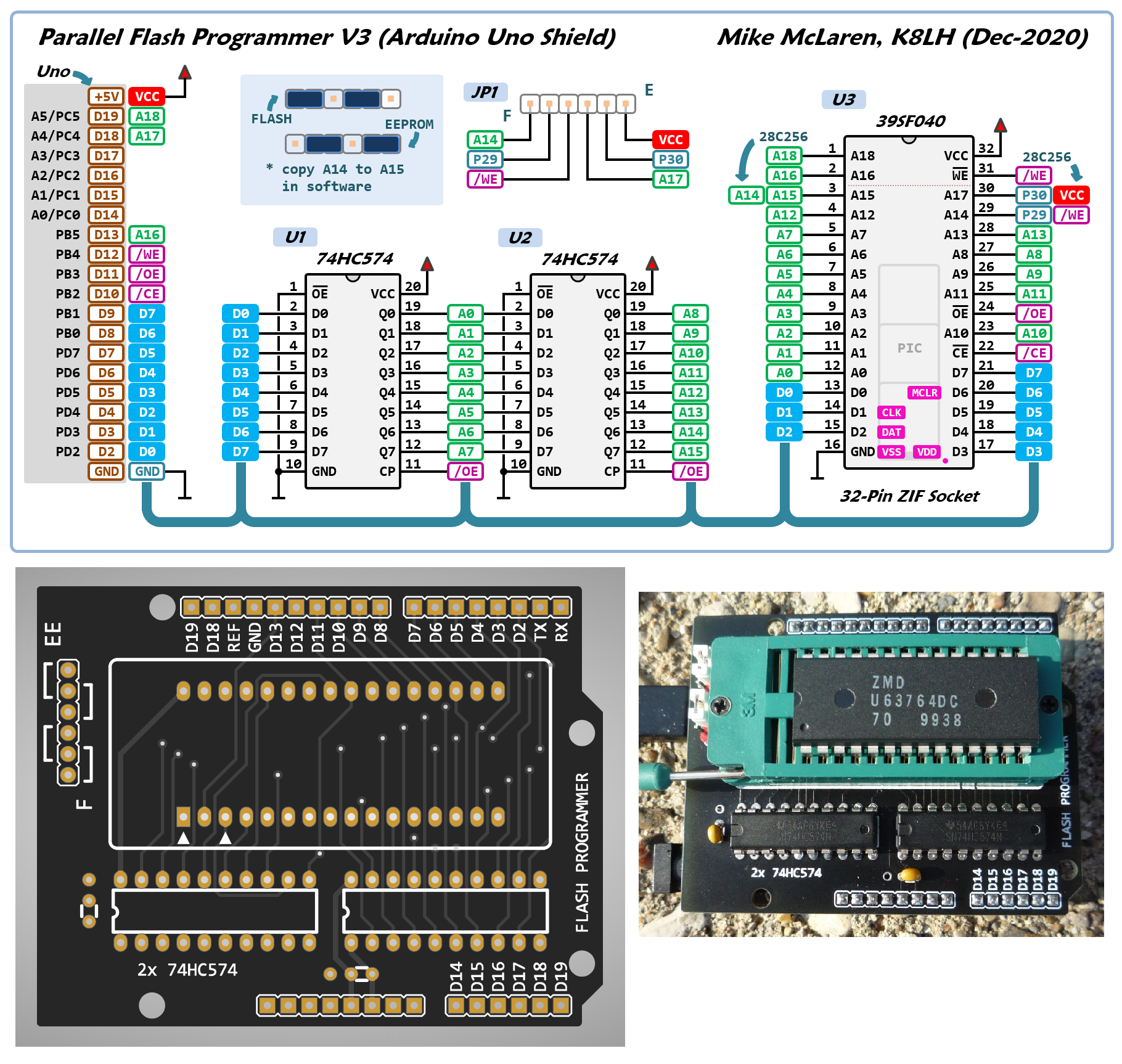

Part of the problem using the high overhead Arduino DigitalWrite() function with TommyProm and similar programmers that use a pair of serial-to-parallel shift registers is that it can take up to 56 port write operations (in the case of TommyProm) to load 16 address bits into the shift registers. Compare that to a pair of cascaded latches that only require 8 port write operations. Also, while it may seem more intuitive to use a pair of serial-to-parallel shift registers to "save pins" on the Arduino, a pair of cascaded latches actually use less pins because you can re-task the eight data pins and one of the control pins to load the address latches while the EEPROM is off (/CE = 1).
