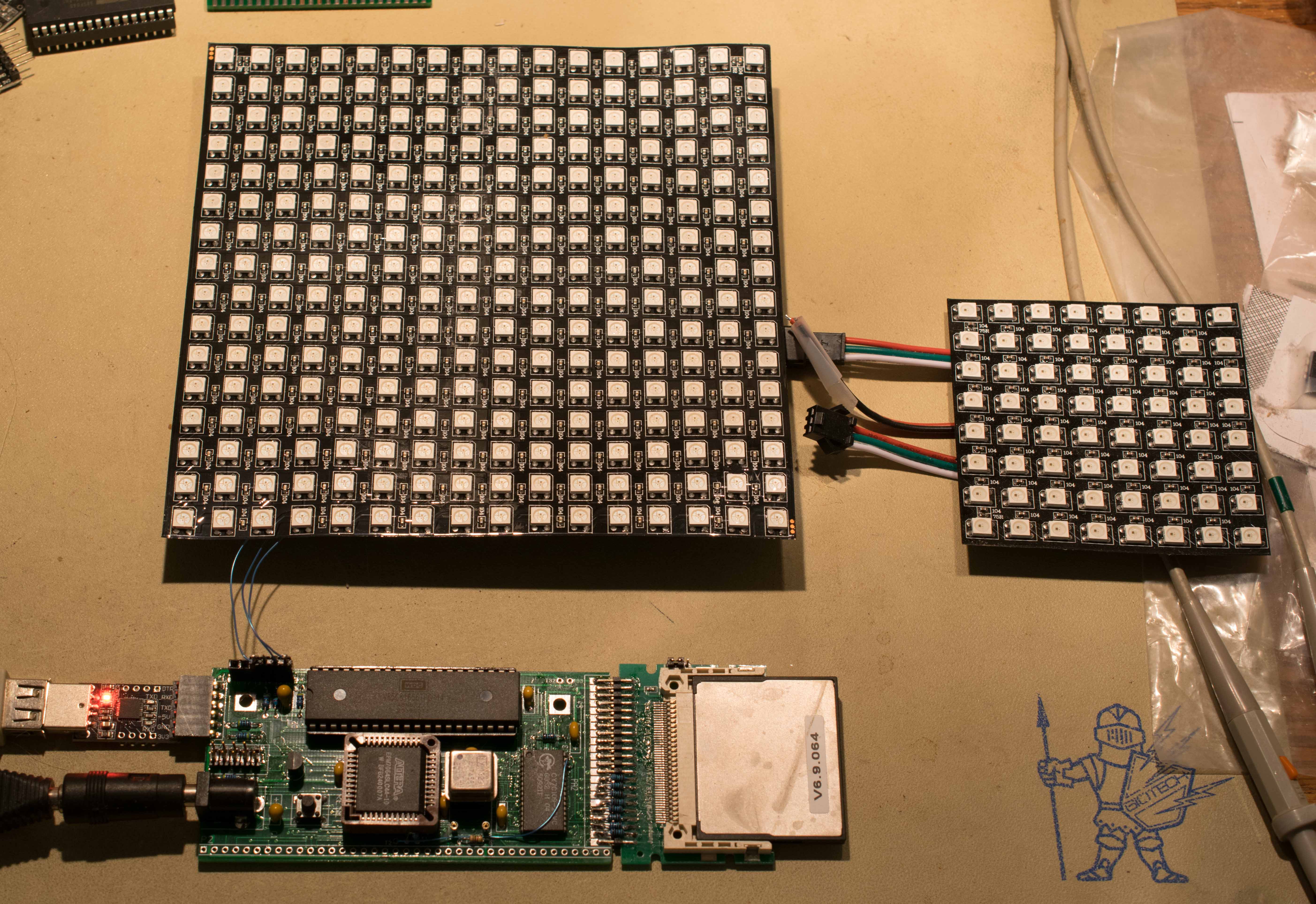

PostPosted: Wed Dec 29, 2021 4:11 am
Posts: 1084
Got this 16x16 WS2812B panel in the mail today. Don't let anyone tell you different, size does matter! :lol:
Each LED takes 24 pulses at 800KHz, so 7.4mS to paint the 16x16 screen. It is certainly fast enough to animate. So what can I do with this? Sure, a bigger Christmas tree with blinking light; and it is big enough for Game of Life and maybe Tetris. What else? This is a $20 solution looking for a problem.
