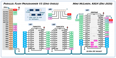

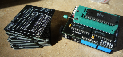

Since we're discussing tools and barriers to participate in the hobby (necessary tools, costs, ease of construction, etc.), I'd like to suggest that the Arduino Uno and the Arduino Nano clones are a worthwhile investment. I'm necessarily frugal (financially challenged?) and a commercial programmer, while not entirely out of reach, would have used up several months of my meager $20/month hobby budget. Instead I enjoyed designing and building a FLASH/EEPROM programmer shield for an Arduino Uno. I bought five Arduino Uno clones with micro-USB connector ($3.03 each, including shipping) one month, ordered ten Flash Programmer PCBs ($18.20, including shipping) the next month, and I ordered 32-pin ZIF sockets ($1.29 each) the following month. Drawing & details below... I used a pair of latches which can be loaded with 16 address bits much faster than a pair of shift registers (while also using less pins on the Arduino board).
I believe newcomers might enjoy building simple and relatively inexpensive tools like a Flash/EEPROM Programmer shield, especially with the gratification of seeing results immediately after a couple hours of assembly. A relatively simple set of instructions could guide them through installing the Arduino IDE and a 'sketch' (program) into the Arduino board as well as guiding them through the programmer shield assembly process (some 100+ solder connections). Program Flash or EEPROM chips using a terminal program with x-modem at 115200 baud.

Getting back to the original post's subject matter, I think anything to help the newbie in this way needs to refrain from requiring him to learn Arduino, ARM, other programming languages, etc.. It should be pretty close to plug-and-play (possibly following an easy PCB assembly) with Windows, Mac, and Linux, maybe even DOS. I don't see any problem with something that only programs a few devices, since this is to get him started, not support long-term professional development.
PostPosted: Sun Oct 31, 2021 7:33 pm
Posts: 1003
An Arduino solution provides all this Garth. All the newbie needs to do is download the pre-developed 'sketch' to their device and away they go. The shield concept mentioned in the previous post to yours would be an easy build with just 2 or 3 74HC575s on it and a zif socket.
Arduinos program in C/C++, so a lot of folks will already be familiar with it anyway.
I agree. Since the Arduino program has already been written, the end user doesn't really need to learn a language. Programming the Arduino Uno or Nano would be similar to using the program that comes with your commercial EPROM programmer to program an EPROM. That is, you install then run the Arduino IDE, <file><load> the Arduino sketch, select com port and board type, and hit the <program> button. Easy peazy!

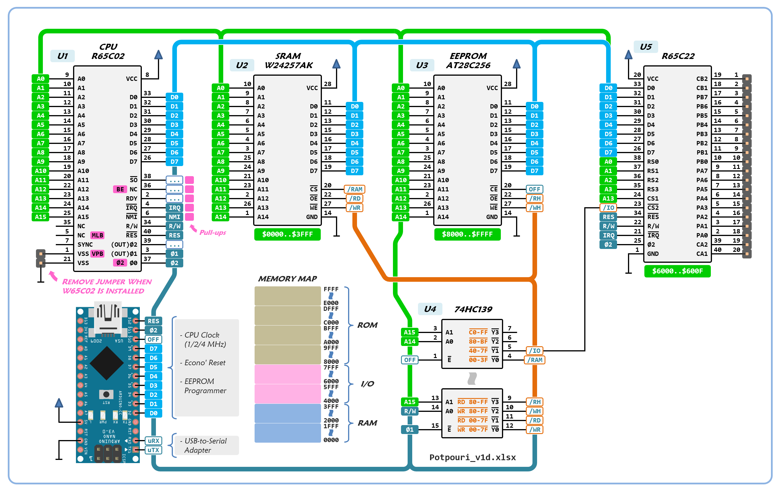

Lots of good discussions. My reason for focusing on a 6502 solution is because when a newbie comes to 6502.org to learn about what 6502 can do, an Arduino or Pi solution seems not satisfy the newcomer's interest. My guess is the newcomer does expect some challenges dealing with 40+ year old technology; a modern peripheral maybe acceptable but abandoning the core 6502 CPU for modern CPU may be disappointing.
I'm intrigued by the possibility of serial bootstrapping. The serial receive ready can tie to 6502's RDY so 6502 executes one instruction and wait on next instruction to be ready. While waiting for such serial bootstrap engine to be realized, a FT245R may fit the function quite nicely. Attached is my strawman design of bootstrapping using FT245R. The basic idea is locating FT245R at reset vector memory area and connect its receive data ready to 6502's RDY such that FT245R's 8-bit parallel port provides the opcode to 6502. This way PC sent 6502 opcode over USB for 6502 to execute. First, the binary opcode stream builds a small bootstrap program in RAM and then jumps into the bootstrap program to load bigger & better program over FT245R.
