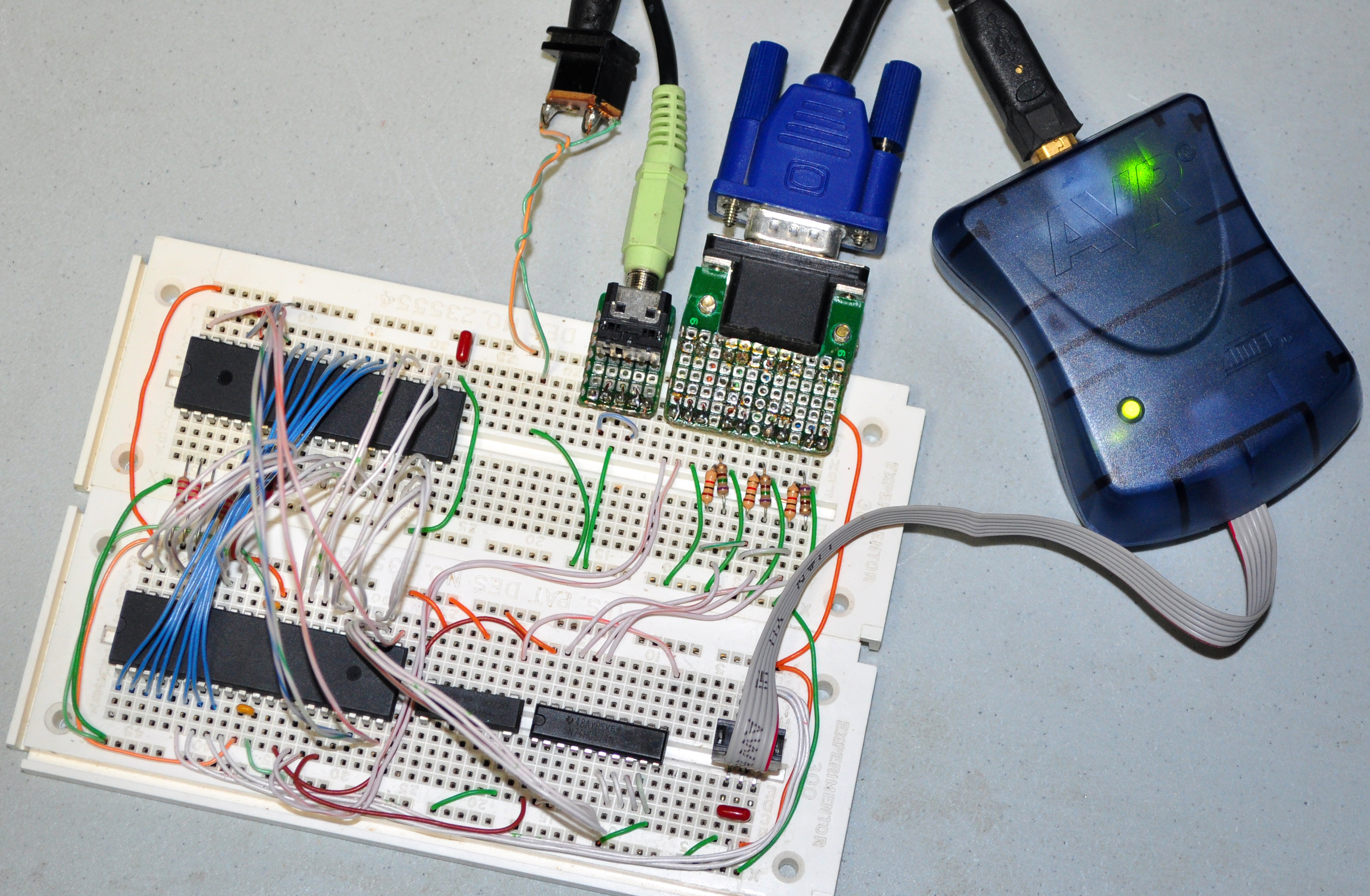

I ask this not to sound snarky, but just curious...
Why would anyone out there consider a ROM these days, especially in a 6502 project?
I have done many 6502 systems now, and have never used or will ever us a ROM.
When I first started, I looked at using a ROM and then ran into the same that most do; expensive programmer, slow access time, fiddly to reprogram in a hurry.
So instead, I used a $1.50 AVR and its inexpensive programmer. I have also used PICs, although the AVR32 series cost the same and are fast enough to actually emulate a ROM in a 6502 system directly.
How I do it is by connecting the AVR in parallel to the SRAM running the 6502. Right away, you now have many options for RAM in sizes from 2K to 512K with speeds as good as 10ns and in DIP packages. At 10ns, you can get a 65C02 smokin' along at over 10MHz with ease.
To "Boot", the AVR simply pulls on the BE / RS line of the 65C02, and then dumps it's contents to the SRAM. After that, it tristates all pins and goes to sleep, allowing the 6502 to run fully from the fast SRAM and allow read/write to the entire 64K of space.
To program my code, I use one of the PC based assemblers (Kowalski is my fav), and then include the binary in the AVR program to be uploaded. Now I can code on the PC, and with a few clicks, see the 6502 running my code. This is also all done in circuit - no pulling a ROM for programming.
SO for a fraction of the cost of the ROM method, you get a MUCH faster system, way more memory options, and instant code and load.
And if all of that isn't reason enough to call now and order your ROMless system, get a lod of this...
Any of the 20MHz AVR's are fast enough to directly emulate ROM in a 1MHz 6502 system. So you can bypass the SRAM altogether and connect one AVR to the 6502. Plug in your Atmel-ICE, and you can program your 6502 system in less steps than a friggin Arduino! Code and load!
So I must ask... why bother with ROM at all, unless doing an OEM rebuild on some vintage gear?
Here is one of my many ROMless projects, this one running directly from the AVR. The programmer shown here allows me to code 6502 assembly on the PC, press one button and then see the code running on the 6502. The other ICs on the board support the AVR further, allowing VGA generation, so this is a complete 6502 SBC that can put out color video with only 4 ICs.

Or if you consider an AVR programmer and its target to be a legitimate ROM as I do, it would fit right into this thread!
Actually, once programmed, the AVR is indeed a ROM, and to build it, one just needs to bend a 6 pin header to fit a breadboard.
