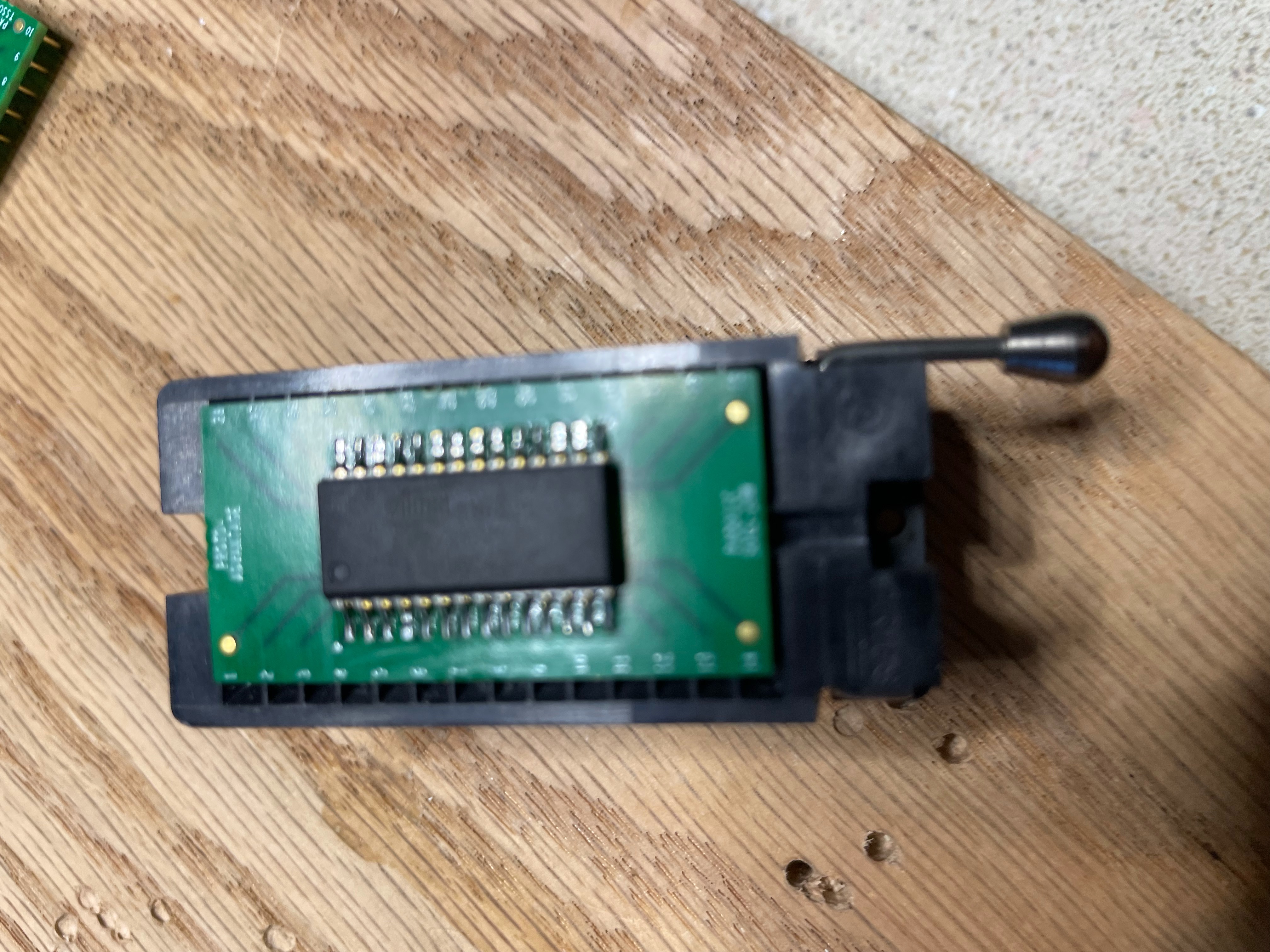

I am a little bit angry right now. It seems like there are no DIP EPROM or EEPROMs that work on 3.3V, meaning I might have to jack up the main rail to 5V or add a PLCC32 socket for one of Atmel's 3.3V offerings (the OTP EPROM and the EEPROM are not pin compatible in PLCC32).
Arrow Electronics has the AT28BV256 EEPROM in SOIC in stock. It's the same pinout as the DIP version and Proto-Advantage has an adapter to convert to 28-pin DIP. I'm using this setup in my 3.3V prototype project. It's a 200ns part, and I'm running it at 4 MHz.
