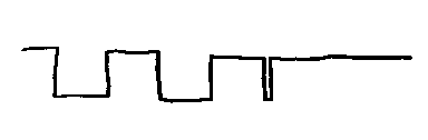

The CD4000 series logic is generally much too slow for this kind of work. 74xx4000 is much faster. You will still need a way to turn it off soon after the rising edge, so you don't get glitches like this one where it's getting turned off at random times and in this case right after the falling edge, a glitch that would crash the computer because it does not meet the minimum phase-2-low time:
