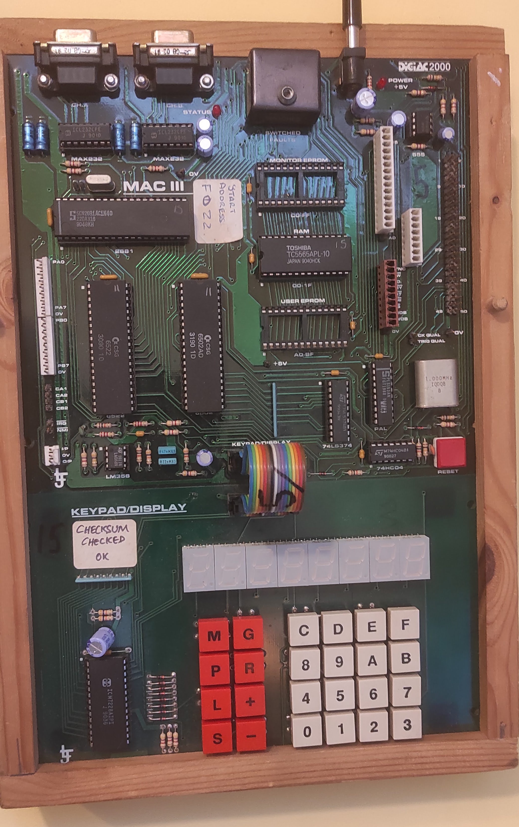

I've just got hold of one of these from a flea market. It's quite a nice thing, part of a larger set of boards used for training. I've been able to get a bit of information about it (manuals etc) from the manufacturer who are still going. However the main problem is that the monitor EPROM has been removed and so the board doesn't do much on its own.
So... I was wondering firstly if anyone else knows anything about them and if by some chance someone might have one with an EPROM in it.
At the moment I've hung it on the wall and it makes a nice ornament but I would like to be able to use it too!

If you can dump the EPROM I'd be dead keen to try it in the board I have. I have powered it up and got a red light but nothing else.
I have got some documentation from the original supplier including manuals, and so far as I can find out it should come up and say 'Ready' on the display. I've got it mounted on the wall as an ornament / conversation piece, but the plan would be to have a battery pack in the frame so it would actually work in situ.

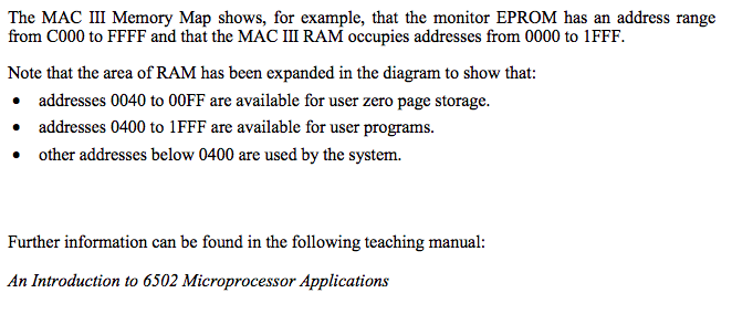

The most useful bit is probably the user manual, you have got in effect the complete system with the applications module too which is very nice. The monitor includes some routines which run on the applications module, and the details for that are in the manual.

Very nice - we get a memory map! (And, surprisingly, a 2005 date)
