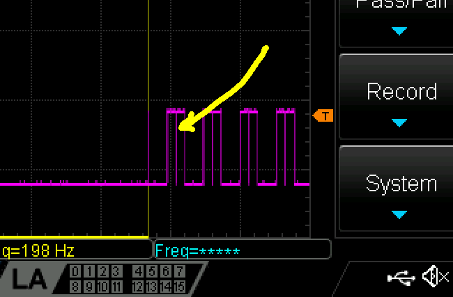

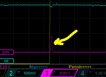

Wow -- really? I'm glad, of course. But you seemed to have some pretty strange glitches on SYNC. These could perhaps be an artifact of your 'scope setup, and have no functional implications. But unless these can be explained I'm left with a nagging feeling that all is not yet well. :|
DS1Z_QuickPrint4 .png (8.56 KiB) Viewed 900 times

Individual_Solid wrote:
It all works. [...] this revision has fully come to life.
Wow -- really? I'm glad, of course. But you seemed to have some pretty strange glitches on SYNC. These could perhaps be an artifact of your 'scope setup, and have no functional implications. But unless these can be eliminated or at least explained I'm left with a nagging feeling that all is not yet well. :|
I think that weirdness (at least, in the second screenshot you posted) comes from the CPU starting up and then being pulled back into RESET.

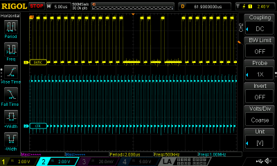

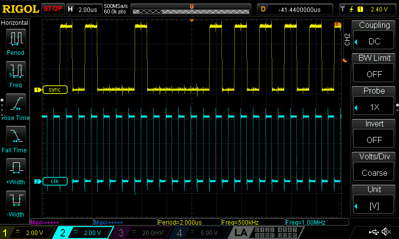

I just took some shots of a trace with the now functioning RESET circuit.
This is showing mostly NOPs with an occasional register decrement. This is a little noisy, but I'm definitely attaching the probe grounds a little far from the signal source. Do you still see something I should be worried about? I can do a trace from power-on again, if that's worth while.
Posts: 3525
Re: B36502X Single Board Computer
No, I don't notice any problem with these latest traces. SYNC should go high for one entire cycle at a time -- never a fraction of one cycle. And yet, fractional-cycle glitches is what the previous traces seemed to show.

Posts: 9425
Thanks for double checking for me! I'm getting pretty quick at setting up these experiments on the scope!
Just for grins, try inserting some series resistance into the clock circuit to see if you can dampen some of the over-/undershoot in the signal. The degree of over-/undershoot shouldn't be detrimental to your application, but dampening it may also reduce noise in other places.
If you try this, place the resistor as close to the clock source as you can. I'd start at 100 ohms. BTW, you're likely to see better results with a metal film resistor than a carbon one.
