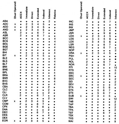

That is why we see the exclusive use of three-character mnemonics, unlike the ancestral 6800 language.
No. The 6800 assembly language as defined by Motorola uses exclusively three-character mnemonics. (See attached chart from the Motorola M6800 Programming Reference Manual.) Perhaps you have chosen to use some non-standard version of 6800 assembly.
(For what it's worth, I think that there's absolutely nothing wrong with being non-standard in any way in an assembly language you're defining, so long as you have a good reason for it. To make your language worse and more difficult to program in merely to follow a "standard" is blind stupidity. Do not take this to mean that I think every change out there is justified.)

The 6800 assembly language does not exclusively use three-character mnemonics because accumulator-based instructions have a fourth mnemonic character identifying which accumulator is the target.
No. That character is not part of the mnemonic, it is part of the operand. E.g., `LDA B,#13`. Note where the space separating the mnemonic and the operand field is.
In both examples, 'A' and 'B' are considered to be part of the complete mnemonic...
By you, sure. But not by Motorola, which you'll note refers to them as "(Dual Operand)" in the excerpt I posted.
If you're going to go to battle for letters in the operand field being part of the mnemonic when they change the opcode or destination of other parts of the operand, keep in mind that in 6502 assembler, the `,X` in `LDA $(13,X)` does the same.
...in 6800 assembly language would LDAA #<operand>...
In whatever non-standard assembler you were using, sure. You won't see anything like that in Motorola's M6800 Programming Reference Manual.
See page 3-22 of Lance Leventhal's 6800 Assembly Language Programming for a reference.
Sure he differs from Motorola here. But I'm not buying that Motorola themselves created and published "non-standard mnemonics at the start" and it was only that later that third parties developed the "standard" mnemonics for the CPU. If you go down that route, who's to say that the mnemonics you so like for the 6502 are "standard"?
When you posted your reply here you already had a reference from me for Motorola's original programming manual for the 6800, which is freely available on archive.org. I suggest you go have a read. And maybe think about exactly why you're not explaining why that source is inconsistent with your third-party source and how that affects your argument, since you knew (or should have known) about that inconsistency.

https://www.lucidtechnologies.info/6803_instr.pdf
One can clearly see in the instruction table on page 2 accumulator instructions that are four-character mnemonics.
