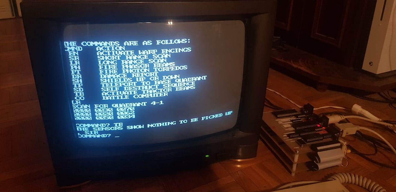

BillG wrote:
* Microsoft BASIC for the Altair 680
Unfortunately as fr I know there are no sources available. Making it run on my hardware will be tricky and above my skill I am affraid...
* Robert Uiterwyk's 4K and 8K BASIC for the SWTPC 6800. I think the MicroBASIC you have is the 4K version. The source code for the 8K version may have been made available as well.
* Technical Systems Consultants (TSC) BASIC and Extended BASIC for FLEX
According to the info printed on screen at startup, In fact I am using TSC Basic. For some reason the place where I found it on line described it as a "MicroBasic".
Microsoft may be the best bet for something ROMable.
There is no source code so I can neither relocate it to the EPROM address space nor provide my own I/O routines. I was only able to find assembled S19 files on-line, but they were made for some particular system.
6800 code is not position independent. Did you assemble the code ORGed where it is to run or where it resides in ROM? I am surprised it got that far if the latter.
Yes. I assembled it with ORG statement set up for 0x0200. I generated S19 file and loaded it to RAM. Everything worked. Then I took the same file, converted it to intel hex with srec_cat, shifting entire blob of hex data to 0xD000. In the next step I used srec_cat to combine three hex files into one. So I have:
* Smithbug monitor (at address 0xC000)
* Short code for copying Basic interpreter from 0xD000 to 0x0200 (at address 0xC900)
* Basic interpreter (at address 0xD000)
After launching computer I am able to execute jump to 0xC900 and apparently it works, because while dissasembling memory content above 0x0200, I see proper instructions. Copied Basic executed from 0x0200 launches itself (I can see welcome message and prompt) but it is extremely unstable - usually it freezes or gets stuck in reset loop just when I start to type.

The Altair (Microsoft) BASIC from SWTPC has a load point of $0000 according to the Altair Basic page from Michale Holley's SWTPC collection. (The original page seems to have vanished in early 2020, but archive.org seems to have a fairly complete copy of the late-2019 site.) It uses the Altair 680B monitor ROM for I/O, but is reconfigurable and a patch is supplied to use a different serial port.
All of these files, along with configuration and a Makefile to disassemble the BASIC with f9dasm, are also available in the Retroabandon altair-680-basic repo.

Ok, I am back here to report that computer is mostly working now. There is TMS9918 CRT controller and AT keyboard, serving as main I/O devices. Programs can be loaded with RS282, from S19 files.
I still wasn't able to move Basic to EPROM unfortunately. But it runs some 1970's text based games, like "Star Trek". :)

That's a milestone - well done!
