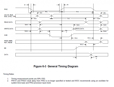

A W65C02 not being able to run at 14 MHz sounds very odd to me given that they have a 14 Mhz column on the data sheet, and their "F Max vs Vdd" chart goes up to 20 Mhz, with a little cross marked at about 19.5 MHz and 4.2 V.
Looking at the 14 MHz specs (in ns), clock pulse width high and low tPWH = tPWL = 35 min:
Data setup tMDS = 25 max, meaning that it's available at least 10 ns before Φ2↓, and tDHW = 10 min appears to give that another 10 ns after Φ2↓, so that looks no different from the 6810 case in my previous post and data is fine at 14 MHz. (I see now that all these "hold" times are actually holds from the clock edge, which makes things make a lot more sense and really does lock them to that clock edge.)
For the address, address setup time tADS = 30 max, giving at least 5 ns between the address being settled and Φ2↑. The address hold time tAH = 10 min so again, at least 10 ns after Φ2↑.
I guess I need to thank you for forcing me into the data sheets to this depth; it's really been very educational. :-)
But to the original discussion, I'm all for a thorough analysis of phi0 vs phi2 and the pitfalls to be avoided.
Ok, so using my newfound skills on the original MOS data sheet...I'm still stuck. I just can't see anything that gives any sort of relationship between Φ0 and Φ2, and all the timings are referenced to Φ2 OUT for the 650x series. (The 651x all reference to Φ2 IN because there is no Φ2 out.)
But I decided to have a look at a 1979 Synertek SY6500 datasheet I happen to have kicking around on paper, and it turns out that it does give this. (Yay!) Fortunately it's already been scanned and is up on 6502.org. The timing diagram is a full page, so rather than paste it here perhaps it's easier just for you guys to go look at page 4 of that scan.
It gives "Φ₀ Neg to Φ₂ Neg Delay" TO2- = 65 ns max (at 1 MHz), and "Φ₀ Pos to Φ₂ Pos Delay" TO2+ = 75 ns. So finally we seem to have some numbers that might tell us how tolerances change between the two. But I wonder if these take into account the much slower rise time of Φ2 compared to a good Φ0 signal.
Anyway, let's just go with Φ0 edges up to 65/75 ns earlier than Φ2 edges. The minimum length of Φ2low (ref "A" to ref "B") isn't directly given, but it looks like we can get it by adding TD = 5 min + TPWHΦ1 + TO1- = 5 min + TD = 5 min. We get TPWHΦ1 from TLΦ0O - 20 = 480 - 20 = 460, so a Φ2 high pulse is minimum 475 ns. Phew! Is that even right? Maybe I'll stop here while someone checks that and I gird myself for the next steps. And go off and read Jeff's stuff again, since it's been a while.

I certainly believe that, like many, many other parts out there, the W65C02 will run faster than the specs say it will. My question is about the data sheet strongly implying that it should run at 14 Mhz but the specs on that data sheet actually saying that it won't run at 14 MHz. I.e, the 14 MHz column is nonsense because that contains only the information that it cannot run at that speed. (If I'm interpreting you guys right.)
What is the timing issue that, according to the spec sheet, prevents it from running at 14 MHz?
PostPosted: Thu Aug 26, 2021 8:55 pm
Posts: 166
From what I can see, the W65C02S datasheet worst case timings are just about OK for 14MHz operation. At 14MHz with a 50% duty cycle, each clock phase lasts 35.7ns. For read cycles, the address becomes valid at most 30ns after the falling clock edge and the data must be valid 10ns before the next falling clock edge, so you have 31.4ns to retrieve the data from memory. If you have the RAM CS lines asserted all the time and use OE to select the RAM, this should be achievable. Write cycle timings are a bit tighter - the write data becomes valid up to 25ns after the rising clock edge, and a quick look at a fast RAM datasheet (IS61C1024) says that the RAM wants the write data valid 8ns before the rising edge of WE. So it's close, but possible.
What isn't possible according to the datasheets is to use a W65C02S CPU running at 14MHz with a W65C22S VIA also clocked at 14MHz. As already said, the CPU address bus becomes valid up to 30ns after the falling clock edge, which is 5.7ns before the rising edge. But the VIA wants its CS and RS lines stable 10ns before the rising edge of the clock.

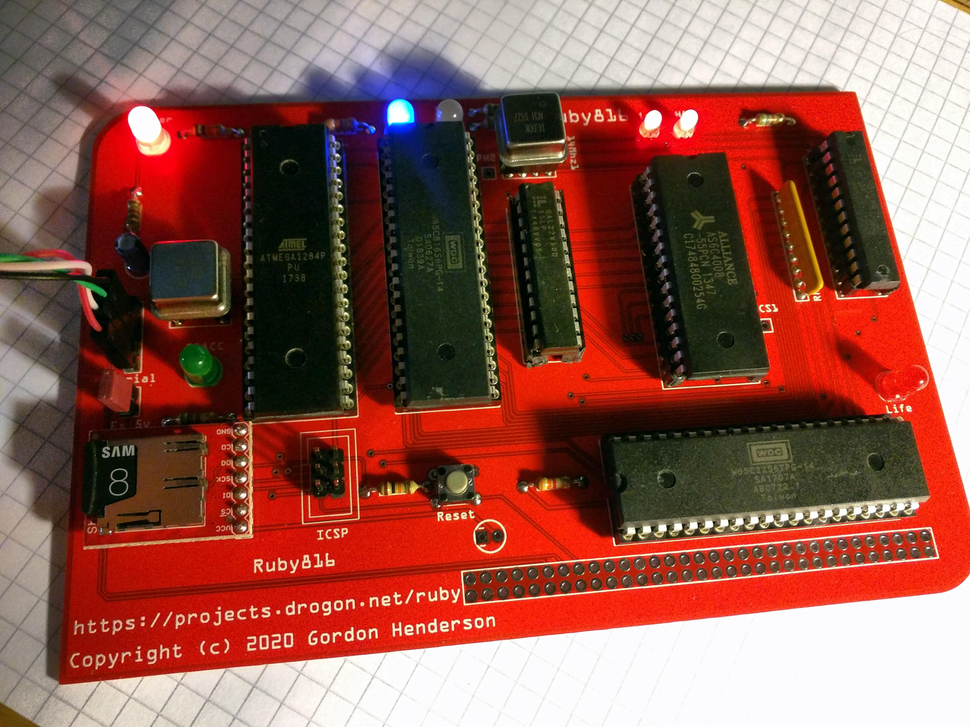

Has been running on my desk for over a year now at 16Mhz... (Ok, That's an '816 but the 65C02 on the board before it was also at 16Mhz). Sometimes you just have to suck it and see...
If you examine the FMAX vs VDD curve in the data sheet, you will see the 65C02 can run well beyond the 14 MHz rating, even without running VDD at the maximum ratings level (which is a bad idea if device life matters). From a hobbyist's perspective, that published curve can be taken at face value. On the other hand, if the C02 is to be used in a commercial product in which stability over the full temperature range is paramount, then the 14 MHz at 5 volts specification should be considered the safe limit.
WDC data sheets have a long history of publishing ambiguous or outright incorrect information. While the 14 MHz column timing values don't make a whole lot of sense when considered against the clock cycle time (~35ns per phase), WDC does guarantee that the device will run at that speed. It is likely the stated timing values are wrong for current devices and reflect the performance of the older 1.0µ geometry that WDC used years ago.
The timing values for the 65C816 seem even more suspect. POC V1.2 ran at 20 MHz, and that was with 100 percent discrete logic. POC V1.3 is running at 16 MHz, also with discrete logic. The clock speed limit is due to a sub-optimal aspect of the glue logic. According to the data sheet, neither POC unit should work at those speeds. However, observing the behavior of the 816 with the logic analyzer says the data sheet timing specs are wrong, and not by an insignificant amount.
