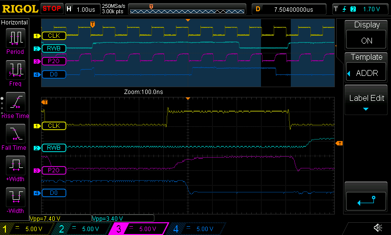

Just in case it's helpful, here's a crystal oscillator external clock to the Φ0 input (yellow) vs. 6502 Φ2 output (cyan) on an old NMOS 6502. (That's the Φ1 output in pink below.) I don't know the exact manufacturer or date of this CPU because it's been relabeled, but from the power consumption (>100 mA) it's definitely NMOS. You can see that there's considerable delay there, though most of it comes from the slow ramp-up of the leading edge; there's little delay on the falling edge.
That's from my RC6502 Apple 1 clone SBC board. I've got some more timing examinations of Φ0 vs. Φ2 vs. RWB on that board that I'll put together and post in a subsequent message, in case that provides any illumination on this topic. (Or maybe in a different topic if I'm finding myself too confused about them.)

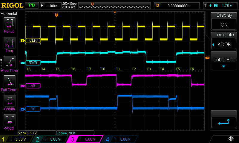

BDD, thanks for your detailed answer. Though I'm operating on the assumption that the external clock will always be clean and properly conditioned, it's good to remember that one needs to be careful to achieve this or it may affect what otherwise would be working timings. I use a can oscillator on my RC6502 Apple 1 clone SBC, and intend to continue using those on other boards.
Last week I 'scoped out my Apple 1 clone SBC to look at some of the timings related to Φ0 (the CPU clock) and Φ2 (the system clock output from the CPU). I was focusing on the data bus here. I now realize I actually wanted to be looking at the address bus, but something of a little concern to me came up with the data bus signals, so I thought I'd post this here both to get confirmation that I'm looking at these things properly and get thoughts on the data bus timing.
The code I'm using to test is a tight loop incrementing a location in memory. Below I gave the address in binary (LSB only) and hex, the data in memory and the assembly language code. I kick the machine off by jumping to $80; the loop is obviously $81-$84. The code at $85 returns to Wozmon; this is executed only if I change the BCC to a BNE to run the loop only for a short time. (I used this to test the code.)

Below the code I have the actions of the CPU worked out cycle by cycle. The details for the cycle behaviour of each instruction were taken from the MOS MCS6500 Microcomputer Family Programming Manual and then confirmed against the timing capture. The T-times above are annotated in the capture below. This is followed by another capture with A3 instead of A0 on the third channel, as that helped confirm that I was correctly differentiating between the program reads (A3=0) and data access (A3=1).
So as I mentioned, this experiment turns out not be properly set up to confirm that the address lines change well before Φ0 rises (which of course would also be well before Φ2's later rise). But it does show that the data bus appears to be changing well after the Φ0 rise on which we'd enable a write, and even probably a little after the Φ2 rise. (The latter is harder to determine because it's not a sharp edge.) Following are a couple of single-shot captures of a loop execution where D0 (which changes with every loop) goes from 0 to 1 and 1 to 0, with the third channel now showing Φ2 instead of an address line. The top-half of the capture is at the same time base as the captures above, with a selected area marked, and the lower have is a zoom in to that selected area to make it easier to see the exact relationships between the signals when D0 changes.
I see two things here that worry me.
First, RWB asserts write on cycle T3, while the CPU is still incrementing the value its read, as well as asserting write on T4 when it's writing the now-incremented value. The is not what the book says it should be doing, and this will cause the previous value to be rewritten just before the new value is written. Obviously this isn't a big deal for RAM, but it seems to me it could be problem for other devices, such as output ports that trigger an indicator to a remote device on write (such as with a 6821 PIA's control output pins in certain modes). Those might see this as two sequential writes of the old and new values, rather than just a single write of the new value. Is this kind of thing to be expected with the INC instruction, making it something that just generally should not be used for I/O unless "extra" writes are acceptable?
And second, I notice that the data lines are changing after the Φ0 rise that one might use to qualify the write, and even around or possibly after the Φ2 rise that this board uses to qualify the write. I think this is not a problem for RAM, since the proper data value will have been held for some time before the chip's select and write signals are deasserted, but I'm not totally sure about this. But again, for I/O, this could cause incorrect values to be output, even if just for brief fractions of a cycle, which seems as if it would be a bad thing, and this looks as if it could happen on any write instruction, not just the read-modify-write INC instruction. Is that something that I/O devices are supposed to be designed to be careful of, e.g. by not reading the data lines until the system clock's falling edge?
I guess I need to go back and do some further experimentation to determine timings for the address bus line and a non-RMW instruction, but I'd appreciate any feedback on what I've got so far, and any thoughts on how use of Φ0 vs. Φ2 as the system clock might make a difference to this, and whether it should make a difference to this.

PostPosted: Wed Aug 25, 2021 7:33 am
If you can, it might be instructive to recapture at a slower clock speed. I think this will show that address and control signal changes are caused by the falling edge of the clock, with the rising edge being irrelevant. On the other hand, the databus is not driven during clock low, so will be indeterminate or will hold its previous value during clock low, and then will be driven to the right value as a consequence of, and therefore a little after, the rising edge.
Of course, if the time for the address and control signals to take on their new values happens to be less than half a clock cycle, it might appear that the changes are caused by the clock rising. That's why running slower might be informative.
It doesn't surprise me to see the unincremented value written before the incremented value: I haven't memorised which RMW instructions do this, but visual6502 shows a double write and it's been discussed previously. Any given documentation might be wrong, or might refer to a different design: it was useful back in the day to have such tables of clock by clock behaviour, but they are not definitive, as you've found.
PostPosted: Wed Aug 25, 2021 8:30 am
Posts: 336
Which "book" is this? If it's talking about the 65C02, then some of the details won't apply to NMOS chips.
On NMOS, RMW instructions access the target address three times: read the original value, write the original value back, then write the new value. I don't think it was officially documented anywhere, but it's well known among demo coders, and is a key part of a popular way of acknowledging interrupts on the C64.

PostPosted: Wed Aug 25, 2021 8:46 am
Posts: 730
Location: Tokyo, Japan
I'm not clear on why a slower clock speed would make a difference here. Ought the CPU not have the same behaviour and timing constraints regardless of clock speed, so long as the speed is within the ranges on the spec sheet?
Were you perhaps instead trying to say that you felt there weren't enough samples to see the timing accurately with the current 1 MHz clock? (It looked to me as if there there were plenty, even in the small segment in the zoomed in view. It looks like I'm capturing at least a hundred samples per clock half-cycle.)
I'm also finding "the rising edge being irrelevant" comment a bit odd for the purposes of this thread, since aren't we supposed to use that rising edge to qualify things like RWB? The (not insignificant) difference between rising edge timings for Φ0 and Φ2 thus might be very relevant, depending on how early or late relative to one or the other we can be when doing things like reading the address lines.
If your comments were just all about not seeing the address bus relationship with the clocks, that's just because in the second set of captures I don't even have an address line on a probe and in the first set I've not set up the code to properly generate changes that would clearly show the relationship between the clocks, RWB and the address lines. (To do that I need to go redo this experiment to be focusing on the address bus rather than the data bus, as I think I mentioned.) But even from what's there it seems clear that the address is changing after the falling edge of Φ0, and probably after the falling edge of Φ2 (which is very little delayed from the Φ0 at that edge), and given that as far as the address lines go we're always reading around the rising edge, it looks to me as if either clock would be absolutely fine for qualifying that.
On the other hand, the databus is not driven during clock low, so will be indeterminate or will hold its previous value during clock low...
This I also find confusing. Did you mean perhaps that the data bus state is not changed during clock low? If it's never driven during clock low I don't see how it could hold its previous value, since there would be nothing driving the bus. It seems to me that if you're supposed to read the data bus on the falling edge of the clock, it must be driven for at least part of clock low or the data might vanish before the reader gets around to reading it.
Ah, so this is known behaviour! Ok, that's fair enough then. And thanks for the hint about being able to use Visual 6502 to check these things.
...it was useful back in the day to have such tables of clock by clock behaviour, but they are not definitive, as you've found.
And still useful today! I'm guessing that the description in the manual was an error or something where an update got missed when the design changed.
After the end of the write, bus capacitance will hold the data for a surprisingly long time when nothing is driving the bus
Well, I knew that, but it just now finally sunk in that of course I'm seeing the results of this in my captures above: while I can tell when something starts to drive the data bus, I can't tell when it stops because the data bus won't change much, if at all, when that happens. (Though there is an interesting little "bump" in the zoom of DB0 0→1 increment capture just after the Φ2 falling edge where the D0 level actually increases slightly (a fraction of a volt) for some reason at just the time when you would expect the CPU to stop driving it.)
At any rate, if my above timing analysis is correct, and a correct summary is "on writes the data bus will start being driven sometime after Φ2↑ and well before Φ2↓, and will stop being driven very shortly after Φ2↓," then I think I'm good with this part.
And then, getting back to the original topic of this discussion, I think we can also conclude that, given the relatively huge amount of time between data setup finishing and Φ2 falling, the Φ0 falling edge should also always be perfectly fine for indicating that data on the data bus are driven and stable and so for that particular purpose it's always safe to use Φ0 instead of Φ2. The only way I can see that breaking is if there's some stupidly long delay between Φ0 and Φ2 which would probably mean a system terribly broken in many ways, right?
