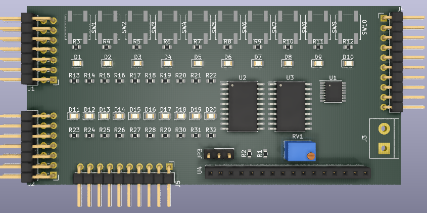

V0.1 of the board is on its way to my apartment from Shenzhen today. I'm using the latest layout to do some simple testing, but mostly physically hold the thing and decide on standoff locations, silkscreen needed, and think more critically about the backplane connector spacing. I'm a kinesthetic human, so it'll be easier with the rough version in my hands.
I'm starting to draft up expansion modules. The first actually doesn't use the bus backplane, and instead connects to the two IO Ports to provide LEDs, Pushbuttons, and an 2x20 Character LCD output port with a jumper to select 4 or 8 bit mode.
As you can see, I'm venturing into SMT parts for this card. I want to try the JLCPCB SMT assembly service, and I was able to do this design with only two "Extended Parts".
I want to get comfortable with it, because JLC has the FT245RQ as a basic part for ~$3, and it would be amazing to do a USB<->FIFO rather than an of the shelf ftdi breakout & UART. Should be able to make an RC6502 compatible FT245RQ breakout for cheaper than the UMFT254R and use a more modern USB connector too.

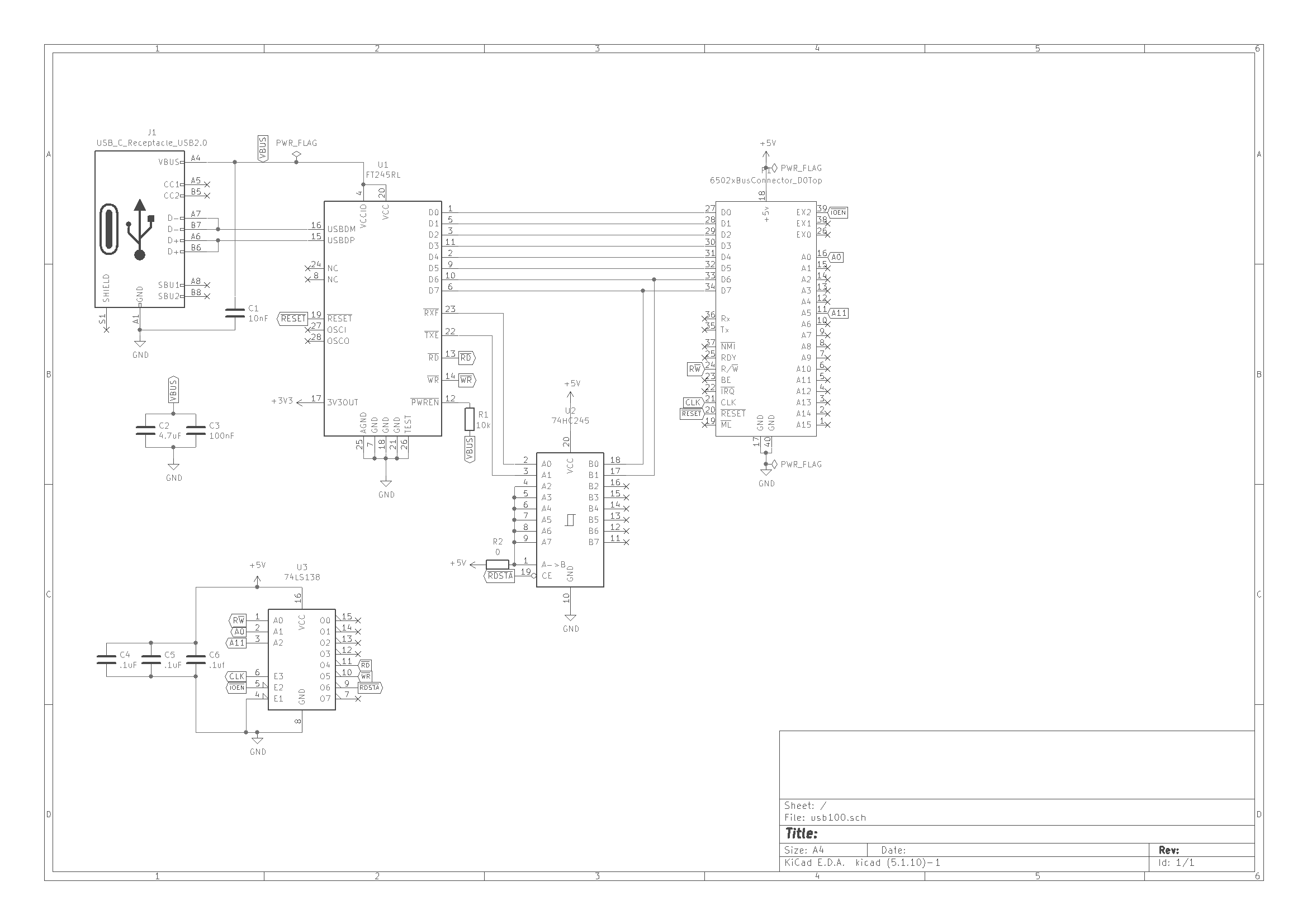

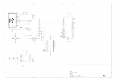

Well, I haven't gotten to the interrupts part yet, but still drew up an initial schematic that I'll probably start from.
an '138 provides PHI2 qualified /RD and /RW for the FT245R, and an /ENSTA (enable status) for the '245 buffering TxE/RxE. Right now input A2 of the '138 is drawn hard connected to A11. For the Wilson style linear decoding I'm using, I'd probably have a set of jumpers on board to pick which of A12-A4 is for the board.
I'll come back to think about interrupts this weekend, and also get my github updated with latest schematics of everything we've been discussing in this fun thread!

I'll echo what cjs said above - you are unlikely to have any use for a TXE interrupt. Data is sent so quickly relative to the speed of a 6502 that, unless you're clocking the 6502 at 20MHz or more, or the PC pauses for whatever reason and flow controls the device, you'll rarely see TXE deasserted.
Regarding your schematic, note that whereas the RD strobe is active low, the WR strobe is active high. Data is latched on the falling edge of WR, so that needs to be coincident with the falling edge of the 6502 clock.
