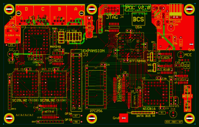

PostPosted: Sun Aug 15, 2021 7:51 pm
Posts: 8242
Woo-Hoo! PCBs in shortly then...
Got the ship notice from the board house yesterday. Now it's up to the courier...
Meanwhile, I've been fooling around with the CPLD code. I decided to go ahead and make I/O decoding more granular, which exposes more RAM between the top of the I/O block and the bottom of ROM. This version also has the ability to switch out ROM and expose the RAM underneath it. When ROM is in, a write to a ROM address will bleed through to RAM.
It all simulates as expected...which doesn't guarantee that it will actually work. :shock:

PostPosted: Mon Aug 16, 2021 12:06 pm
Posts: 1378
Nice... my last order of some odd parts came from China... they made it over in about a week. It was also free shipping on a couple interface PCBs (one tiny connector on it) and some FPC cables. Oddly, the package had USPS shipping from Illinois. In any case, hope they get here sooner.
PostPosted: Mon Aug 16, 2021 3:28 pm
Posts: 8242
The PCB order is coming in two shipments. The stencil was shipped separately from the PCBs, probably because stencils are relatively fragile and thus require different packaging.
As for the USPS thing, that's not uncommon with overseas shipments. The courier may not have the facilities for local handling your area. International shipments that travel by air will arrive at the nearest major airport for customs clearance—in your case, it sounds as though it was O'Hare in Chicago. The courier will then turn the shipment over to the postal service to cover the domestic part of handling the package. Given the labor problems that USPS has, that part of the process is probably the riskiest. :roll:

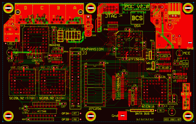

PostPosted: Mon Aug 16, 2021 5:51 pm
Posts: 197
Has something changed in the clocking ?
The schematic has PHI1 to PIN 2 and PHI2 on PIN 43
File comment: Schematic snip
The CUPL seems to have them the other way around:
pin  43                   = PHI1;          /* input   system clock (phase 1) */
pin   2                   = PHI2;          /* input   system clock (phase 2) */
PostPosted: Mon Aug 16, 2021 8:05 pm
Posts: 8242
You, sir, are commended for your powers of observation. :D :D :D
I changed that around after I had posted the schematic and board layout. The CUPL code is correct.
PostPosted: Sat Aug 21, 2021 5:39 am
Posts: 8242
Well, I received the stencil, but no sign of the PCBs. They were supposed to show up Friday.
PostPosted: Sat Aug 21, 2021 8:29 pm
Posts: 197
Well..... I have a reason for following along the design closely:
File comment: POC2 and a bit
The lower 2/3 of the board is basically the POC2, the upper third has all the I/O from a recent Z180 build. Left to right Wiz810s Ethernet header, 82C55 & IDE header, 2 chip VGA Video solution, and dumb keyboard port.
Ive been looking at building a 65816 board with BBC basic for a while, your clock stretching circuit solved the problem of limiting the speed to that of the slowest I/O components, the Z180 didn't have that problem as it has a build in wait state generator. The big advantage the 65816 has over the Z180, is no MMU to deal with and no restricted 64k visible at any one time memory.
The I/O from the Z180 build needs 4 I/O selects that also fits within the POC2 7 device memory map. So basically with the CPU, clock stretching, 128k ram and CPLD memory mapper, I had 70% of a POC2 anyway so I added provision for the serial connections.
The PCBs arrived on Monday, and as I was preparing to get the SMT stuff soldered in place, I discovered a major boo-boo in the layout. :oops: The board is electrically correct but the footprint I used for the 'AC245 transceiver was wrong. It has the right number of lands but is the wrong package width. Below is the incorrect PCB layout. The mistake is with U4, which is located at the southwest corner of the 65C816 socket.
File comment: V2.0 PCB w/Wrong Component Footprint
I thought it might be possible to scab the transceiver in place by reforming the leads, but that won't fly due to the part being too wide relative to the layout footprint, as well as being jammed up close to the 65C816's socket.
Having discovered this little contretemps, my only recourse was to fix the board layout and place another order with JLCPCB. Below is the repaired layout. Since I was forced to a do-over, I made some other layout changes as well. Let's see if any of you who read this can spot those changes.
File comment: V2.0 PCB w/Right Component Footprint
Supposedly, I'll have the new PCBs and stencil on Thursday. It really tees me off when I make a boneheaded blunder like that. :evil:
Oh, what the hell: it's only money! :twisted:
PostPosted: Mon Aug 30, 2021 5:43 am
Posts: 8462
Would the '245 fit if you were to J-lead it? Hopefully the leads would not break in the effort. I know there was some kind of tool to do a good job of it very quickly, but I've never seen one.
I know you said you already ordered the revised board though.
PostPosted: Mon Aug 30, 2021 6:51 am
Posts: 8242
There's just too much of a difference between the part's width and the footprint's width to make that practical. The amount the pins would have to be reformed to land on the lands would leave almost no pin surface exposed for soldering. I had unpleasant visions of a DOA unit due to a soldering issue. That's what prompted me to fix the layout, bite the bullet and order new boards.
Of course, the stencil I got with the bad boards is useless as well. I ordered a new stencil to go with the new boards so I can try my hand at reflowing a second unit once the prototype has been built and made functional.
This is the first board layout that I have goofed up in over 10 years. Maybe old age is to blame. :D
