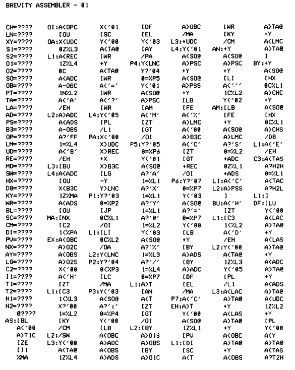

The book looks quite interesting, and is definitely one I wish I'd known about and had back in the early '80s. For those curious as to what BREVITY looks like, here's the first page (of three and a bit) of the BREVITY assembler listing.

Curt, thanks for the page. That's awfully cryptic. It's apparently actual source code. Is there an interpretation?

Excerpted from the book:
Because of the rather terse, mathematical nature of its statements, we call our 6502 assembly language BREVITY.
Everything about BREVITY is designed to minimize memory requirements and typing.
However, we also feel that terse, mathematical statements promote readability, which is one of
the more difficult things to achieve in assembly language design.
In small installations, no comment statements are permitted in BREVITY programs.
Instead, some standard methods of developing separate documentation are proposed.
In BREVITY, labels denoting hexadecimal addresses consist of precisely two alphanumeric characters.
Since this means there are only 36 x 36 = 1296 possible labels in all, we allow labels to be redefined within a program.
This has a profound effect on (1) assembler design and (2) reducing overall memory requirements.
These topics are taken up in Chapter 6.
No arithmetic expressions involving labels and addresses are used in BREVITY.
We believe that such expressions are not warranted in terms of their utility in systems programming.
Since there are no comment statements nor arithmetic expressions, the longest statement in BREVITY is only eight characters.
Specific operations and conditions are generally represented by a one-character symbol, as in mathematics.
In almost every case, the one-character symbol chosen is already semantically related to the operation or
condition denoted in applied mathematics, at least in the author's experience.
Hopefully, these associations will be palatable to the reader as well.

Well, perhaps no more cryptic than standard 6502 assembler mnemnonics are to the uninitiated.
Earlier chapters in the book explain the language and the whole chapter leading up to this explains how to write an assembler, so I presume that would be all you'd need to understand this source listing at the end of the chapter. The book's on my to-read list, so I may go do a writeup at some point after I get around to reading it.
In the meantime, I know that labels are no more than two letters, so clearly the `XX:` bits are labels, and I'd guess that `+Y` is INY and maybe `Y<'01` is LDY #1, A?'S' is CMP #'S, and the `1=` and `0=` bits are BEQ and BNE, or something along those lines. And I seem to recall seeing some punctuation prefixes for various addressing modes.

Yeah, at first glance it's actually kinda neat, I think. "Terse" is probably a better adjective than "cryptic". It even mentions comment and macro capabilities. The book is full of source examples for useful tasks.
@0200 means ORG $0200
/L3 means JMP L3
[PR means JSR PR
] means RTS
. means RTI
0C means CLC
-X means DEX
A<X means TXA
A<'00 means LDA #$00
A>C1X means STA C1,X
A>IN@ means STA (IN),Y
0=%L1 means BNE L1 (forward reference)

It should certainly be possible to hand-assemble the source code given... it might even be possible to rig up a quick and dirty nearly-assembler to deal with the source code given - it only needs to be nearly right, to assist in making a binary for this code, at which point it can assemble itself.
I think this would be a very nice resurrection project.
