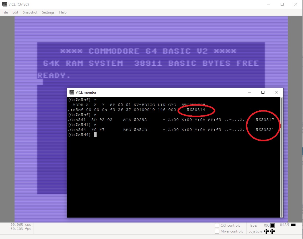

What tools are available for counting cycles? I'm interested in comparing the performance of different implementations of a subroutine, but I don't want to count cycles by hand because I'm likely to make a mistake.

Some emulators do that. Vice for example.
