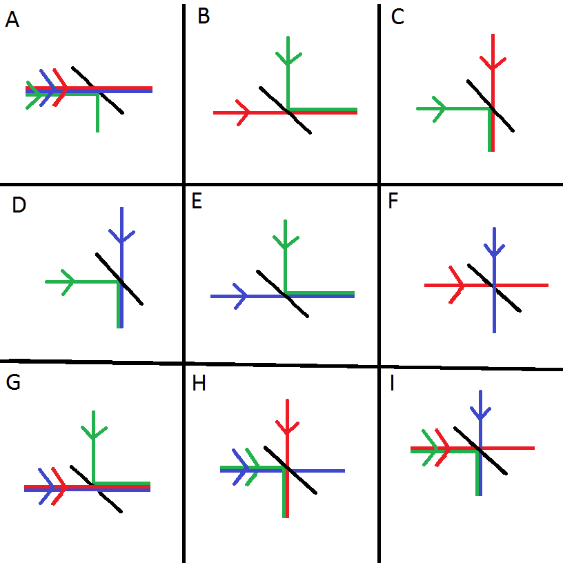

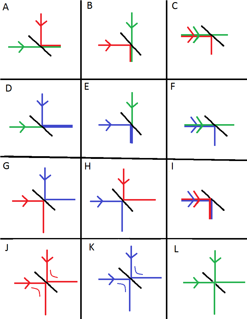

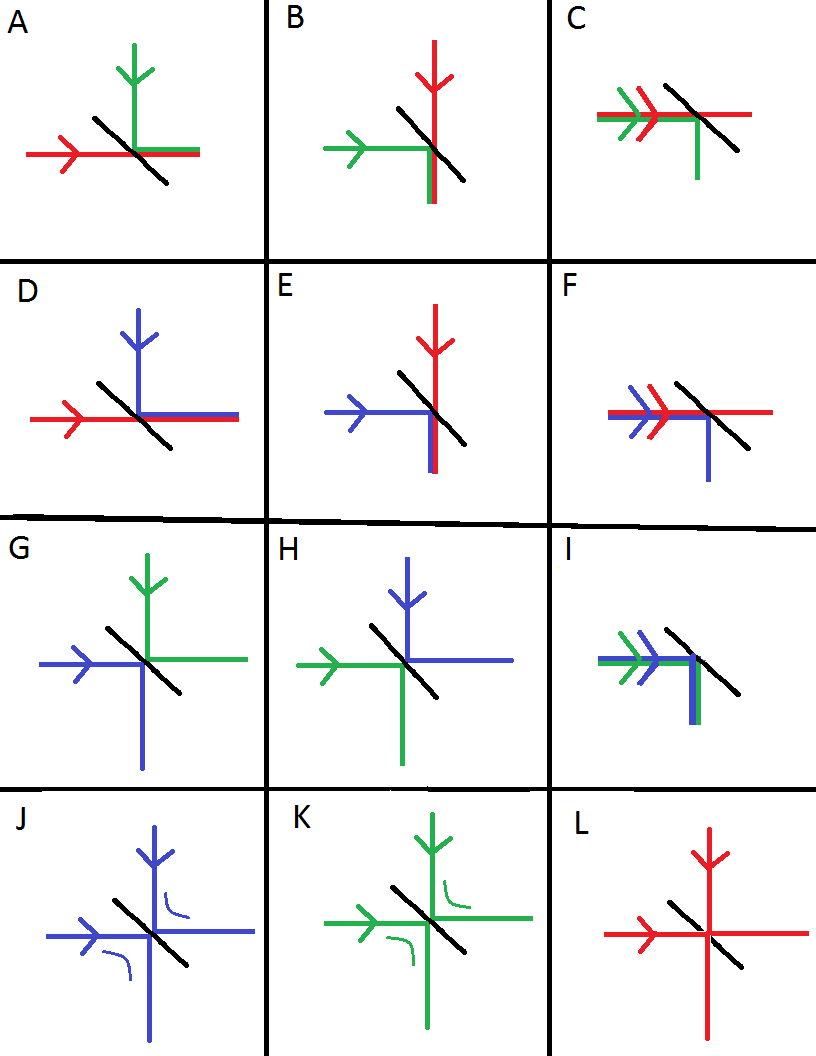

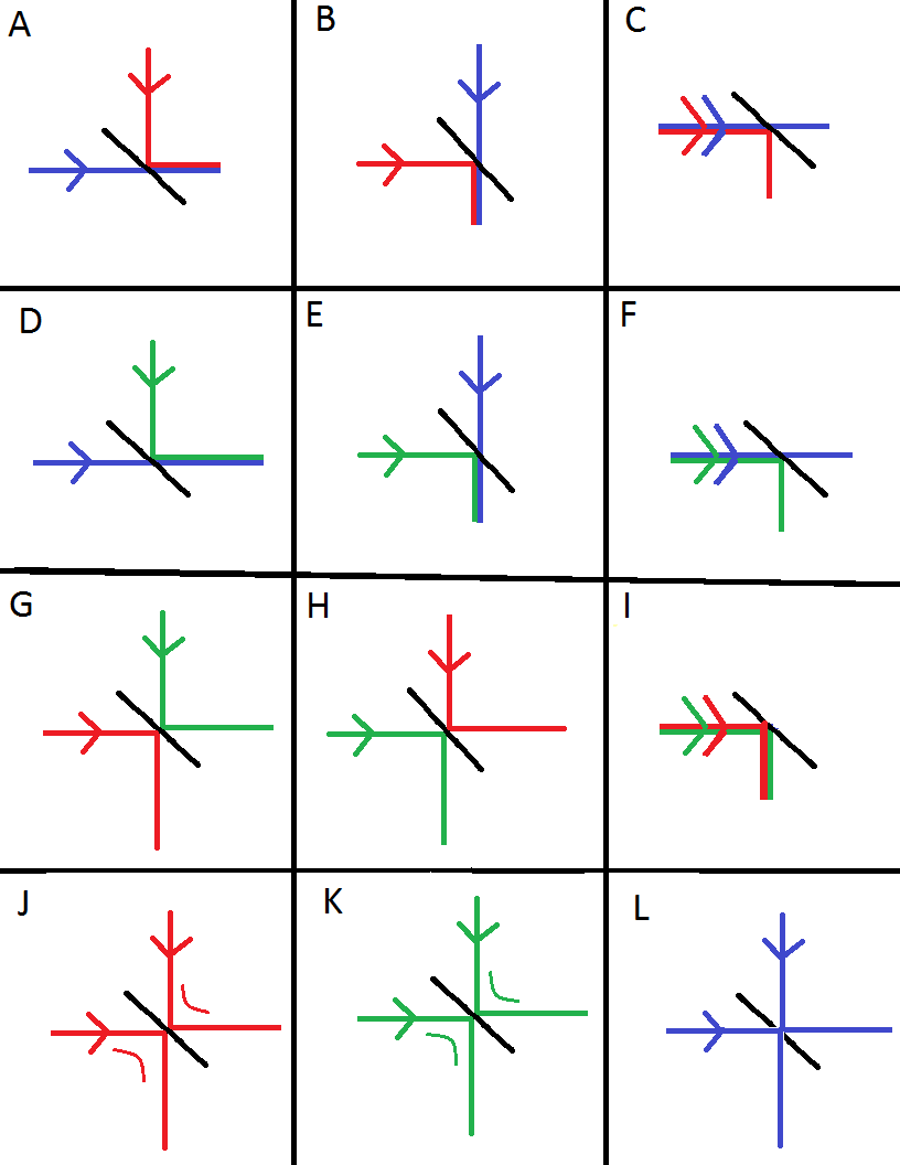

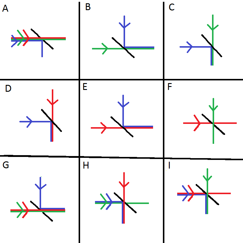

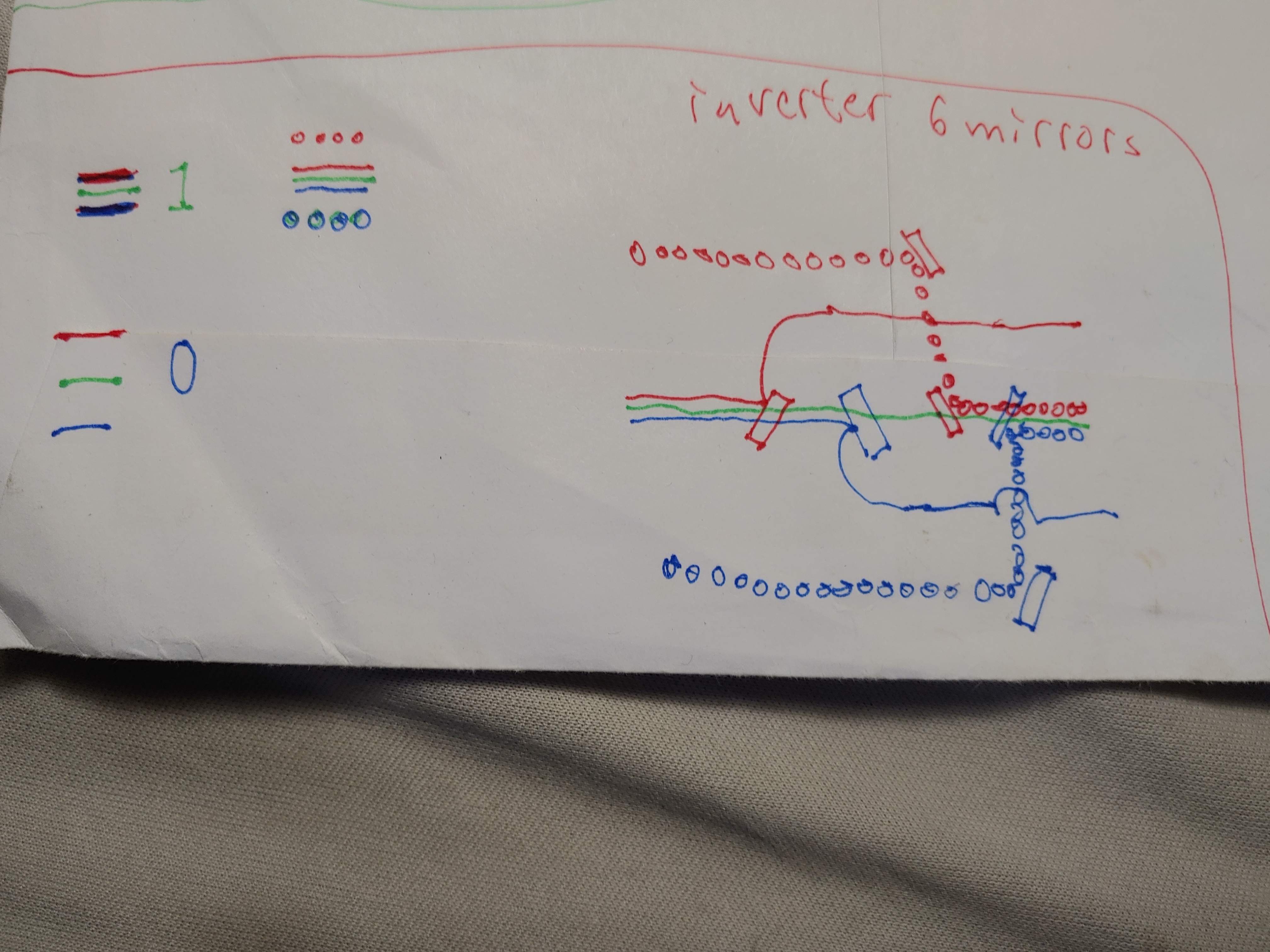

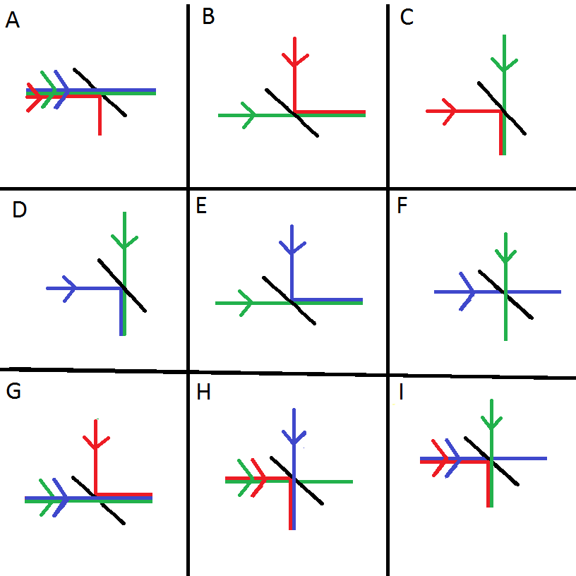

Logic available with dichroic mirrors, in their simplest arrangement.
Note there are 6 different devices ; 3 Reflect ONLY one color. 3 Pass ONLY one color. And are named accordingly, Rpass Gpass Bpass and Rref Gref and Bref.
A few other notes on the project. Technically, all combinatorial logic can take place with EITHER ( NOT + AND gates), OR, (NAND gates) OR (XOR? gates. I think?). It's called functional completeness. I think Charles Sanders Peirce was one of the first to describe this. I think he even mentioned electrical implementation in a computing-like device, circa 1880.
But sequential logic ... Sequential circuits, might be trickier. Especially with light. It's hard to trap light in a jar; whereas electricity was literally first trapped in a jar circa Leyden jar and Moeschbroek? and, later, with foil inside the jar and the water out, by John Bevis circa 1740s? 1750s.
Also I'd be curious to know the "maximum path length" a signal takes in a 6502, NMOS or CMOS, from input pin to output.
Like, how many transistors, maximum, a signal passes through from clock cycle to clock cycle.
I was watching a Bill Mensch interview recently and he mentioned a flow diagram that illustrates for each of the 151 valid opcodes, exactly what each op code is doing at each stage of the 7 subdivisions of the full clock cycle. Anybody have a copy of that?
It's important. If I want to use all dichroic mirror sorting/routing for all combinatorial logic, and I have only 99% or 91% efficiency, and a 5 mW signal, 1000 or 3000 reflections might be detrimental. 100 or 200 might be better. I dunno? Could be a "deal-breaker"?
If anybody knows some good info or hints in this id appreciate a "heads up".

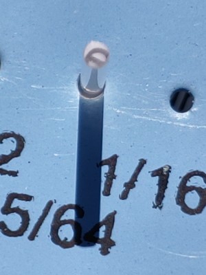

My fiber optic Image Conduit vary from 5/64", to 3/32", to 7/64".
I tend to use the 3mm. ( 2.78 mm ; 7/64") and I am pretty certain it is 3000 fiber with 25 micrometer ( um) core.
The microlens array I hope to use is 20 x 20 lenses, I think. At 250 um. spacing. I think. If anybody has a line on a cheap microlens array, PM/DM me.
One sided, convex, one side plano, array.
Here is a picture of one FOIC, reasonably well polished, transmitting a typewriter "e" about an inch upwards. The FOIC is being measured by a English units screw-xhecker.
Each traverse of the signal through the FOIC sees 60% reduction from end to end.
Insertion loss and exit loss might be significant to.
Minor inconsistencies in fiber core placing might necessitate (1) microscope pictures and (b) custom made microlens arrays.
Beam diameter of the laser pointer is probably 3 to 5 mm. I haven't measured it. This should be fine for the microlens array and insertion into the FOIC, or even sectioning by the nipkow disk.

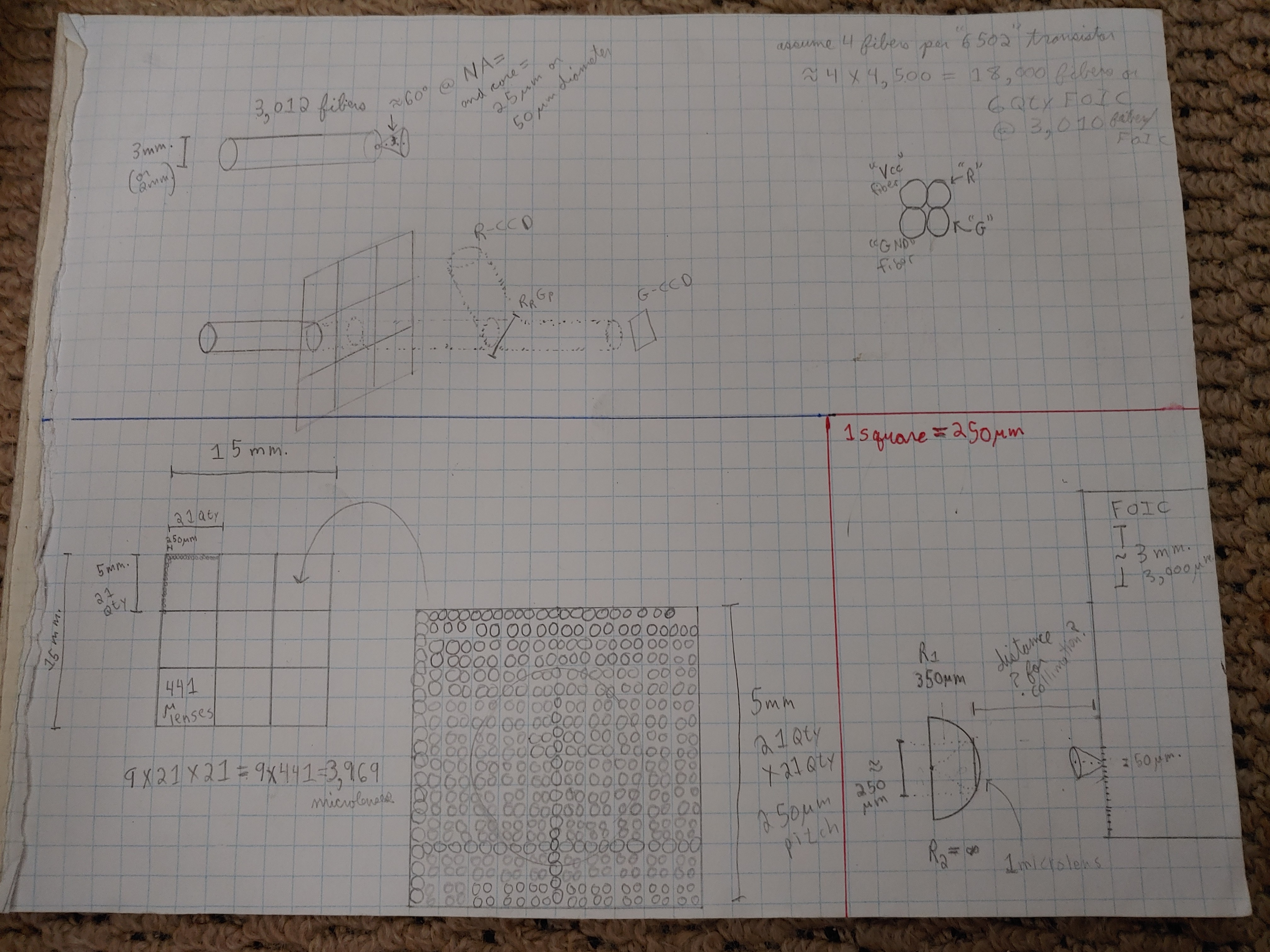

I sort of wished I'd written the date on this? Some time after March or April, but we'll before July 14th, when I got serious about microlenses, DMDs and Nipkow disks.
And I have another diagram, about a week or month after this first one, trying to imagine an implemention of a DLP, and with the specs on the cheapest one.
The one I presently have is ready to be programmed and attached to a raspberry pi and used as a TV wall projector.
The data schematic lists an array of 640 by 360, sub-VGA but still pretty nifty. They tilt from + 11 ° to -15, I think?
It presently outputs light, but I think I might want it to modify my "bulk laser" to feed the initial signal into the microlens array and thus FOIC, and with a second microlens array, bounce it off the dichroic, or several dichroics, and then try to capture some of the logic thus done, with either a CCD/CMOS, or some other means.
For sequential logic, the combinatorial logic done in the first "pass" through the optical system must be held and fed into the second pass.
I am assuming all signals must be boosted again?
But I count this no deficiency. Perhaps CCD can feed right back to DMD and the bright, hot lasers can do their magic on a second pass?
Perhaps this solves the problem of no flip flops or latches in light?
