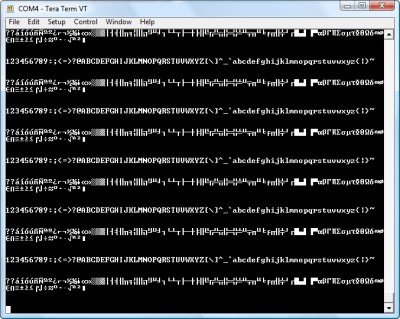

I tried the JMP instruction that wrap around 64K boundary. the W65C02 works at 33MHz but failed to execute correctly at 34.5MHz. Screen capture shows when it is operating properly.
I'm driving the W65C02 directly with the output of the can oscillator. I'll try buffer the oscillator output with the CPLD and drive W65C02 with output of CPLD which has faster rise time.

By buffering oscillator output with CPLD, I'm able to run W65C02 at 36MHz, but I noticed it will crash when voltage is lowered to 4.6V, so it is nearing the edge at 36MHz. By raising voltage above 5.3V, I can run successfully at 40MHz, but that's definitely outside of the commercial operating voltage. All tests are done at room temperature.

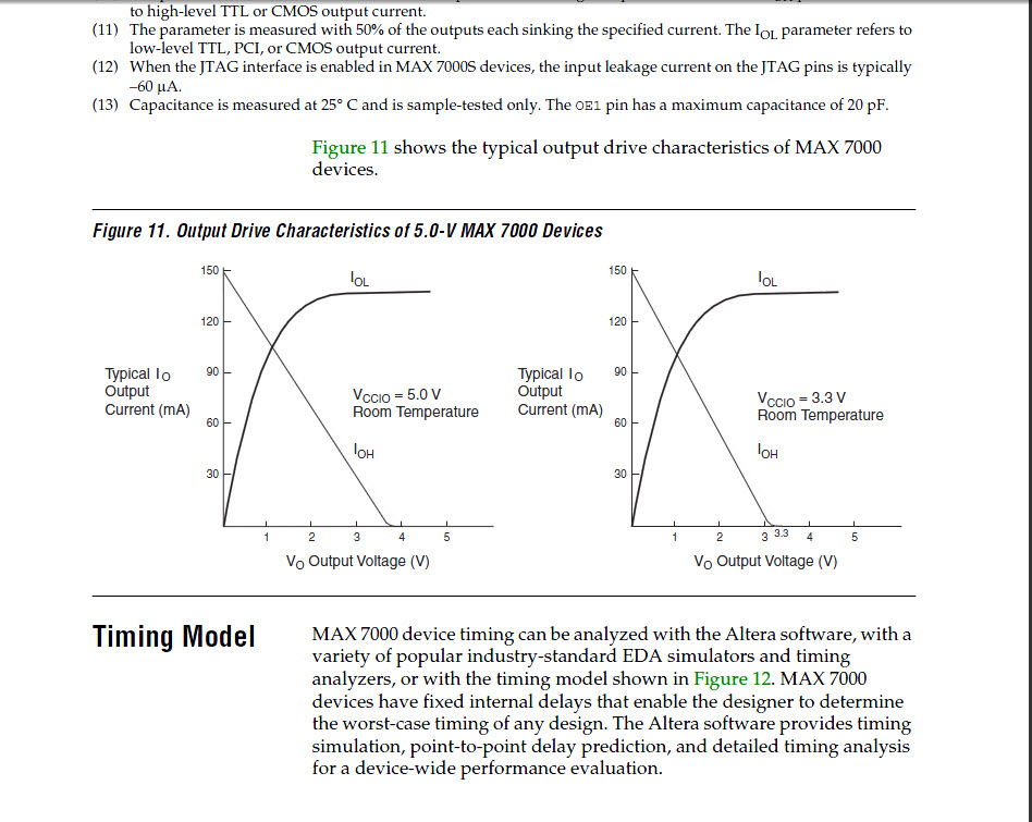

Are you aware that the CPLD's outputs are likely TTL-level, not CMOS? The 65C02 expects to see CMOS levels on Ø2. Try sticking a 74AC04 or similar in there to boost the clock output, with a metal film resistor on the AC04's output to mitigate ringing—100-120 ohms is a good range to start. The 74AC04's output swings rail-to-rail and has a very short transition time, things that the 65C02 wants to see on Ø2.
PostPosted: Sat Jul 31, 2021 5:05 am
Posts: 1076
On paper EPM7000 has TTL level output, but its output drive VI chart shows it drives to 3.75V. Scope measurement shows it drives to 4V, hard, at room temperature. Probably too fast, so 100 ohm serial source terminating resistor is a good idea.
Edit, attached graph is from EPM7000 datasheet
