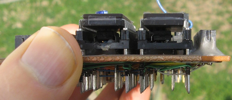

Here is my wire-wrapped version of Garth's design, using 3d-printed sockets.
Only the big sockets are homemade. The pic was taken before I added the crystal (I am taking 10MHz from Daryl Ricter's SBC-4, upper left).

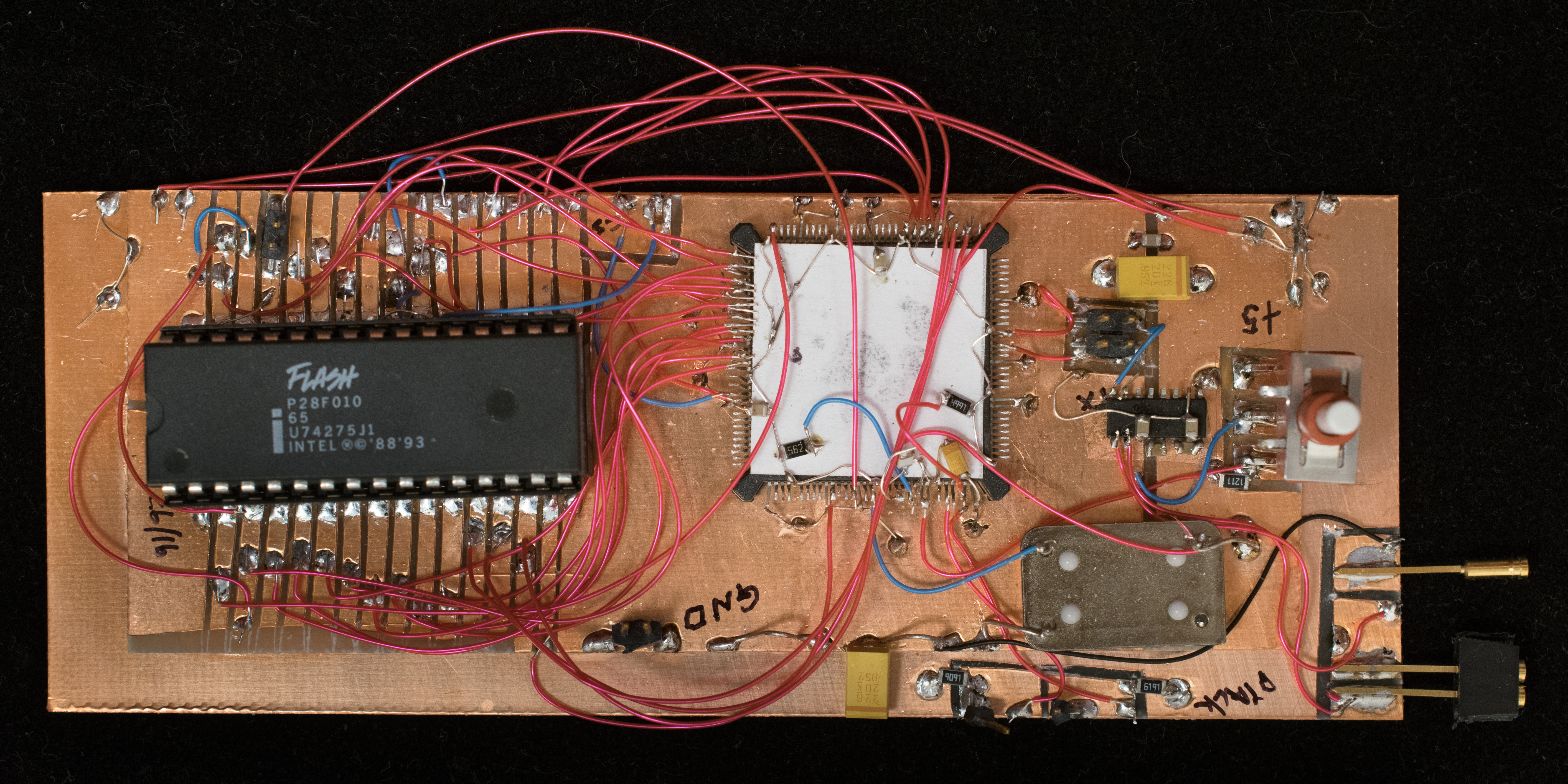

Single-sided copper clad pc board is an inexpensive medium for prototyping. The copper foil is a great ground plane, and you can score and peel off copper foil with a X-acto knife to form isolated area. I built this prototype 68302 SBC on single-sided copper clad pcb using salvaged 68302 quad flat pack and piggy-backed RAM/EPROM. The ground pins of 68302 were bent down and soldered to the copper foil while VCC pins were bent up to form a ring in the center of the package. The rest were point-to-point wiring with 30 gauge wirewrap wires. The clock was 16MHz but this type of construction can run 30MHz+ without problems.
