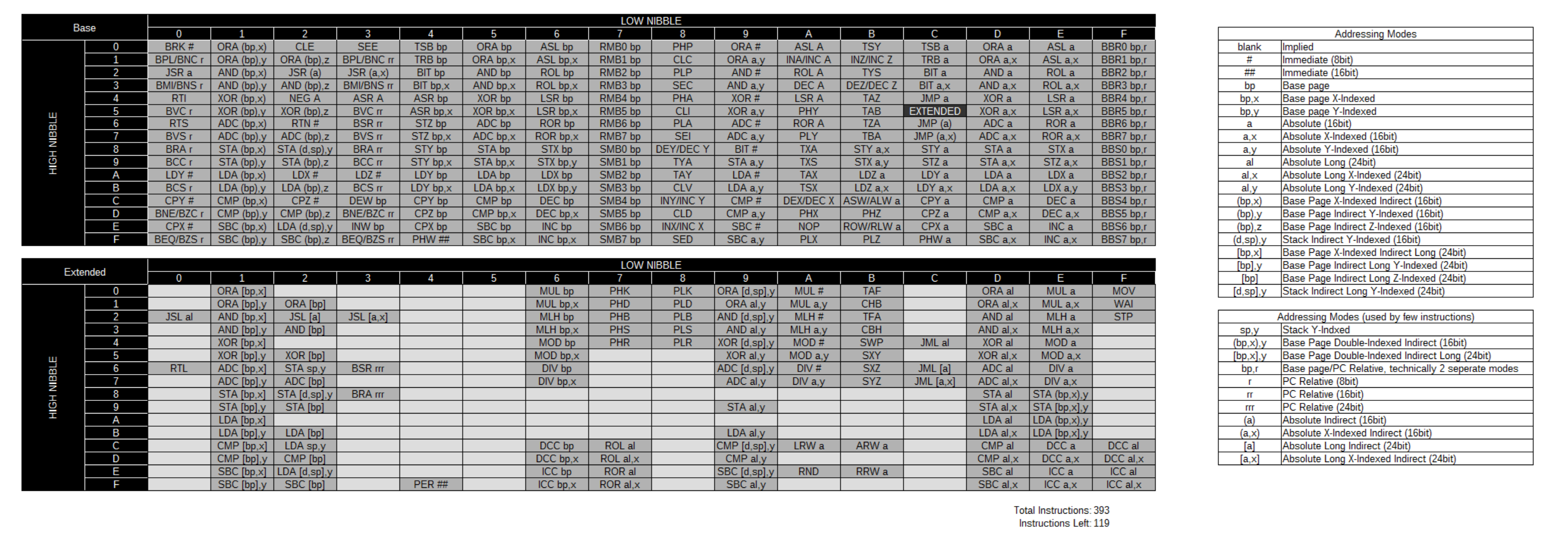

for the actual Addressing modes i was thinking of these:
  • Absolute Long
  • Absolute Long X-Indexed
  • Absolute Long Y-Indexed
  • Base Page Indirect Long Z-Indexed
And the instructions that make use of those are be: LDA, STA, ADC, SBC, AND, ORA, XOR, CMP, INC, DEC, ICC, DCC, ASL, ASR, LSR, ROL, ROR
note that INC, DEC, ICC, DCC, ASL, ASR, LSR, ROL, and ROR only use the first 3 Addressing modes. (which is still more than the 65816 allows)
in total this would add up to 43 new Instructions plus any miscellaneous Instructions like Long (and maybe Indirect Long) versions of JMP/JSR/RTS, Push/Pull, Special Loads/Stores, etc
Overall i'm really warming up to the idea of extra Addressing Space, with the way i have it in mind only the new Instructions i were to add would actually interact/modify any of the new registers, all of the existing Instructions would just work like normal without requiring some rewrite/rewiring. I'll make a copy of the Logisim Version and see if i can modify the circuit to allow for Bank Registers and all that.
though i'm still not sure if an Emulation mode is necessary, the only difference it would have to Native mode is how many bytes Interrupts and BRK push onto the stack, and how many RTI pulls from the stack.
so i'm kinda thinking about saying "screw it" and not implementing an Emulation Mode at all and just hope there aren't many programs that use Interrupts, BRK, and RTI in some weird way that only works with 16 bit addresses.
  • Absolute Long
As you know, using a single prefix you'll only get 256 new opcodes. I suggest you spend these on providing plenty of long address modes, even though you'll have fewer instructions that can use those modes. LDA and STA are important, and will get used frequently, but IMO there's no need for dozens of instructions to have long address modes.
In particular, I suggest adding more long indirect modes, including both a non-indexed version, a version that indexes using Y, and a version that indexes before the indirection -- ie, x[ind] mode.
Indirect address modes are central to 65xx, simply because 65xx has no full-width pointer registers on-chip. It's indirect pointers that grant you full freedom to compute addresses at runtime! So, I suggest you make the most of that when you expand to a 24-bit address space.

alright, small inbetween update.
Feature creep kinda got me in it's fangs for some time.
basically i changed the Address ALU and added the extra Registers required for 24 bit Addressing, but i also wanted to have an extra Flag that would allow the PBR to change with the PC whenver values are added to the PC (like through relative jumps or normal program flow). this flag is called "w" for "disable PC wrapping".
problem was that i needed to put the flag somewhere, but i don't like the 65816's way of stacking flags ontop of eachother, so instead i just added a new Status Register which is internally called "FL1" for "Flags 1".
but just having a single bit in there seemed a bit lonely, so i also implemented priority Interrupts (IRQ0 (highest) - IRQ7 (lowest)) and also a new flag that switches between all IRQs (and BRK) sharing the same Interrupt Vector (for backwards compatibility), and each of them having their own seperate Vector.
And now i'm currently in the process of reordering all extended Instructions to better line up with the base instruction set.
my unused Opcode count went from 204 to 125 (79 new Instructions), though that could still increase by 6 since i recently saw that the 65816 has the Stack Indirect addressing mode for ADC, SBC, AND, ORA, XOR, and CMP... though i fear that might just be feature creep whispering into my ear again, telling me i need more instructions

the second Flags Register can only be effected by it's Transfer Instructions (TAF and TFA), and IRQs (bits 1-3 change to the priority of the last IRQ that occurred). i thought that this Register would be rarely changed (at most it's only read out in an ISR to see what the IRQ's priority was) so it would make little sense to put it on the stack during an Interrupt.
There are eight altogether -- you've omitted LDA and STA.
Is the Stack Indirect addressing mode a case of feature creep? I wouldn't say so, but that's just a reflection of my own goals and priorities.
i didn't mention LDA and STA because the base 65CE02 already adds those. so i would only need to add that addressing mode for the remaining arithmetic/logic instructions.
and they do seem really really useful for using pointers in functions without having to grab them off the stack and putting them on the base page.
hmmm...
Indeed, if it were my project I'd be tempted to go one step further and add Long Stack Indirect addressing mode!
the funny thing is, i already did. though it's limited to LDA and STA.
I really want to add these Addressing modes to ADC, SBC, etc but that would be an extra 12 Opcodes.
I wonder... what if i were to only add the Long (ie 24 bit) Stack Indirect Addressing mode for ADC, SBC, etc. and just leave out the 16 bit version entirely? (except for LDA and STA of course since they are the in the Base Instruction Set)
it would save me 6 Opcodes at the cost of an extra byte on the Stack for every pointer and slightly slower cycle times.
also one noticable difference would be that Long Stack Indirect Addressing doesn't wrap at 64k boundaries, while Regular Stack Indirect Addressing does.

I have uploaded an Updated Opcode table with all Addressing Modes on the side.
none of the new Instructions are explained in the image, but most of them are just existing instructions with new Addressing Modes or are just taken from the 65816 and function pretty much identically.

If it was my pen and paper, I would attempt to support data structures that are greater than 64kB in size. The easiest way to do that within an HLL is to provide "linear" addressing rather than the mod 65536 manner in which the '816 provides for such data structures. It's not that it can't be done, but it is a bit difficult to manage efficiently. In my core, I did not increase the address space except through a paged memory management scheme similar to that which I used ages ago on my PDP11/24 minicomputer. (I wouldn't want to attempt the paged memory management system of RSX-11/M that I used for creating and maintaining programs greater than 64kB in length.) I support both 8-bit offsets and 16-bit offsets into the stack, and so the programmer does not have to manage the selection of the offset / base address, I do those selections in the compiler.

that's exactly the reason why i want to omit the 16 bit Stack Indirect Addressing mode, it would limit you to the current Data Bank while the 24 bit one can point to anywhere in Memory.
and technically the CPU has a linear address space, if you set the W Flag and exclusively use the Long Addressing modes instead of the Absolute ones (which excludes some instructions like ASL/ASR/LSR/INC/DEC), then it should be pretty close to a 68k in terms of Memory linearity.
