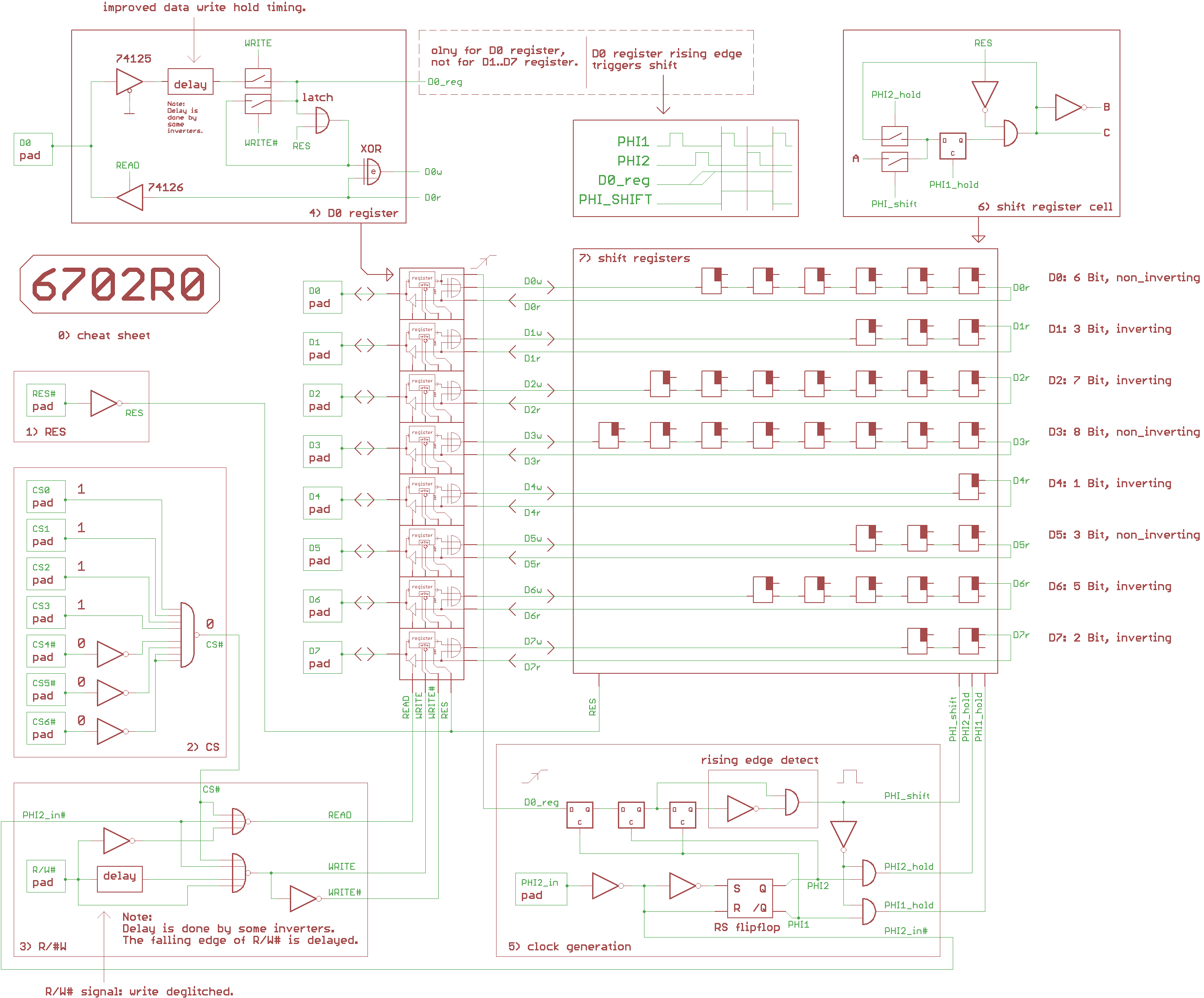

This thread is about a transistor level dissection of the 6702, SuperPET dongle chip,
The 6702 bus interface only has one Byte.
There is a shift register tied to every Bit of that Byte,
length and output polarity of the shift registers does vary.
Reading the Byte means reading the outputs of the 8 shift registers.
When writing a Byte to the 6702 data register,
data register outputs and the shift register outputs are XORed and fed into the shift register inputs.
After a 0 to 1 transition in the D0 data register Bit,
all of the shift registers are shifted by 1 Bit,
and that's basically it: security through obscurity.

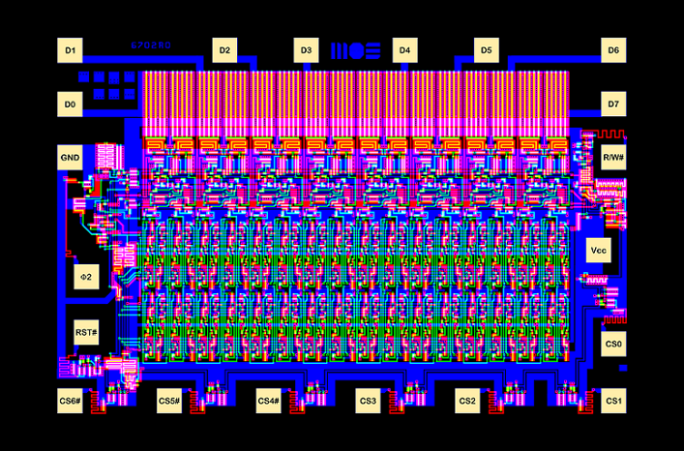

0) cheat sheet
A very simplified schematic to give an overview about what came out during the dissection.
A picture of the 6702 silicon, with the interesting areas marked according to the cheat sheet.
Note the yellow and orange boxes:
These are 64 shift register cells, one Bit each.
From West to East, the layout of every second shift register Bit cell is rotated by 180°, we are getting there later.
Just as a reference, another picture of the 6702 silicon without the markings.

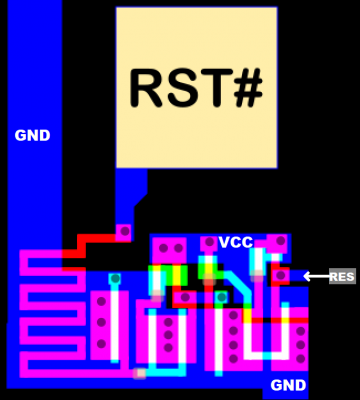

1) RES, located South West.
The low active RES# signal goes through an inverting super buffer, then through an inverter, then through another inverting super buffer,
and becomes the high_active RES signal.
