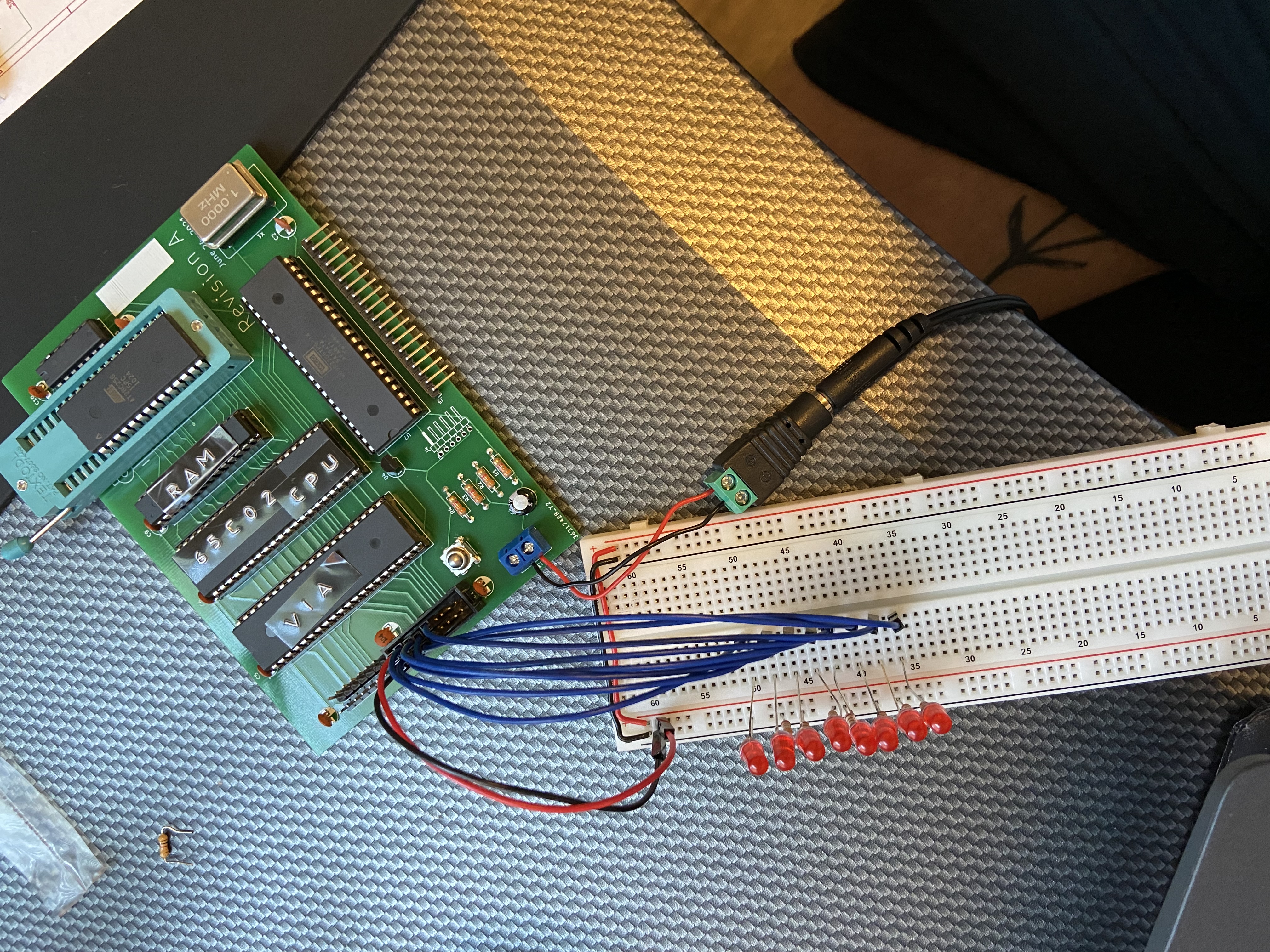

I much appreciate the help! Yes, the goal right now would just be to turn on all of the LEDs and keep them on after reset.
I'm attaching a photograph of my setup, but yes, that's how I have things wired. the resistors are soldered directly to the cathode of the LED. The VIA out is connected to the anode through a breadboard. I have verified each LED functions when connected directly to +5.
BTW - there's unfortunately a certain small risk that the little accident you mentioned re the ROM and the ZIF may have damaged the ROM. We'll have to wait and see. :|
Well, on a whim I grabbed another ROM (from Jameco, definitely used, I read it before writing and "Hello World" was there clear as day) and programmed it with the same program. Now, when I power on / hit the reset button, the LED connected to PB7 lights up for a brief moment and then dims again. I programmed a third ROM, with it, nothing visible on the output.
All of these chips worked on the breadboard, but that doesn't rule out anything going wrong in the two prototypes since then causing damage. I only have a second 65c02, but several dupes of the rest of what I need. I probably should keep testing continuity before I pull the only other CPU i have out of its antistatic.
EDIT: adding the photo...

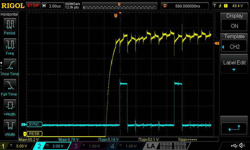

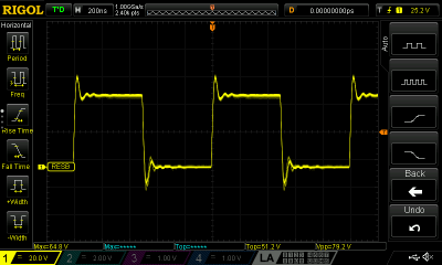

Alright, so I now have a Rigol 4-channel DSO in addition to my cheapo logic analyzer. I'm pretty new with the thing, but I've at least learned about different triggering modes and basic operations. Before I start uploading a pile of screenshots I wanted to think through the appropriate tests.
It seems first things first would be making sure that I can read NOPs out of ROM. To do this, I would put the logic analyzer (at the highest resolution possible) on the lower eight address lines (?) - and the scope on CLK, SYNC, and ROMSEL. I should see CLK doing its thing, ROMSEL every second cycle, and binary counting on the address bus?
If this succeeds, next up is going back to my solid-LEDs-on program, scope on CLK & IOSEL. Here I want to see IOSEL low BEFORE CLK falls. I should probably adjust the program to continuously write the same value to the 6522 registers (instead of writing once and then NOP looping), so it's easier to catch on the scope.
Am I thinking the right way? Should I keep using my 1MHz can oscillator for these tests, or switch to an arduino toggling a pin a little more slowly? I'm thinking it'd be more educational to stick with the oscillator and learn to use the scope at speed.
Okay, now that I documented that, it's time to dig in and see what I can see. But if I made a misunderstanding of what I'm looking for, advice is appreciated. Thanks!
EDIT: attaching two scope traces, the first is RESB and SYNC on hitting the reset button, the second is just the clock right at pin 37. My only IC grabbers have pretty long wires on them before they get to the probe, so I think some of the bounce is just from that. But it does look like reset is rising quickly enough...I think...

I don't have a scope and I'm not sure how you have yours set up but is your reset signal reading 50+V? almost 80Vpp??
John West
Posts: 383
Joined: 03 Sep 2002
Re: The F-1 (aka "I Was Too Excited to Draft the UART Circui
Post by John West »
My guess: the probe is set to 10x attenuation (almost always what you want for this kind of work), but the scope hasn't been told about it. So that's actually only 5V.
Edit: Oh wait, no. Probably the other way around.
