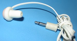

It really is a small world. And, I remember those earpieces - the white ones. Something like this:
I was also 8 or 9. And, yes, when the station, any station, actually came in - it was like magic.

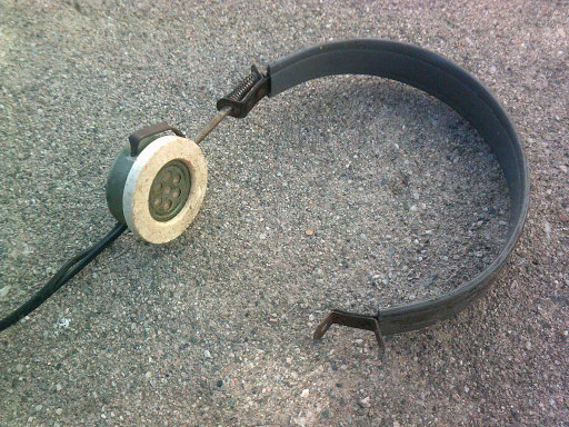

Re: Best Soldering Tools for Beginners?
This was my first one, which I just pulled out of a closet. I mounted it on an old Telex headband of unknown source. Wow, it's pretty grungy now. I'd definitely want to clean it up before putting it back on my head!

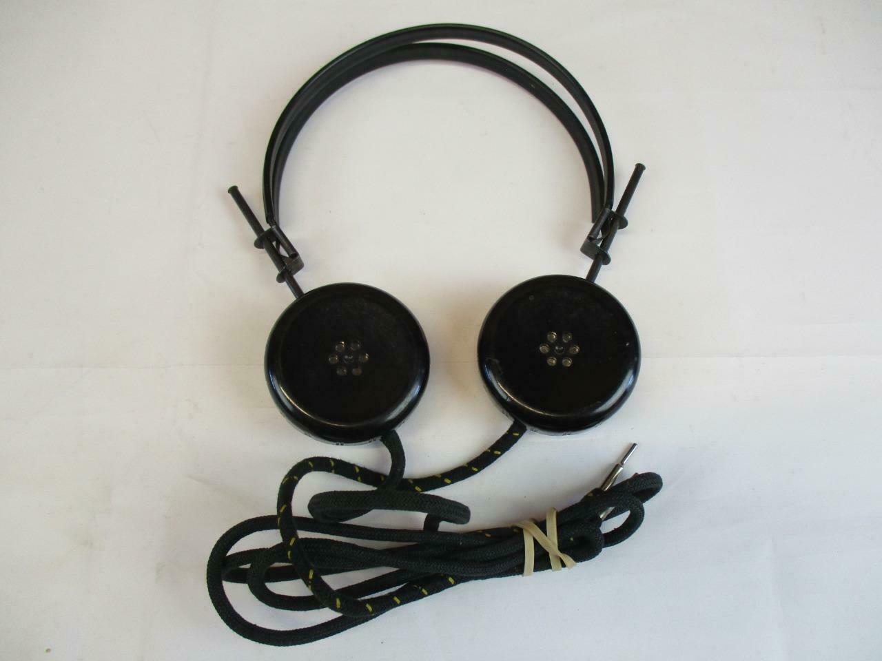

In any case, I nicked Dad's WW-II headphones for my earliest radio experience... not a cat whisker... but an actual 1N34 germanium diode, a hand-wound coil on a toilet paper tube and a variable capacitor I found in Dad's parts stash. I also nicked a roll of wire and strung about 50 feet out the window to a tree in the back yard for an antenna. The headphones were 2000 ohm impedance and quite sensitive. it was trivial to pick up The Asbury Park Press AM radio station, which was less than 10 miles away... and I'm pretty certain they were pushing over 25KW back then.
This is about as close a pic to what I was using in the 60's to listen to anything I could tune in.
