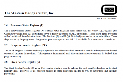

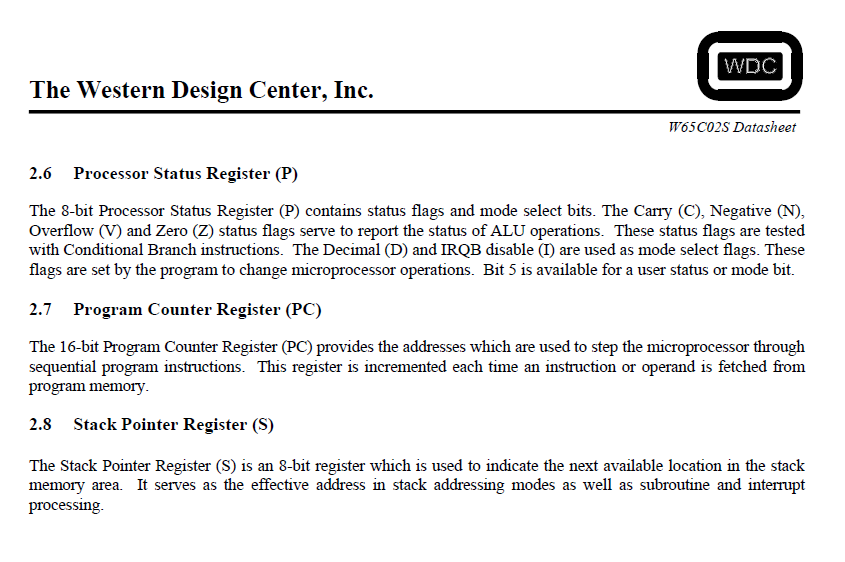

3. Register Naming
There was some debate eariler about register naming.
I've very much with Ed on this:
- use S for the Stack Pointer (as in TXS and TSX)
- use P for the Process Status Register (as in PHP and PLP)
Western Design Centre would seem to agree with this:
I'll certainly be using your document as a handy reference.
