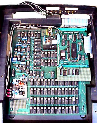

I was looking at pics online of various machines and noticed that this AIM-65 has a FDC-1 installed Image interesting...
Thanks again for the help!
