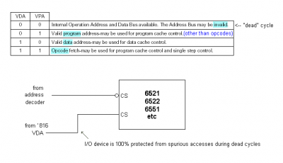

PostPosted: Mon May 31, 2021 1:23 am
VDA alone does not indicate if the 816 is in a dead cycle.
Yes, we agree on that point. As well as during dead cycles, VDA is also low during program fetches other than opcodes fetches. In other words, VDA being low is ambiguous. It could mean either a dead cycle or a Program Fetch Other than an Opcode fetch. (In case anyone needs a reminder, every 65xx instruction includes one opcode byte and zero or more PFOO's, aka operand bytes. And, the 816's VPA/VDA signals vary according to four categories of bus cycle I'll call opcode fetch, PFOO fetch, data fetch/store, and dead cycle. )
Now here's the thing. VDA being low is ambiguous. But for an IO device, the ambiguity doesn't matter. I suggested the glue logic should require VDA high in order for the IO device to become selected, and that means dead cycles will result in de-selection, just as we require. De-selection will also result from PFOO's... but this is not a problem! The ambiguity doesn't matter as long as we're dealing with IO devices only.
I think the confusion arises when the go/no-go signal is applied at a point (such as a decoder) which controls both IO and memory... and I believe your POC's fit this description. Now you do need a go/no-go signal which identifies dead cycles unambiguously. A moment ago I said it's alright for IO to be de-selected during PFOO's, but the same isn't true for memory! And if IO and memory are both subject to a single go/no-go signal, then the logic generating that signal does need to consider both VPA and VDA. So we agree on that, too.
But with different design decisions the circumstances become more relaxed. If the go/no-go signal is applied at a point which only controls IO then VPA can be ignored, and that makes things faster and simpler. For example, 65xx peripheral chips can be effectively protected, with no extra gates and no added propagation delay, simply by driving their active-high Chip Selects with VDA.

As Jeff noted, it all depends on how you are decoding addresses. In my POC units, VDA and VPA are ORed to produce a single high-true signal (VADR) that tells the glue logic the 65C816 is emitting a valid address. The prop delay for that gate is small, under 8ns, worst-case. I got POC V1.2 running in a stable fashion at 20MHz with wait-stating, and POC V1.1 running at 14 MHz without wait-stating, so it could be concluded the slight lag before VADR goes true once the 816 is emitting a valid address is not a concern.
I found it convenient in my designs to go this route. As Jeff notes, there are other ways to do it. That said, I don't believe the prop time of a single OR gate is an issue at any speed at which the 65C816 will be usable. WDC says in the data sheet that all memory and I/O accesses should be qualified by VDA and VPA. I'm merely doing what they recommend.
One thing Jeff and I definitely agree on is the need to qualify I/O accesses with at least VDA. As I previously noted, not accounting for VDA and VPA in glue logic design will result in a system whose bus behavior is like that of the NMOS 6502, which can give rise to difficult-to-diagnose hardware maladies.
