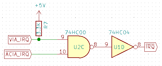

Can somebody tell me what is wrong with this? VIA_IRQ is from a WD65C22 (S variant), ACIA_IRQ is from an MC68B50P and IRQ is connected to the WD65C02's interrupt pin. If I jumper either of the irqs to the output of the inverter then that interrupt goes thru to the processor. As wired, the IRQ line is permanently high. I have replaced both the hc00 and hc04 and metered the traces for continuity all's good but still no worky... I'm at a loss of what else could be wrong with this. Any ideas?
Re: interrupt problem...
If you need a pullup on the VIA IRQ, you might well also need one on the ACIA IRQ. If the point is that these are open-collector, then they need a pullup.
But by the same token, if they are open-collector, they can both be directly connected to the IRQ input, and share a single pullup. The point of open-collector is that the device's output pin is only able to drive low, or not drive at all. Tying two together, with a pullup, makes an AND gate.

Thank you BigEd, from memory I remembered it as being "TTL compatible". Going back to the data-sheet after your reply I saw that it was "TTL compatible, open-drain (no internal pullup)". So I added a 3.3k resistor on the back of the pcb to pin 10 and 5v and now it's working fine.

In the future, please post schematics in monochrome.
The 65C22S has a totem-pole IRQ output, hence does not require a pullup resistor. On the other hand, the 68B50 is open-drain and does require a pullup. Recommended value is 3.3K.
Also, if you use a positive-AND, such as a 74xx08, instead of the NAND followed by the inverter, your circuit will be more responsive to IRQs (two gate delays with your present arrangement vs. one), which may be important with a UART such as the 6850, as it has no FIFOs.

Thanks for the advice BDD, but I had a spare 74hc00 gate available and there's no room on the pcb for another 14pin dip. I'm not that concerned about the 2-gate delay, the board is running at only 2Mhz and after look at some of the interrupt priority circuits out there a 2-gate delay looks to be nothing in comparison to some.

How about using two diodes and a resistor to form a diode gate, instead of 74xx gates? Timing parameters are not important in this case - CPU cycle is an order of magnitude longer than any gate delays.

A standard silicon diode (e.g., 1N4152) should not be used due to its forward drop.  A small-signal Schottky should be used. Only the 65C22's IRQ output would have to be so isolated.
