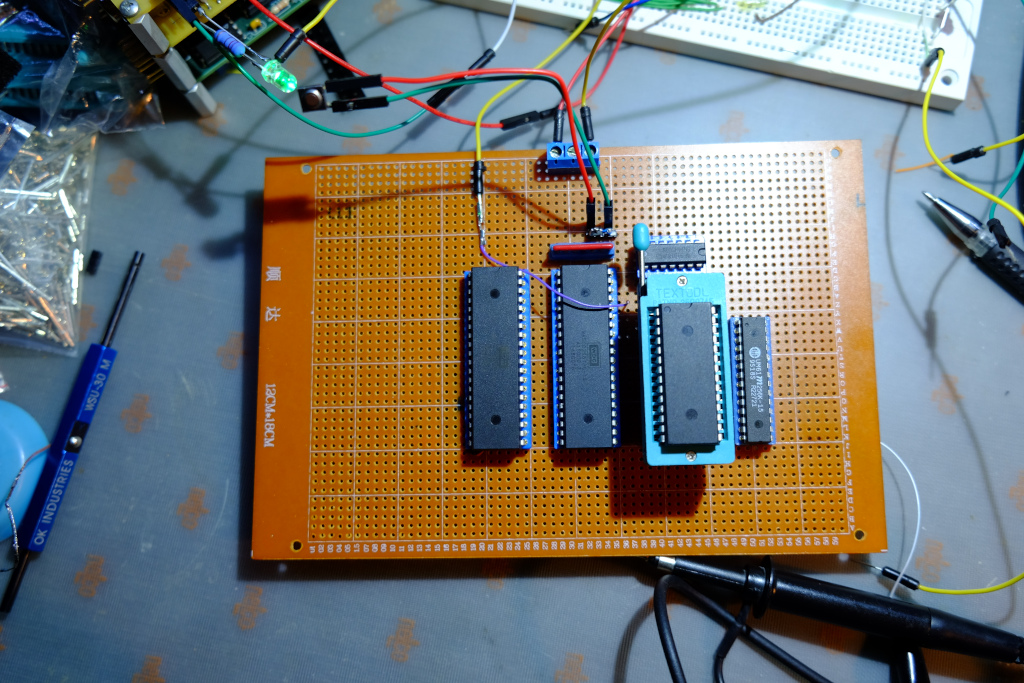

After 3D-printing a few wire-wrap sockets (viewtopic.php?f=4&t=2029&p=83239#p83238), I was itching to put them to use. I always wanted to wire-wrap a computer - it seems like relaxing activity much like knitting... And I've never put together a real '02 computer, only FPGA-based, which somehow does not feel real. That's two marks on my bucket list.
The new computer is a subset of Garth's http://wilsonminesco.com/6502primer/pot ... ml#BAS_CPU (misappropriated by Mr. Eater of googletube), and the board was dubbed GARTH-1. Thank you, Garth, for a solid, simple design - and the rest of the primer! Since I lose everything I ever write down sooner or later, I am posting some details, as much for my future self as for anyone interested:

The cheap Chinese ZIF socket works like a charm, but unfortunately, instead of pins, has weird flat tabs that run like this:
l l l l
l l l l
They don't fit into sockets. I finally found a female header that took them, so the structure is now 3-stories high. But it works.

I don't have a proper clock yet as all my oscillators seem to be in the tens of MHz from my FPGA days. In the meantime I've been using an Daryl's SBC4 to bang out the clock for its little brother (the LED you see is actually the clock, with a little wire to clock GARTH-1). I am running tests at around 500KHz.
Build notes:
Overall, the build took a day and a half (largely due to my disorganized space and time wasted looking for various chips and caps...). Wire-wrapping is not quite like knitting as you really have to pay attention to each individual connection, by the way. But very pleasant, and oh so retro, especially with appropriate period music. I finally got to use the little roll of Kynar wire I bought as a teenager and managed to not get rid of, somehow.
I started with the CPU and a NOP-generator stuck into the RAM socket. After banging on the knobs of my broken Kukusui 20MHz scope (the traces seem to move up and down on their own, and break up into spectacular patterns, not very helpful in debugging) I figured that it probably works. I added a ROM and loaded a simple dead loop at $FF00, which let me check the address bus lines. I then added the RAM, and burned a ROM with a simple test that JSRs into the RAM which promptly RTSs to the stable dead loop at $FF00 for verification.
Finally I added what I thought was the 6522 (but was a 6521!), and wasted half a day debugging every component, removing everything and going back to the NOP generator... Eventually I slapped my forehead and put a real 6522 in, and blinked some LEDs.
