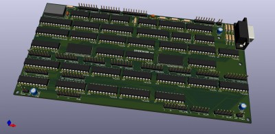

Here is a render of the PCB made with KiCAD
now waiting for the PCB to arrive
PostPosted: Thu May 20, 2021 1:19 pm
Posts: 10838
Fingers crossed! (A couple of unsolicited observations: I don't see any per-chip bypass caps, and I see several 8-way connectors which might ideally have had a couple of ground wires too.)

Posts: 60
I plan to put the capacitors on the back. Also that's a "Rev 0" that I want to develop further down the road. The corresponding connectors on the computer will need ground wires too, one more thing I need to improve :)

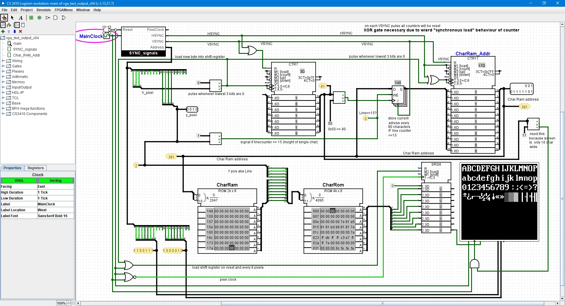

Now that 640x480 graphics are displaying nicely I'm working on getting Text display to work. 640x480 maps to 80x30 screen with a 8x16 font. So my first step was a small program to convert the VGA font from the bdf file into a complete pixel map usable in a ROM (see "create_fontrom.py" in the attached zip file).
The big problem from my perspective was the question how to map 2400 byte of char ram (one byte per character) to the 640x480 pixels on the screen. I came up with a scheme with 3 counters and a register. The register would load at the end of a character line the current address of the 0-2399 counter, so that the next 16 scan lines can start of the correct pointer.
From the already working graph part we take these inputs:
    HSYNC
    VSYNC
    Pixel Clock
    10 bit X address
    9 bit Y address
The basic ideas of this scheme are:
    A VSYNC pulse resets all counters and registers, because we are starting a new page
    The lowest 3 bit of the X-Address (B) are fed into a comparator (C). Each character is 8 pixel wide, whenever all bits are 0 we increase the "Char Counter D" (characters in a line) as well as the overall "Ram Address counter E".
    The "Char Counter D" is reset both on VSYNC as well as HSYNC (aka resets both at the start of a new page and at the end of a line).
    The lowest 4 bit of the Y-Address (G) are fed into the "Line Counter H". Whenever The lowest 4 bit of the Y-Address (G) are all set (=0xf), we've reached the last scan line.
    If "Char Counter D" equals 80, and "Line Counter H" equals 15, we have displayed all 16 scan lines of a single line of characters. At that point the "Register L" is loaded with the current value of "Counter Ram Address E".
    "Register L" will also be loaded into "Counter Ram Address E" with each HSYNC pulse at the end of a scan line.
    After a VSYNC signal "Register L" will be 0. After 16 scan lines the register will contain 80, after 32 scan lines it will hold 160, and so on.
    The 8 bit output from "Counter Ram Address E" are combined with the lowest 4 bits from the "Y Address G" to form an 12 bit address in the "Character Rom I". The output from the Rom is loaded at the start of a character into an "8 bit shift register J".
    With each Pixel Clock one bit of the "shift register J" is shifted out and contains the bit information for each pixel on the screen.
I've simulated the whole scheme using Logisim evolution
The actual Logisim circuit is attached in the zip file.
vga_text_output_v04.zip [12.24 KiB]
Downloaded 35 times
