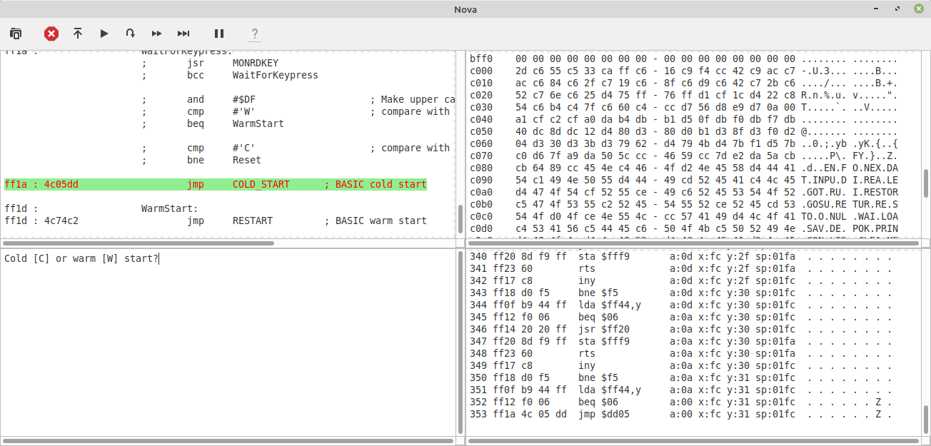

Morning all,
First - many thanks to Klaus for the test suite, which I successfully pass with my C emulator/debugger in both a linux terminal version and a GTK graphical debugger.
It runs around 60,000,000 6502 instructions to completion (I halt on an instruction which jumps to itself i.e. the finish trap) on this old laptop in about 1.2 seconds for the emulator alone, about five minutes with the debug trace running in a terminal, and about three hours for the GTK trace... there's a lot going on there :)
But on attempting to run Grant Searle's version of MS Basic, modified to compile with Frank Kingswood's assembler (and probably introducing all sorts of exciting new bugs) I did discover one issue with my emulator:
stx 0x88
was actually writing to 0xff88 (a casting error in my emulator). Slightly confusing because this was not picked up by the test suite. Does this count as a genuine, for real, bug? Do I get a lollipop? From the way my emulator is written, the same fault would have applied to any zero page read or write instruction (though not the indexed ZPs) if the target address was 0x80 or higher; it's just that I noticed it when the first STX instruction in the basic code didn't write where I expected it to.
p.s. my emulator has fixed that addressing mode, but the basic still doesn't quite run!

PostPosted: Wed Dec 23, 2020 12:52 pm
Posts: 983
30,000,000 vs 60,000,000 - it's quite possible that my code is counting cycles both on the emulation *and* on the debug report. It's still early days... I need to look further into whether the memory bounds test will detect out-of-area read/writes in the case that a broken addressing mode is causing the issue.
I need to drop this for other projects for a while, but it'll bubble back up to the top pretty soon I guess.
For what it's worth, a linux GTK debugging system with full debugging written to a pane and with the listing leaping around as the program counter changes runs to a touch under 3,000 instructions per second on this old laptop :)
