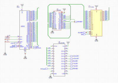

I've been redoing my memory map and decided to use a GAL for decoding, wrote up the CUPL code, programmed the GAL, hooked up some DIPs and LEDs and it works as expected. (GAL20V8B)
What's odd is when I have the GAL in place, system won't start. Logic analyzer shows OE and CE on the ROM (28C65BP getting pulled low) and address lines show FFFC, FFFD, then some random addresses, loops up to FFFE and FFFF, the back to random addresses again. If I take the GAL out of the way and just pull OE and CE on the ROM (28C65BP) to GND it works fine, so I know the issue is with the GAL being in place. I hooked the GAL output to my scope and see that it's definitely pulling them below the TTL logic low (165mV)
I'm just at a loss as to what this could be, I tried switch out for another GAL, making sure all of the unused inputs/outputs were pulled to VCC, and nothing seem to be working. I'm 100% sure it's something silly but I've been diving into this too long and need another set of eyes. This is my first time working with GALs, so I'm hoping it's a PEBKAC situation.

PostPosted: Sat Apr 17, 2021 8:15 pm
system won't start
Does the GAL have any relevance to the CPU's /RST /NMI and /IRQ inputs? Please tell us about the system, starting with a schematic or at least a block diagram, and ideally including some photos as well. (Reminder: on this forum you're allowed to attach images with your posts.)

So, I figured it out! In my effort to take some photos of the analyzer and show the difference between when it works and doesn't I noticed something peculiar that I was ignoring, but shouldn't have been.
When it *worked* with CE and OE grounded, I saw this on the anaylzer:
ADDR      DATA      ROMEN
FFFC        00          0
FFFD        00          0      <--- this should be E0
0000        A9          0      <--- But the code is at E0, not 00.... wait a minute....
0001        12          0
0002        4C          0
0003        00          0
0004        E0          0
E000        A9          0      <--- The code is at E0 too!
E001        12          0
E002        4C          0
E003        00          0
E004        E0          0
This made me realize that with CE and OE pulled to ground, the ROM (E000-FFFF) was effectively mirrored every 2K across the entire address space. When the system was starting up, it was getting 0000 instead of E000, but since the ROM was mirrored into 0000-1FFF it worked fine, then got to the branch sending it to E000 and it went right there. I was measuring the address lines at the CPU, not at the ROM. I moved them to the ROM and discovered that A12 was always showing low. Quick continuity check and realized I had A12 tied to pin 21 and not 22 on the CPU <doh!> Problem solved!
I knew it was something silly, thanks for driving me to take the second look.
PostPosted: Sat Apr 17, 2021 9:10 pm
Glad you've been successful! :)
As an aside, I'm tempted to remark that Logic Analyzers are a little too tempting -- a powerful tool, yes, but rather inefficient when all you have is a "head smack" type of problem. Anyway, live and learn.
BTW your schematic needs updating. I hardly think the machine would function with RDY pulled *low*. :roll: Cheers!
