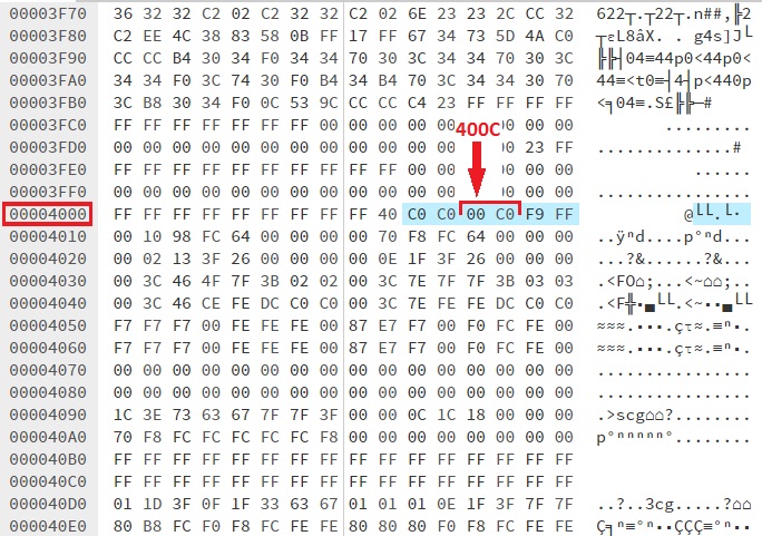

PostPosted: Tue May 11, 2021 12:31 pm
Posts: 10977
If the disassembler tells you that the program code begins at C000, it's because it is smart enough to read the two bytes at FFFC.
In the *.nes file, the 16 byte header is followed directly by the 16k PRG ROM, and you'll see towards the end of that 16k ROM the bytes
ffff ffff ffff ffff ff40 c0c0 00c0 f9ff
wherein you'll see the three vectors in this case: FFF9, C000, C0C0.
PostPosted: Tue May 11, 2021 1:35 pm
Posts: 336
The header of that file is
4E 45 53 1A 01 01 01 00 00 00 00 00 00 00 00 00
The first 4 bytes tell us that it's either iNES or NES2.0 format. Which one doesn't really matter in this case, as NES2.0 is backwards compatible, and this file doesn't use any of its extended features. I'll assume iNES because it's simpler.
The next two bytes are $01 and $01, which mean 16K PRG ROM and 8K CHR ROM. The mapper number is scattered through a few of the other bytes, which are all 0, so it's mapper 0.
The next 16K ($0010 - $400F) is PRG ROM. That appears in the 6502's memory space at locations $8000-$BFFF and also at $C000-$FFFF (because that's what mapper 0 does with 16K ROMs). It looks like the copy at $8000-$BFFF isn't used, but it'll still be there.
On power-up the 6502 reads the interrupt vector at $FFFC and starts execution at the address it points to. $FFFC is at $400C in the file, and those two bytes are 00 C0. So we expect to see code at $C000 in the 6502's memory space, which is $0010 in the file. At those locations we see 4C 94 C0, which is JMP $C094. And at $C094 ($00A4 in the file) we get A2 FF 9A A9 00 ..., which translates to
LDX #$FF
TSX
LDA #$00
which is the sort of thing you'd expect reset code to do.

PostPosted: Tue May 11, 2021 3:53 pm
Joined: Thu May 06, 2021 7:07 pm
Posts: 14
I found it when I viewed the nes file in hex viewer , exactly as you have mentioned.
