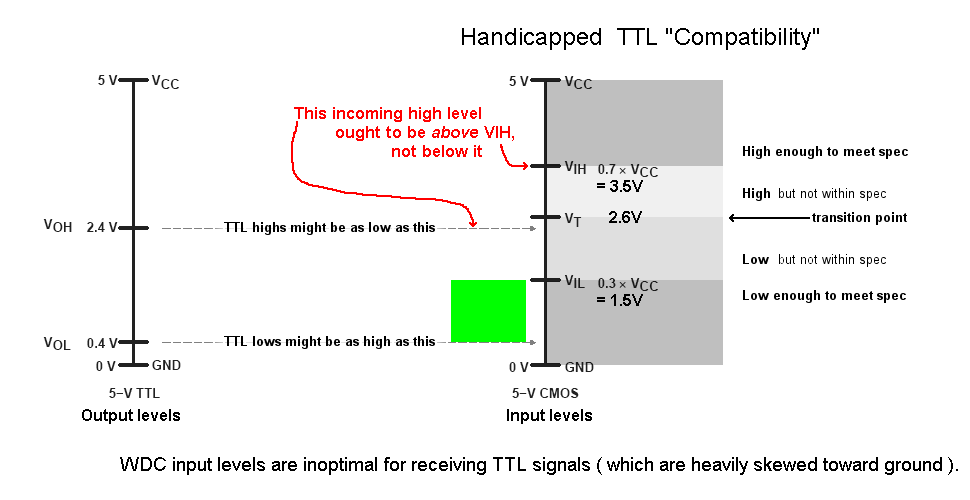

Thank you, all, for the replies. The topic has drifted somewhat, which is partly my own fault due to lack of proper emphasis in the lead post. :oops:
The term "TTL compatible" appears occasionally on this forum, and readers (especially newbies) may gather that it has a single, unambiguous meaning. But there are two tiers of "TTL compatibility," and they differ markedly.
That is my key point -- two tiers. We have what I would call genuine TTL compatibility, which any engineer would prefer due to its maximal noise immunity. The second tier is what I'd call "hope it works" TTL compatibility -- and very often it does work (as I was careful to mention in the lead post, and others have echoed that).
But let's not confuse the two tiers:
File comment: handicapped TTL compatibility
There are also two tiers when we say a certain combination "will work." We need to remember that the TTL-to-WDC combination is far more prone to stop working in noisy circumstances. Those include proximity to external noise, of course, but other important factors include supply noise, crosstalk and inoptimal construction techniques.
The lower of the two attached diagrams shows that the TTL-to-WDC combination actually has negative noise immunity when conveying a 2.4V logic high. Luckily, the shortfall is small when comparing 2.4V with the input transition point, VT. Especially without DC loading, the VOH of most TTL-output devices is likely to exceed the TTL spec of 2.4V... at least sufficiently to bring it slightly above the transition point, and this explains why success is often reported.
But operating near the transition point involves tradeoffs. Poorer noise immunity is the obvious factor, but operating near VT may also increase data setup times, thus degrading the maximum operating speed. :!:
WDC publishes the VIH spec for a reason, and really you want the incoming logic-high level to be at or above VIH. Although VT is only slightly above 2.4V, the shortfall from 2.4V to VIH is not trivial. I suspect there aren't many TTL-output devices which overperform to this extent. This means noise immunity is likely to be compromised, and perhaps maximum clock frequency as well.
I don't feel this unhappy situation deserves to be called TTL compatibility! It is a second-tier solution, not to be confused with the optimal compatibility an engineer would prefer.
Note: my limited testing of 65xx CPU's can't be used to predict the transition voltage for all extant specimens. Also, the subject of TTL Compatibility involves current as well as voltage, and outputs as well as inputs. But I have focused only on the voltages accepted by CPU inputs because that's by far the most controversial and problematic aspect.

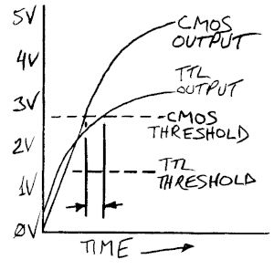

Besides thresholds, I imagine there's a difference in timing, which I'll illustrate this way:
Note that in this case, the TTL output reaches the TTL threshold before the CMOS output reaches the CMOS threshold, so the TTL part may appear faster; but when it has to drive a CMOS input, it takes it longer to reach the CMOS threshold than the CMOS output takes, because its drive strength is lost before it has charged the bus capacitance up to a high-enough voltage.
This excludes considerations for groundbounce which may make things worse, shifting the input reference level.

Bill, what I'm thinking of is not the DC drive, but charging the bus capacitance. 400µA charging 50pF only slews at 8mV/ns, meaning 400µA takes 125ns to charge up the 50pF load a single volt. As the TTL-output part starts its trip up from .4V to the higher voltage, it will initially go faster for the first couple of volts because the drive strength is greater; but then it slows way down before it has finished the job of bringing the voltage to a dependable CMOS logic '1'. But yeah, the spec sheets often leave out information we wish they would include, rather than assuming in this case what our intended load is. So although it may work up to some speed, finding the real boundaries requires us to do some very detailed testing which probably none of us has the equipment to do.
PostPosted: Tue Jul 05, 2022 7:49 pm
Posts: 1007
Gotcha.
But I'm really not condoning using TTL in CMOS environments. What I'm really trying to say is those CMOS RAM, ROM and PLD devices we use (and only get TTL load specs for) will do fine in CMOS environments and we need to stop taking those TTL environment specs so seriously because that is just no longer the reality.
