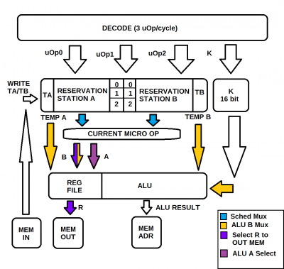

Design:
- Highly regular encoding scheme with 16 bit/32 bit
- 2 State front-end pipeline + 3 stage back end pipeline of fragmented operations (uOP, to say)
- Yes, it is a complex design. In fact i completed the first version of the internal micro core. That i will need to modify further to implement ROR/ROL/DEP/ADC/SBC.
"Completed" here is a placeholder for "Logic Gates for the full implementation are there, but there is no tests yet".
- Logic gates simulation first. Because i am bad at planning projects.
- IF stage fetch and reorder the instruction.
- ID stage translate 16 bit opcode in 1-3 20 bit uOps.
- SCHED stage pick a ready uOP from one of the Reservation Stations and put it in the Scheduled_Instruction_Register. 80 bits of MUX x2, YAY!. At least that's all the work that this stage need to do.
- ALU stage pick A register and a B register, then it select one from B, K or T (temp storage of the RS) for the second input of ALU. B is always forwarded to Mem. ALU can store the register back to the Register File or write the MAR register to start a memory cycle.
- MEM stage start with the address in the MAR register, it wait for RDY signal and then write to TA or TB (Temp RSA or Temp RSB)

Update:
i completed the Opcode -> micro-Op decoder. Now i am debugging it and debuggin the Back-End too.
I will update my github once i am almost sure it works, at least for the testbench (testbench being a memcopy implementation).
I also re-read my intro for this topic. I feel i can read it because i am the designer, but it isn't very clear to anyone else.
Just to be sure, i will dive a little more in the details, beginning with the Back End.

Hello all,
i will be short, because is late.
I leave you with a diagram drawn by myself, the inevitable nightmares you will face after looking at the diagram, and finally a promise of a better explanation of my back end design.
File comment: Back End diagram
