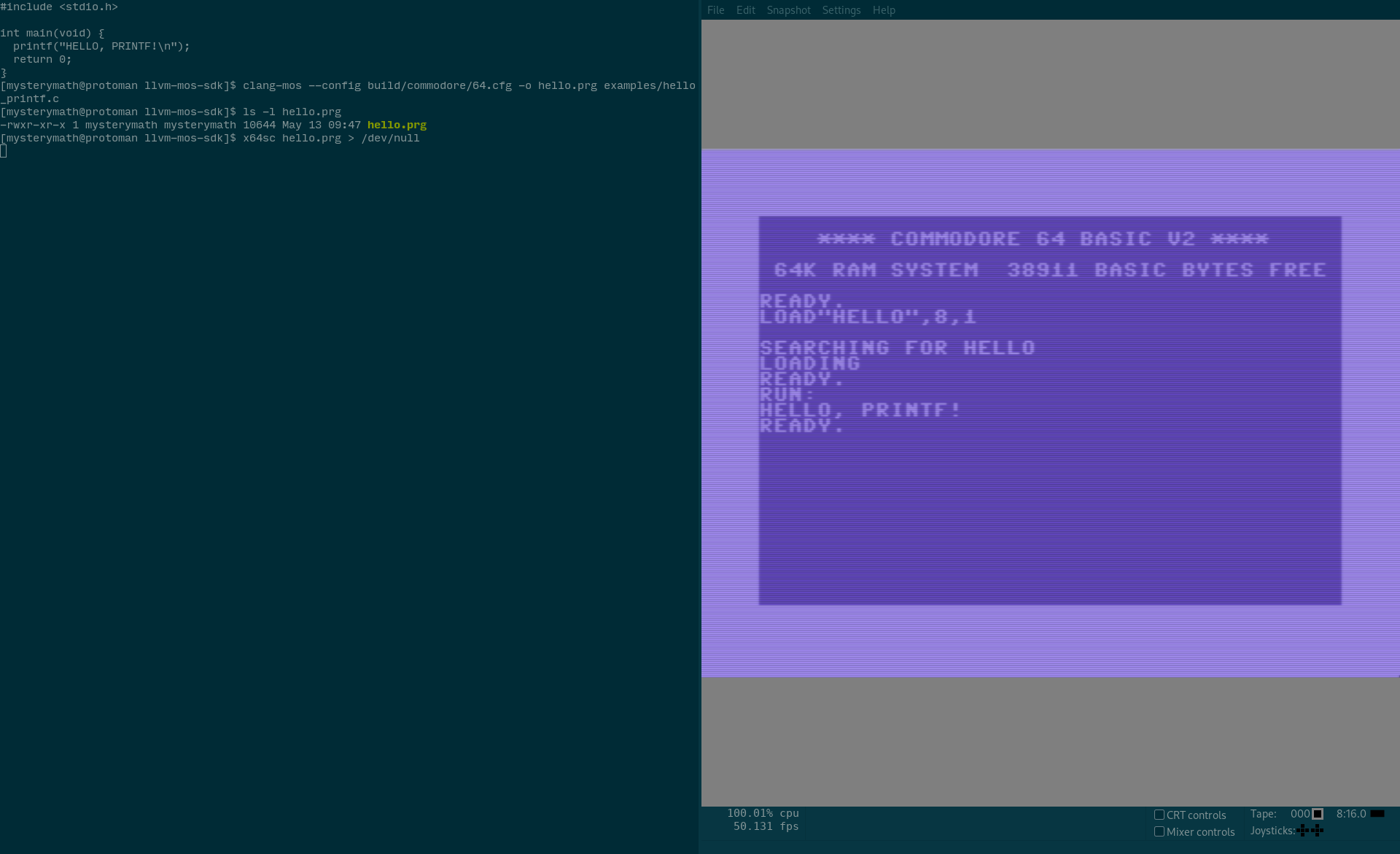

Alright, after implementing simple routines for integer division, multiplication, and modulus and a simple memset, and fixing a half dozen more compiler bugs, a hello_world.c using printf can now make it all the way through the compiler.
It worked on the first try!
Trying printf("HELLO, %s\n", "WORLD") produced "HELLO, <heart>", of course. So now we begin the process of getting printf to actually work.
The whole thing is just under 11KB of terrible, terrible code. I particularly like how it does multibyte equality comparisons by EORing the all the bytes together. Oh and how it uses an extremely long sequence of branches, immediate loads, and an EOR to XOR N and V together for the signed comparison result. Reeeeeeal nice. :)
It's very difficult to resist the temptation to go in and fix all of this right now, but there's bigger fish to fry.
I've attached an assembly-language version of the output, in case anyone is sufficiently masochistic to wade through it.

That's some serious generated assembly code indeed, wow!
Are the sources of hello.c and printf.c viewable somewhere from which it was generated?

Yep, everything's in our SDK: https://github.com/llvm-mos/llvm-mos-sdk
The printf code and libcalls are under common/lib/.
You can see the hello_world.c I'm using in the left hand pane of the screenshot, it's just "printf("HELLO, WORLD");".
