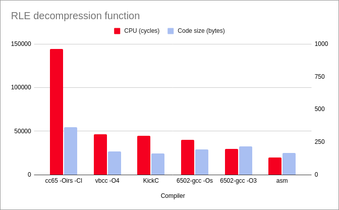

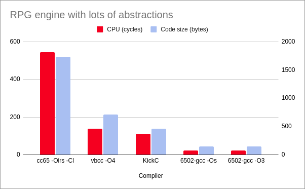

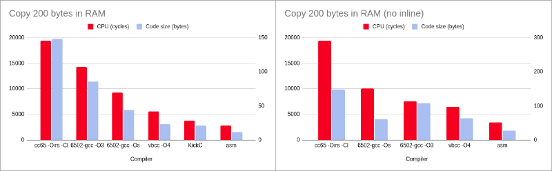

I would really like for someone to improve upon cc65. As it is, it generates horribly inefficient code. Anyone with any experience at all can do much better in assembly.
I just came across this page about benchmarking the various C compilers for the 6502. CC65 produced much slower, more bloated code than the other C options, although it was more solid.

I saw that page as well. It succeeds in pointing out the gorilla in the room, which is the 65(c)02 is not a compiler-friendly MPU. The 65C816 is much better suited to C, although still hampered by its paucity of general purpose registers.

Complete nonsense, BDD. I hope you never behave like this in person.
It's a comparison of various aspects of various compilers, shows a lot of care and attention, and is worth a read: title is "Technical highlight: C compilers for 6502 benchmark: A new hope!"
Some images from within:

That wasn't at all what I intended. The article was interesting. I was referring to the 6502 not being a good compiler target.
