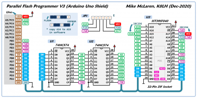

I'm ready to start using them.
I designed an Arduino shield specifically for programming 28C256 EEPROMs and the SST39SF series 128K, 256K, and 512K Flash ROM chips. The Flash ROM chips are very nice and while you can only program them a byte-at-a-time, they only need 14 to 20-usecs to program each byte. I can program each byte within the ~86-usec interval between incoming 115200 baud serial characters.
I'm also thinking about a Programmer / ROM Emulator design which could use either a RAM chip or a Flash ROM chip when in 'Emulator' mode.
