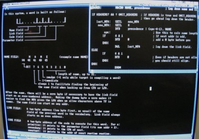

I have the Trident 8900 video chip set on a video card on my DOS machine where I do my software development for the workbench, so I have 132 columns, and I usually choose 43 lines, although if I don't mind them being squished together with less space between them, I can go for 50 or 60 lines. In the picture below, I kept things to 80 columns for someone else; but you can see how much more space the 132 affords. When I write stuff that will be compiled by the workbench computer where I only allotted 128 bytes for TIB on my '02 Forth, I just don't use the last few places on the line. (In my '816 Forth, I made TIB $88, or 136d.) MultiEdit, BTW, lets me have dozens of files open at once, tiled and windowed any number of ways.

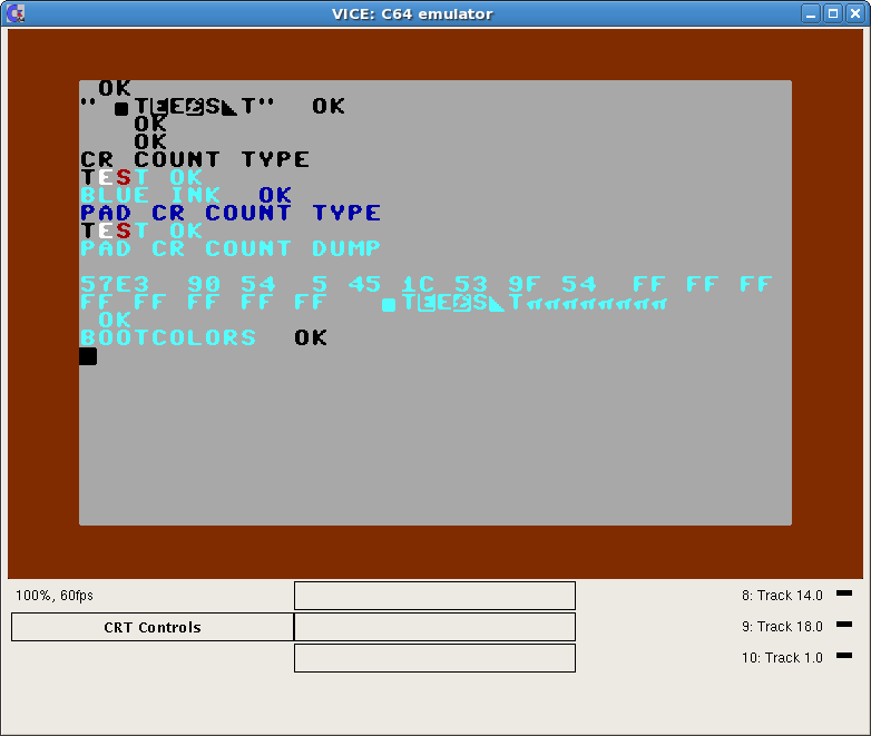

IamRob wrote:
one cannot store Control characters or memory pointers in a text file.
That would depend on the system you are using. The Commodore 64 has what is called quote mode. Control characters can be embedded in a string as this screen shot shows. Note: the word " (quote) parses the text stream until a quote character is found as a delimiter. When used while interpreting, the text is stored as a counted string at PAD .
As can be seen, the control characters to change the text color were captured in the string. If I can save it in a string, I can save it in a file.

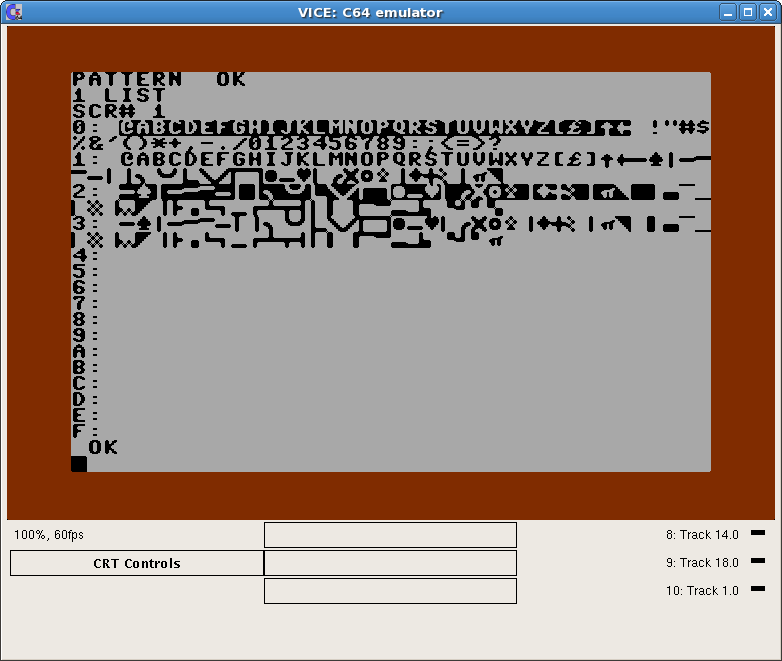

Storing a zero as the first byte of the screen also prevents the screen from being accidentally loaded, but does not affect the screen being displayed, and the LIST command is modified to display Control characters in inverse video.
Oh really?
Here are some excerpts from the log of my latest session at the simulated C64. In the log, everything I entered as well as the computer's responses are shown:
 OK
HEX  OK
1 BUFFER U. CC00  OK
2 BUFFER U. C800  OK
3 BUFFER U. C400  OK
4 BUFFER U. C000  OK
I use BUFFER to assign buffers for blocks 1 thru 4 without reading anything from disk. I remove them later with EMPTY-BUFFERS
1 LIST
SCR# 1
0: @@@@@@@@@@@@@@@@@@@@@@@@@@@@@@@@@@@@@@@@@@@@@@@@@@@@@@@@@@@@@@@@
1: @@@@@@@@@@@@@@@@@@@@@@@@@@@@@@@@@@@@@@@@@@@@@@@@@@@@@@@@@@@@@@@@
2: @@@@@@@@@@@@@@@@@@@@@@@@@@@@@@@@@@@@@@@@@@@@@@@@@@@@@@@@@@@@@@@@
3: @@@@@@@@@@@@@@@@@@@@@@@@@@@@@@@@@@@@@@@@@@@@@@@@@@@@@@@@@@@@@@@@
4: @@@@@@@@@@@@@@@@@@@@@@@@@@@@@@@@@@@@@@@@@@@@@@@@@@@@@@@@@@@@@@@@
5: @@@@@@@@@@@@@@@@@@@@@@@@@@@@@@@@@@@@@@@@@@@@@@@@@@@@@@@@@@@@@@@@
6: @@@@@@@@@@@@@@@@@@@@@@@@@@@@@@@@@@@@@@@@@@@@@@@@@@@@@@@@@@@@@@@@
7: @@@@@@@@@@@@@@@@@@@@@@@@@@@@@@@@@@@@@@@@@@@@@@@@@@@@@@@@@@@@@@@@
8: @@@@@@@@@@@@@@@@@@@@@@@@@@@@@@@@@@@@@@@@@@@@@@@@@@@@@@@@@@@@@@@@
9: @@@@@@@@@@@@@@@@@@@@@@@@@@@@@@@@@@@@@@@@@@@@@@@@@@@@@@@@@@@@@@@@
A: @@@@@@@@@@@@@@@@@@@@@@@@@@@@@@@@@@@@@@@@@@@@@@@@@@@@@@@@@@@@@@@@
B: @@@@@@@@@@@@@@@@@@@@@@@@@@@@@@@@@@@@@@@@@@@@@@@@@@@@@@@@@@@@@@@@
C: @@@@@@@@@@@@@@@@@@@@@@@@@@@@@@@@@@@@@@@@@@@@@@@@@@@@@@@@@@@@@@@@
D: @@@@@@@@@@@@@@@@@@@@@@@@@@@@@@@@@@@@@@@@@@@@@@@@@@@@@@@@@@@@@@@@
E: @@@@@@@@@@@@@@@@@@@@@@@@@@@@@@@@@@@@@@@@@@@@@@@@@@@@@@@@@@@@@@@@
F: @@@@@@@@@@@@@@@@@@@@@@@@@@@@@@@@@@@@@@@@@@@@@@@@@@@@@@@@@@@@@@@@
 OK
WIPE  OK
L
SCR# 1
0:
1:
2:
3:
4:
5:
6:
7:
8:
9:
A:
B:
C:
D:
E:
F:
 OK
When I list block 1, it is full of the null character (byte 0) so I wipe it and list it again.
0 1 BLOCK C!  OK
L
SCR# 1
0: @
1:
2:
3:
4:
5:
6:
7:
8:
9:
A:
B:
C:
D:
E:
F:
 OK
1 LOAD
SCR# 1 LINE# 0
WHAT?
I store a zero at the first byte of block 1 and list. The zero is clearly seen in the listing. When I try loading the block, Fleet Forth aborts with an error. Blazin' Forth for the C64 and Gforth for the PC have similar behaviors.
Fleet Forth's LIST shows all characters in a screen. The only character that shows as whitespace is the blank character ( $20).
Here is a short word to fill block 1 with the bytes 0 to $FF inclusive:
: PATTERN
   $100 0
   DO
      I DUP 1 BLOCK + C!
   LOOP ;
And here is the result of using this word then listing block 1:

And store a zero in the first byte of the block I'm using for this test.
1 RAM LIST
SCR# 8001
0: @
1:
2: CR .S
3:
4:
5:
6:
7:
8:
9:
A:
B:
C:
D:
E:
F:
 OK
1 RAM LOAD  OK
2 1 RAM LINELOAD
EMPTY  OK
As can be seen, the block doesn't load until I use LINELOAD to load the block starting at line 2, skipping the null character.
Having said that, it is not a technique I will use. When I use blocks for data, it is usually for virtual memory. The value in the first bytes of a block used for virtual memory depends on what is written to virtual memory.
